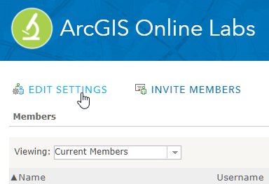

As an Administrator, you will find the the basemap options for your organization by clicking Edit Settings

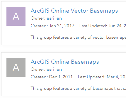

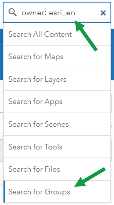

Step 2. Locate the Esri raster basemap group and the Esri vector basemap group. For English users, the groups are owned by esri_en and can be found using group search for owner: esri_en. For French, the owner is esri_fr, and so forth.
Make sure to click off only searching in your organization.
The two basemap groups are named ArcGIS Online Vector Basemaps and ArcGIS Online Basemaps. The latter contains the default raster tile basemap collection.

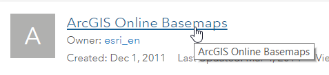

Step 3. Click the ArcGIS Online Basemaps group title to open the group.

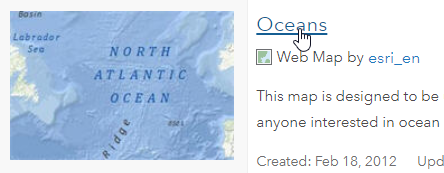

Step 5. Browse the basemaps. When you find one that you’d like to include in your custom basemap group, click the title

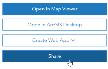

to open the item pages, then click Share

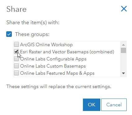

and select the group you will use for your custom basemap gallery, then click Ok.

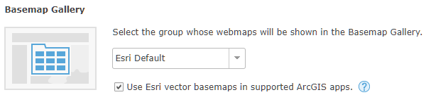

Step 3. In the Basemap Gallery section, choose your basemap group from the dropdown list.
Save changes when done. When authoring a map or scene, the basemaps contained within your custom basemap group will be presented and available to all users in your organization.
