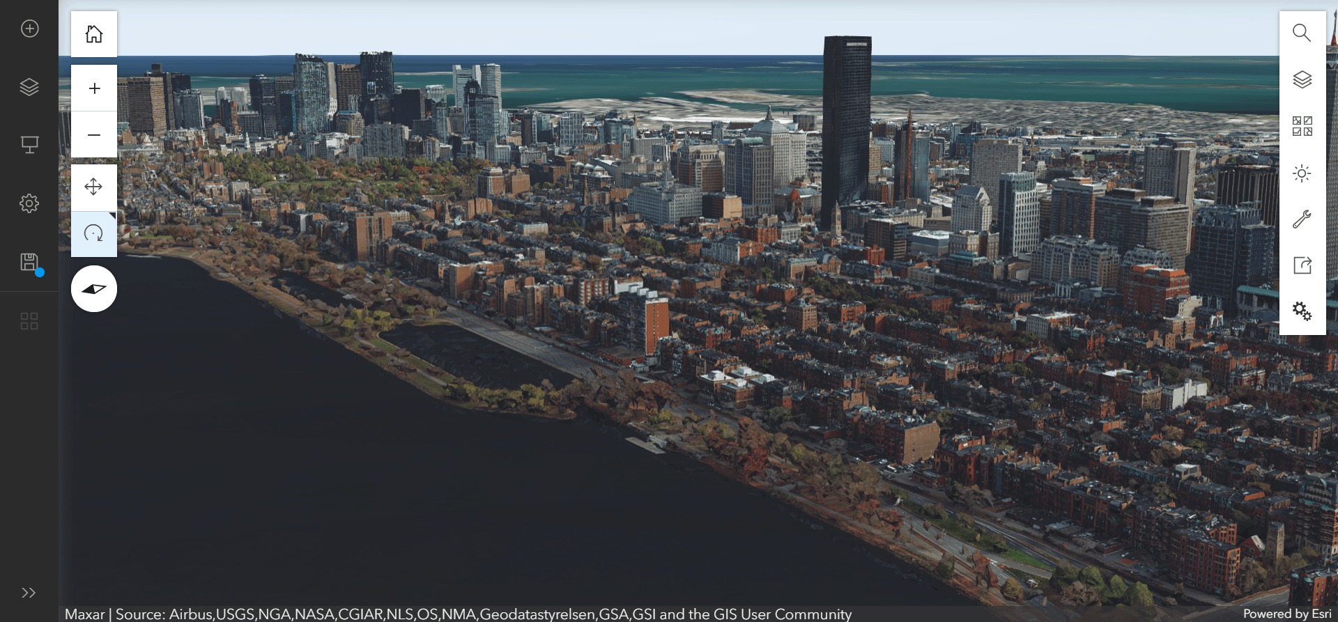

3D tiles layer drawn in Scene Viewer. Source: Bluesky International Ltd – processed with ArcGIS Reality by ESRI.
3D tiles layer drawn in Scene Viewer.. Source: Bluesky International Ltd – processed with ArcGIS Reality by ESRI.
Scene layer drawn in Scene Viewer. Source: Bluesky International Ltd – processed with ArcGIS Reality by ESRI.
You can visualize scene layers (i3s) and 3D tiles layer in ArcGIS applications like ArcGIS Pro, Scene Viewer, ArcGIS Maps SDKs , or other web viewers created with CesiumJS.

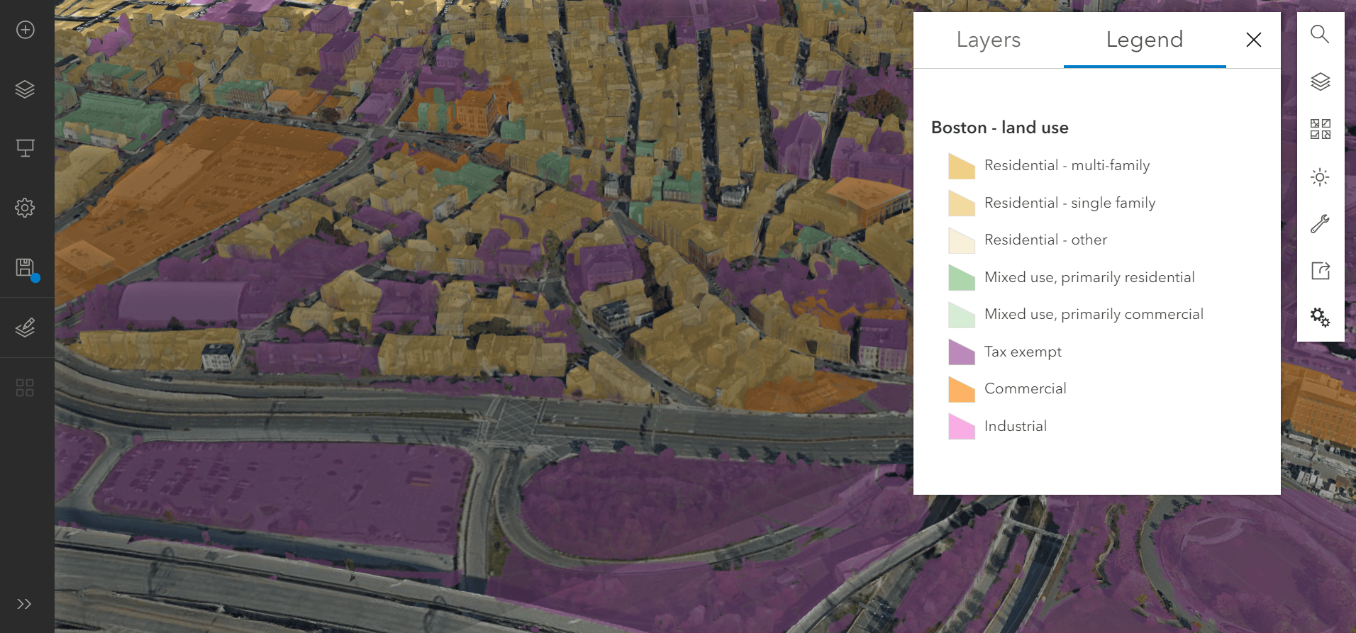

Land use draped on 3D tiles layer.
You can visualize layers with different spatial references in ArcGIS Pro since the layers will be projected on the fly to the spatial reference of the scene. However, other ArcGIS applications like the Scene Viewer require all layers in a scene to have the same spatial reference.

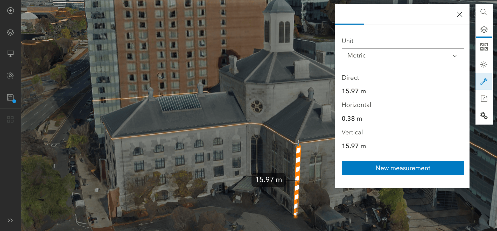

Measure height of a building in Scene Viewer. The absolute height value is in gravity related height. Source: Bluesky International Ltd – processed with ArcGIS Reality by Esri.

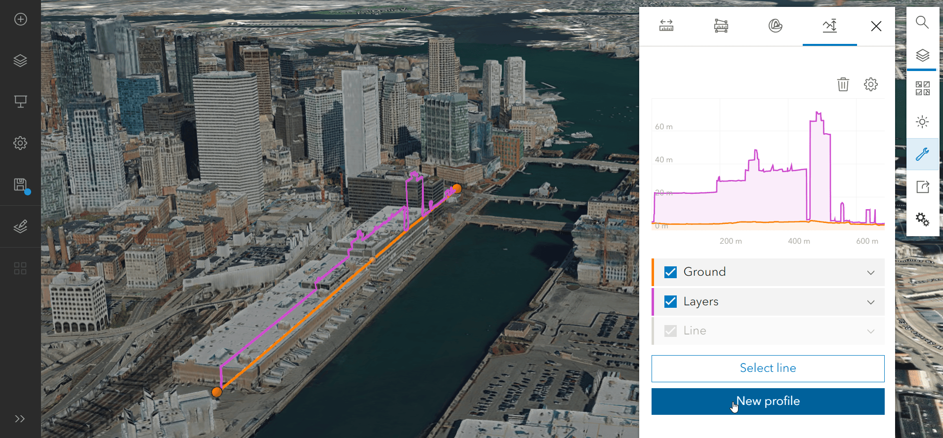

Use the elevation profile tool on a 3D tiles layer. Source: Bluesky International Ltd – processed with ArcGIS Reality by Esri.
Conclusion
You can apply exploratory tools to scene layers (i3s) as well as 3D tiles layers. In addition, when working with scene layers you can use appropriate geoprocessing tools in ArcGIS Pro. For example, project, clip or extract multipatch from mesh.
