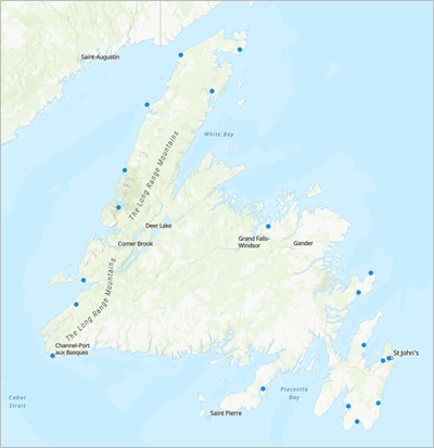

You are a new EV owner on the island of Newfoundland and you want to know where you can go with your new car to ensure you will have access to charging stations.
Map extent centered around the island of Newfoundland

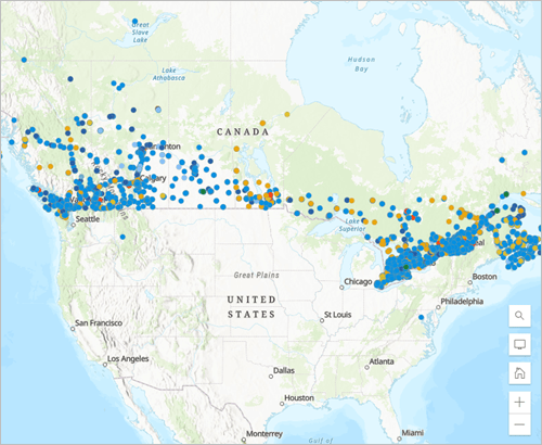

To use the Generate Travel Areas tool, sign into ArcGIS Online with your ArcGIS organizational account and import your data into Map Viewer. For this scenario, I’m importing the Electric Vehicle Charging Stations in Canada layer.
Default map
Default map

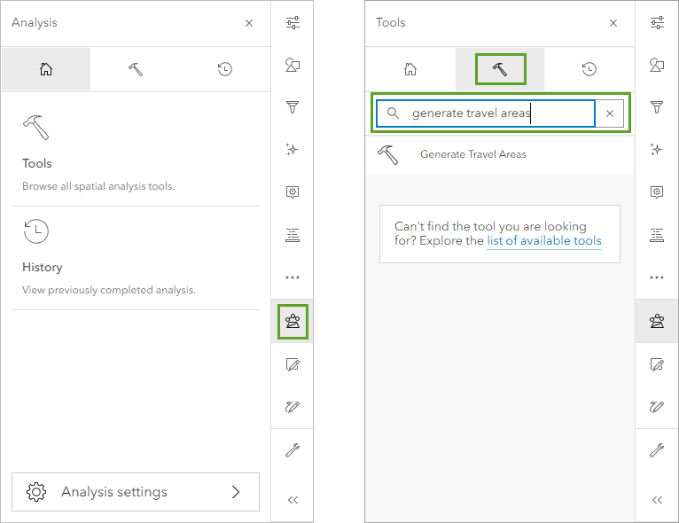

In Map Viewer, on the Settings (light) toolbar, click the Analysis button. Here, you will find many analysis tools that can be used to solve geospatial problems.
Image displaying the analysis button travel area tool and search bar

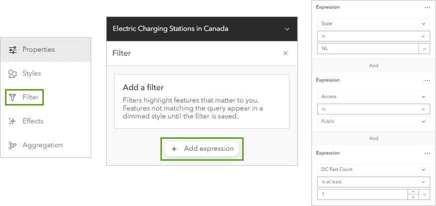

Since we are focusing only on the island of Newfoundland, this large dataset must be filtered to include only the charging stations on the island. We can use the Filter button on the Settings toolbar to accomplish this.
We will make a new expression to filter the charging stations to include the ones we are interested in. In this case, we are interested in the stations that are in the Newfoundland + Labrador state, that are publicly accessible, and are in the fast-charging category.
Adding a filter to the layer

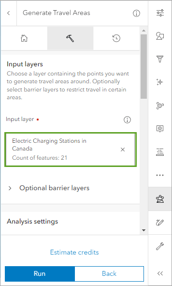

Now that the data is filtered to our specific needs, we can run the generate travel areas tool to show a map of our EV’s range. We want to know where our car can drive on the island to plan our drives properly. We will open the tool and use Electric Vehicle Charging Stations in Canada as the input layer.
Electric charging stations count

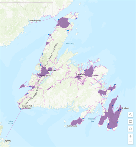

Once you run the tool based on the previously filtered charging stations and range of your EV, it will generate the travel areas on the map. These areas represent the regions where the EV can reach from its starting point (the charging stations) while staying within the range. In our case, the EV has a range of 160 kilometers.
Final map showing travel areas
The large purple swathes represent areas that are entirely accessible by your EV with a 160-kilometer range. This is an interesting result because with this range, people on the western side of the island can’t access the eastern side, and vice versa. Now you have created a map of the area in which you might be traveling. You can see where it is possible to go and where it is not – plan accordingly!
