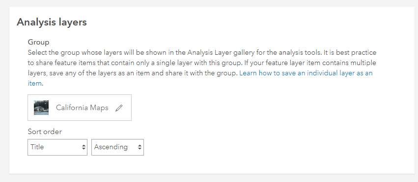

There are also times when you may want to have your own analysis layers collection. For example, there may be a set of layers that are commonly used in your organization. Did you know that organizations can configure their own analysis gallery in ArcGIS Online? The option is available for an administrator with ArcGIS Online Configure Map settings. You can choose a group with the layers you want to use in the Analysis layers gallery.

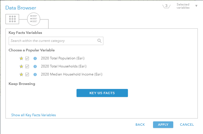

Enrich Layer is an extremely powerful analysis capability in ArcGIS Online that allows you to join your existing data with Esri’s authoritative datasets. For those of you who routinely use Enrich Layer with the same variables, did you know that you can create a “favorites” list for the variables you use most often?
You can add a variable to the “favorites” list simply by clicking the star next to a variable name in the data browser. Then you can access the favorites by clicking Show Favorite Variables on the menu page of the Data Browser dialog box.

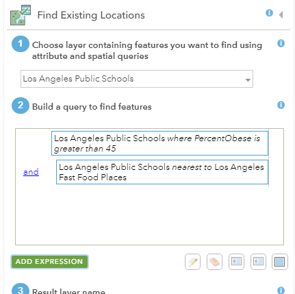

  1. The “Nearest To” Option in Find Locations
Most of you are already familiar with the Find Existing Locations and Derive New Locations tools which allow you to query both spatial and nonspatial attributes in your data. The tools support most of the common spatial queries such as “Intersect”, “With a Distance of”, or “Completely Contain” etc. However, I bet many of you did not know the “Nearest to” option in Find Locations. This type of spatial query becomes very useful in a use case like this: find all the schools with an obesity rate higher than 45% which are also nearest to fast food restaurants.

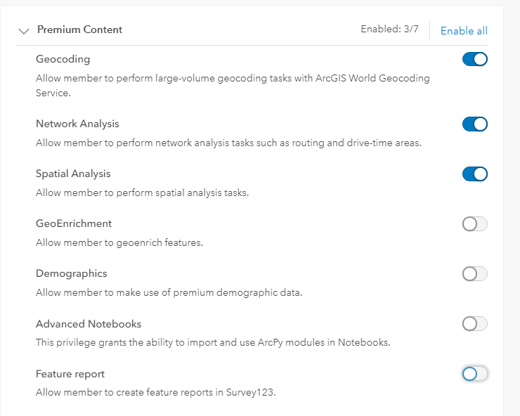

  1. You can control who can use spatial analysis tools and limit the number of credits
Let’s face it. We have all heard administrators complaining about users in their organizations accidently running large jobs and burning too many credits. It is also true that not all members in your organization need to have access to all the analysis tools.
The good news is that administrators can create custom roles for members, including privileges to access tools they need to use and to restrict access to tools they do not need. For example, a member may be assigned with a privilege to use Spatial Analysis tools but not to use the Enrich Layer tool.
In addition, administrators can use credit budgeting to set a limit of credits that a member can use. This approach sets the maximum amount of credits a user can spend on a single job. For example, if a member wants to run Enrich Layer on all the ZIP Codes in the United States with 10 variables (4200 credits) but only has a budget of 100 credits, the member would receive an error message preventing this from being submitted. (Learn more about managing credits consumed by analysis tools from this blog article)
