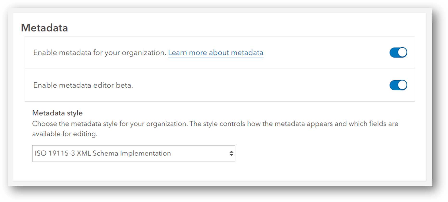

Enable the metadata editor beta
For organizations that have enabled metadata editing, the Metadata and Open in Metadata Editor Beta button are available to item owners and administrators to create and edit metadata.
Note the ISO 19115-3 XML Schema Implementation metadata style is also part of the summer release for use with the metadata editor beta.

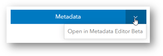

In the ArcGIS Online organization, go to the Contents tab and open an existing item. In the item details page, click the drop-down on the Metadata button to open the metadata editor beta.

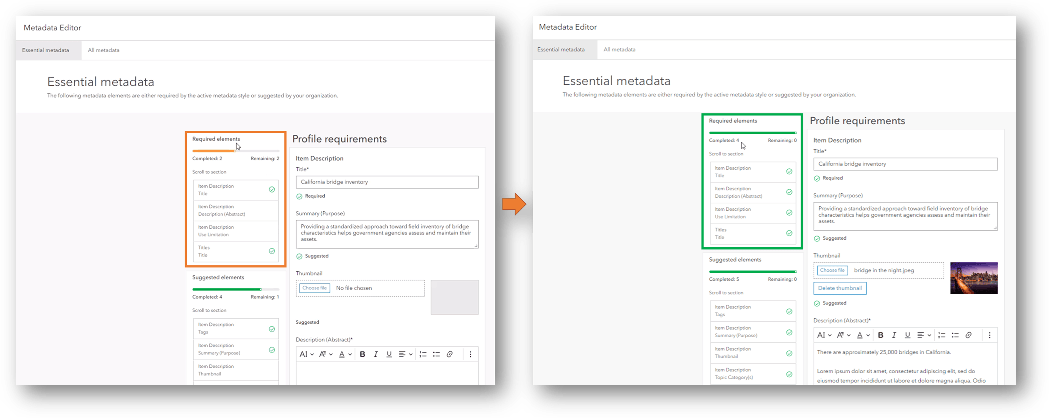

Documenting essential metadata
The Essential metadata tab streamlines metadata creation by presenting only the required and suggested metadata elements for the active metadata style.
To create a minimally compliant metadata record, tab through each element, completing the required and suggested information. Validation messages show a green checkmark for completed information and focus so you can quickly achieve what’s needed.

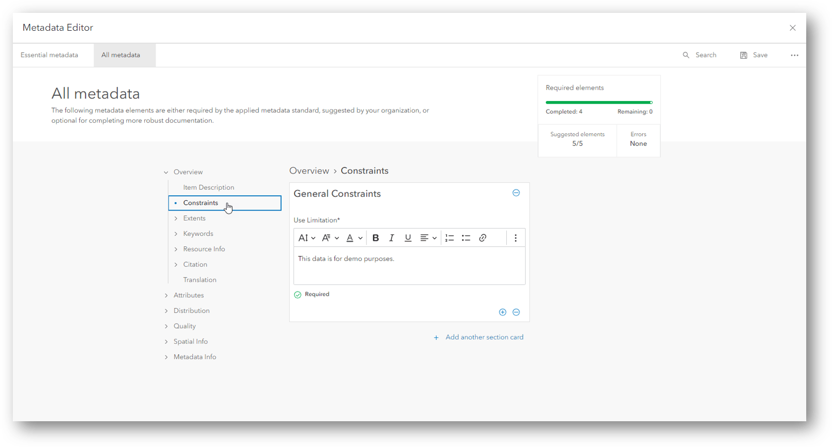

Documenting all metadata
The All metadata tab provides a complete experience, including all required, suggested, and optional metadata elements for the active metadata style.
Choose a section in the left navigation and tab through the metadata elements in that section, completing the required, suggested, and optional information as desired. Validation messages show a green checkmark for completed required and suggested elements. Navigate through each section. Click through the remaining validation messages to achieve the desired result.

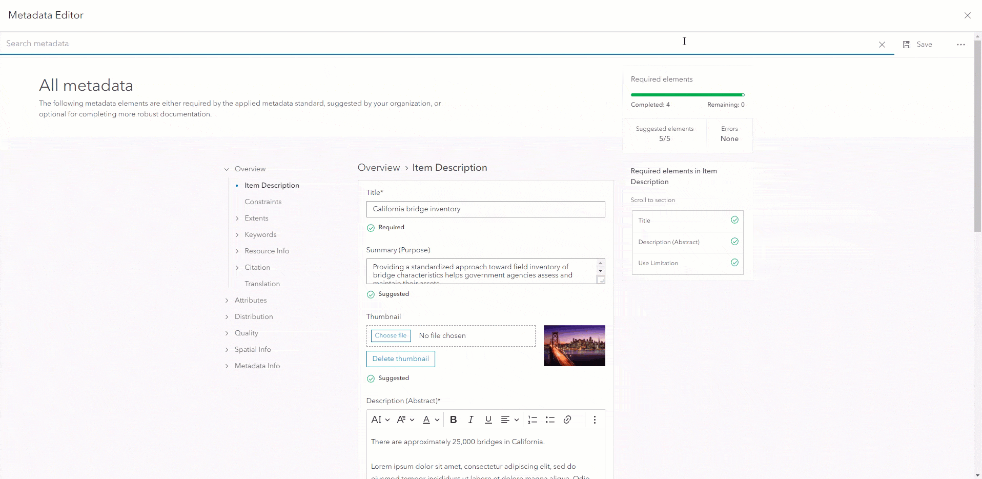

Use the new Search feature to find matching metadata elements. Some metadata elements are in optional sections that can be turned on as needed. Search results do not show these optional sections by default. During a search, you have the option to show hidden results.
