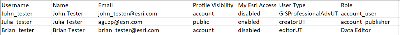

One type of report available with the June 2020 update is the member report.  It allows administrators to query and monitor all user accounts and understand the status of the accounts.
First part of organization member report
Second part of organization member report
Most fields in the item report should seem familiar, such as Username, Name, Email, User Type, Last Login Date and Date Created.
Profile Visibility indicates whether the user profile is set to public, account/organization or private.
Role is the role assigned to the user, which can be either default or custom role. Account_user and account_publisher refers to the default roles of user and publisher, respectively.

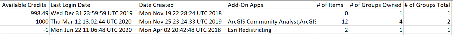

If your organization has enabled credit budgeting, the number of Available Credits shows the actual number of credits available to the user, or “-1”, which means there is no limit on credits for that user. If credit budgeting is not enabled, available credits can’t be shown, so you’ll see NaN (not a number) for Available Credits.
Add-on Apps shows the add-on licenses that are listed in the Licenses section of each user’s Settings page.
The second image above is a continuation of the members report and provides some high level information about the content and groups owned by the users. This can be helpful to gauge how a member in your organization is using ArcGIS Online in terms of content and group creation. It also can be helpful when users need to be deleted from an organization.

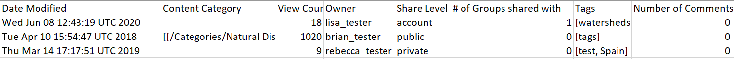

Most fields in the item report should seem familiar, such as Title, Item ID, Item Url, Item Type, Owner, Date Created and Date Modified.
There are a few additional fields that can provide deeper insight into the status of organization items such as content category, view counts, tags and number of comments. These fields can help administrators understand how users have used content categories and tags for each item, provide an overview of content in the organization and identify the items that have received the most views. Share level indicates how the item is shared, whether just with the owner, organization or public. The number of groups shows how many groups the item is shared with, making it easier to identify items shared across many groups.
Based on the information available in the report, administrators can understand an overview of the content for each user and the entire organization, identify popular items, public items or any items that need to be removed.
