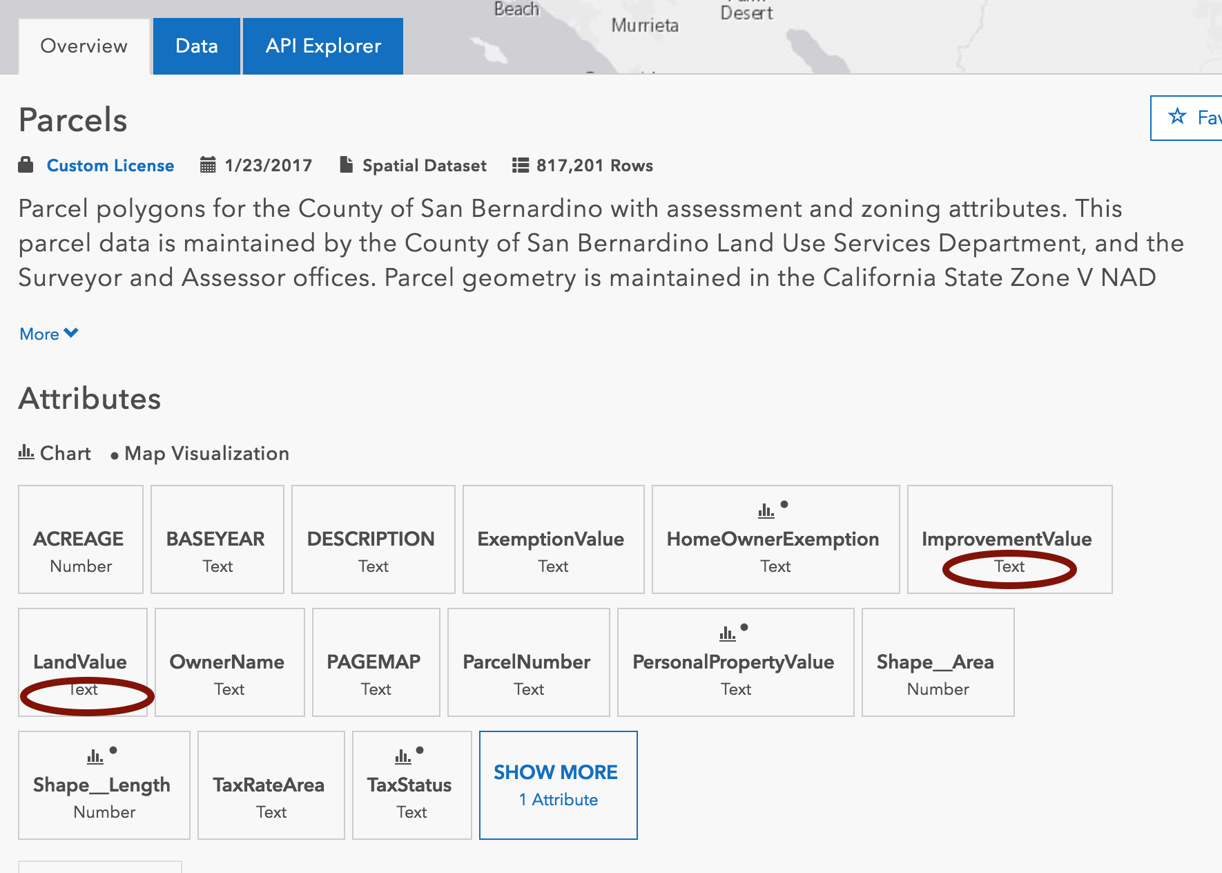

I searched the open data site to look for parcels in Redlands. Good news! I found the parcel service hosted by San Bernardino County in open data. It took about 1 minute to find and examine.
But… like many parcel services I come across, this one stored all its numeric data as text fields. Normally, this would be a showstopper, since most GIS software are insistent that if you want to make a map from numeric data, you need to provide it with, ah, numeric data.

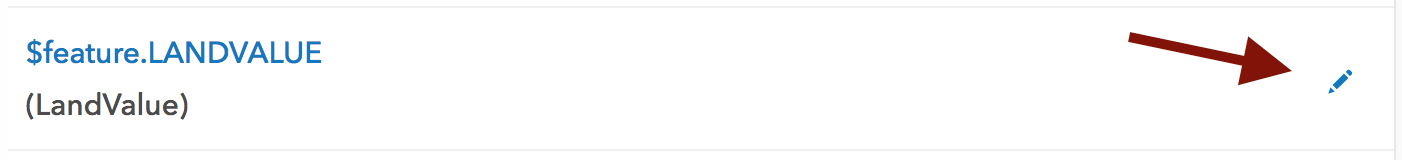

I clicked on the sample value (see arrow below)…
…and saw why: the LANDVALUE data had commas in the number string, so it was not able to convert those strings. Wait – could Arcade help me strip out the commas?

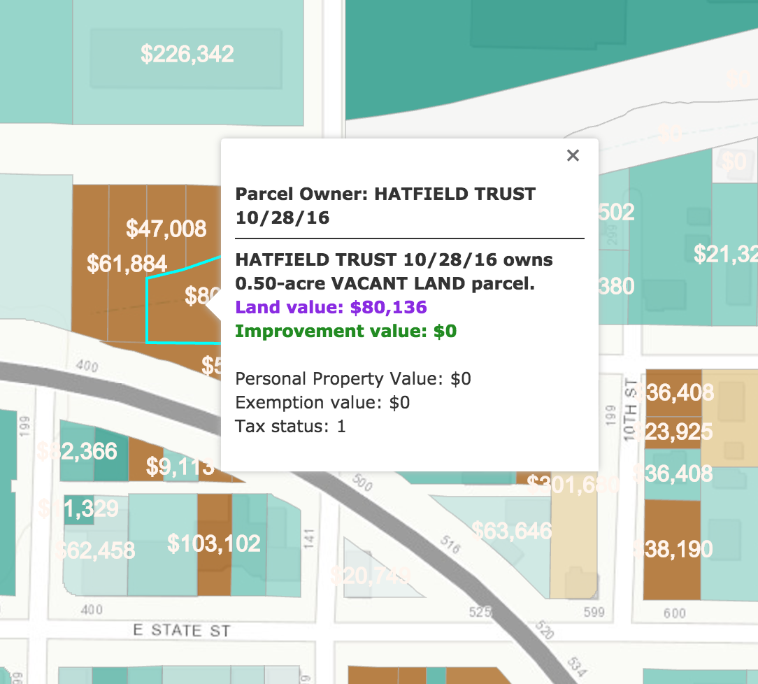

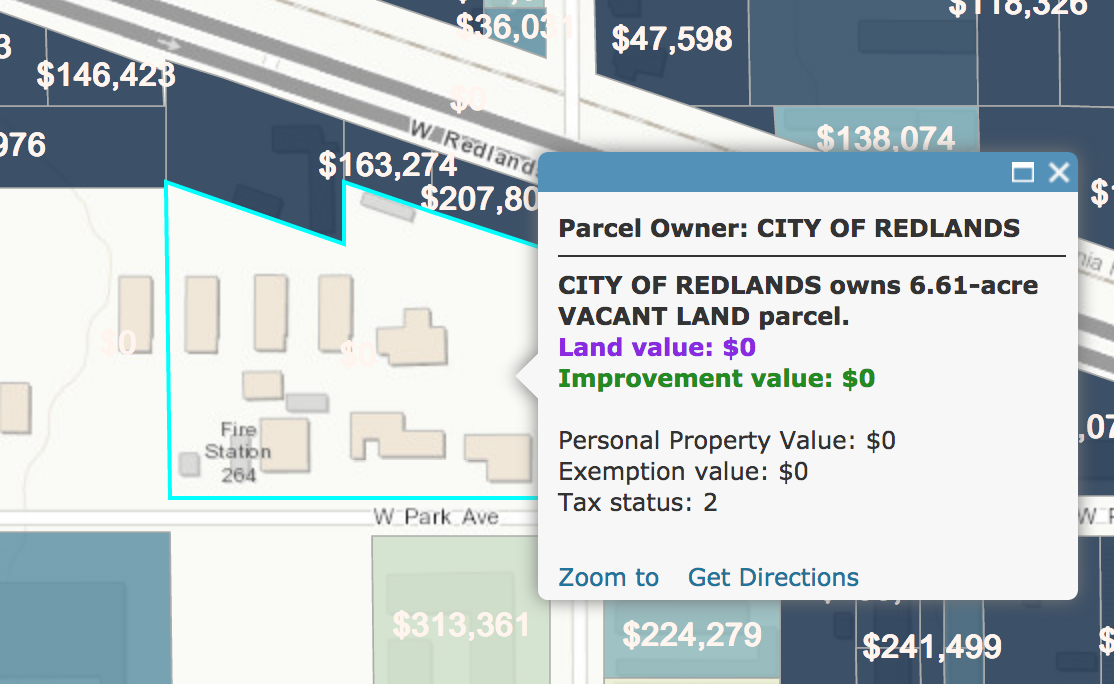

It would be great if just this little bit of code were needed to make the exact map I envisioned for understanding land values and improvement values. I showed it to a stakeholder and he noticed that some parcels were not being drawn at all. How’d I miss that?
This is where a good popup can really help. Upon inspecting some of the missing parcel (see above), I realized I needed a little more code to dictate what the map should show for divide-by-zero situations, null values and other situations. Or, I could call the county GIS department and ask them to change their schema, add this attribute, calculate the formula below, and handle all the null value and divide by zero cases.
Instead, I decided to phone a friend. Literally.
My colleague Kristian Ekenes on the ArcGIS API for JavaScript team introduced me to the WHEN statement in Arcade. WHEN is like a multiple IF statement… WHEN (this condition, do this), (that condition, do that), else just do the other. If only my kids could interpret my WHEN conditions so well. That led to this expression:
// convert string to a number var land = number(replace($feature.LANDVALUE,",","",true)); var impr = number(replace($feature.IMPROVEMENTVALUE,",","",true)); var answer = When( land == 0 && impr == 0 , 50, land != 0 && impr == 0, 100, land / (land + impr) * 100 ); return answer;
When land value as well as improvement value are zero, I have editorially decided to assign the value of land to be 50%, since both are contributing half of nothing. When land value is NOT zero, I have editorially decided the land is 100% of the value if improvement value is 0. All other cases where land and improvements have value > 0 get the original equation.

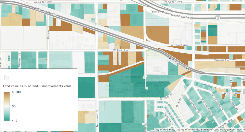

Now all I had to do was make the map. I hit “Change Style” and chose to make the map using the “Counts and Amounts (Color)” option.
I chose the theme called “Above and Below” because I wanted to use two colors on my map. The “Above and Below” theme always helps thematic maps become more clear, because you as the map’s author have to choose where to “anchor” the color ramp. In my case, I anchored my color ramp at the 50% value, meaning any values below 50% would be one color, and any values above 50% would be another color, increasing in intensity as they head toward 0% and 100% respectively.
I figured my audience would appreciate a straightforward approach: shade the parcels whose land value exceeds improvement value in brown (like dirt), and shade the parcels whose improvement value exceeds the land value in green (like the color of US currency, historically). A continuous color ramp, applied between these colors, really adds some depth to the visual display, especially when you place 50% squarely in the center of that color ramp.
The resulting web map is below and here. I also dropped it into this story map so that I could take people on a quick map tour of interesting areas. It has generated a lot of positive feedback from people who know the area, or know real estate, or know parcel data. Check out the Labels on the layer to see how I used an Arcade Expression in my map’s labels.
