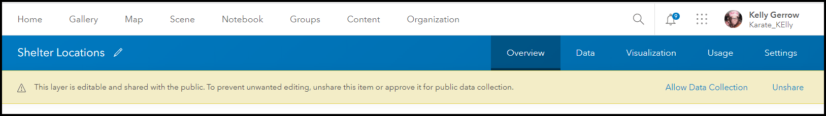

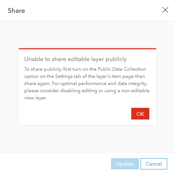

In some instances, sharing editable layers with everyone is needed, such as when sharing applications for the purpose of public data collection, like crowdsourcing apps or public surveys. To ensure that editable layers are intentionally shared with the public, a new setting called Public Data Collection has been added to hosted feature layers, starting with the September 2020 update of ArcGIS Online. By enabling this setting, you are approving the layer to be shared publicly with editing capabilities turned on. When this setting is not turned on and the layer is not shared publicly, you cannot change the layer’s sharing level to everyone (public). This new setting is an extra safeguard to help ensure that publicly editable data is being shared intentionally for the purpose of data collection. When collecting data from the public, you are encouraged to follow the best practices outlined in this Survey123 article.
4. Protect your data: Follow best practices for data collection when using hosted feature layers for Public Data Collection
As this is a new setting for feature layers that was not available prior the September 2020 update, you’ll see a banner notifying you of this on any layers that you own and that are editable and shared with the public. This includes layers that are shared with everyone and layers on which editing is enabled when publishing from ArcGIS Pro or programmatically.

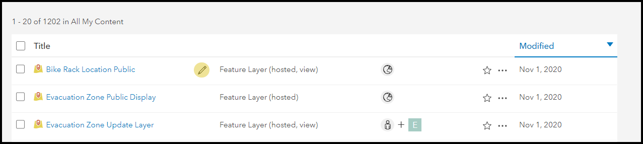

As maintaining data integrity is critical at all times, but especially over the first week of November with the 2020 U.S. Election, we encourage you to verify that no layers that are being used in public applications accidentally have editing turned on without the intention of collecting data from the public. The ArcGIS Security Advisor has a new Beta feature, named public FS Edit Check that allows administrators to quickly view all of the organizations public feature layers(including Views) and inspect the capabilities, like editing that are enabled. If you want to double check which publicly shared items are editable in your organization, and designate the appropriate layers as Public Data Collections please test out Security Advisor. We are excited to see the great data and apps that our users share to keep the public informed, next week and in the future. Check out the related articles below for more to best practices for viral applications.
