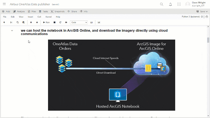

This article describes the use of ArcGIS Notebooks hosted in ArcGIS Online to decrease the time requirement for file transfers when publishing hosted imagery layers. When hosted in ArcGIS Online, the notebook executes code within a container inside the user’s ArcGIS Online organization. Therefore, imagery downloads directly into ArcGIS Online and does not rely on the internet speed at the user’s computer. Furthermore, while publishing, the imagery is already inside the ArcGIS Online organization, making the upload step very fast. When directing these data transfers with code in an ArcGIS Online hosted notebook, the user maintains full internet bandwidth at their local computer.

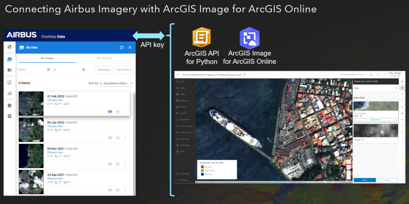

In this case study we published tiled imagery layers in ArcGIS Image for ArcGIS Online using our API key from OneAtlas Data API to explore all six multispectral bands of Pleiades Neo, across four acquisition dates: Feb 1, 2022, Jan 6, 2022, Sep 24, 2021, and Nov 4, 2021 (see below).
Esri’s ArcGIS API for Python delivers a set of classes, methods, and functions to perform data conversion, reclassification, change detection, and more. Esri has also added ArcGIS Image for ArcGIS Online support, so you can automate the creation of hosted imagery layers, by transferring the imagery directly from OneAtlas Data to ArcGIS Image for ArcGIS Online.

The solution is achieved using an ArcGIS Notebook (click here to download a copy), which can be run interactively or scheduled to run automatically, publishing ongoing Airbus imagery orders for your area of interest. Note: To take advantage of direct file transfers, be sure to add the ArcGIS Notebook as an item in your ArcGIS Online organization before using it.

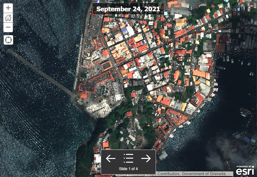

Result: Visualizing Hosted Imagery
The resulting hosted imagery layers can be explored in the embedded Web Map below, or explored in more details in a separate browser tab:
All of these capabilities – hosting imagery with the full data model including all bands, and full bit depth, sophisticated raster analytics, and automating content delivery—are now all possible using ArcGIS Image for ArcGIS Online.
