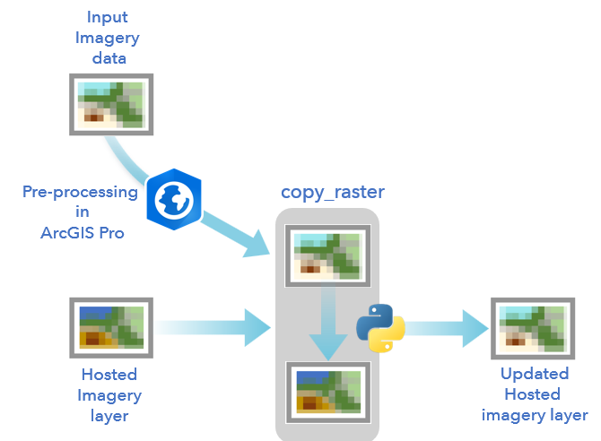

Copy_raster update process
The copy_raster task replaces the image data within the imagery layer.
How the Update Process Works
When you use copy_raster to update an imagery layer:
  1. All existing imagery data is replaced
  2. The imagery layer item, metadata, and sharing settings are preserved
  3. The updated layer contains only the imagery specified in the task
