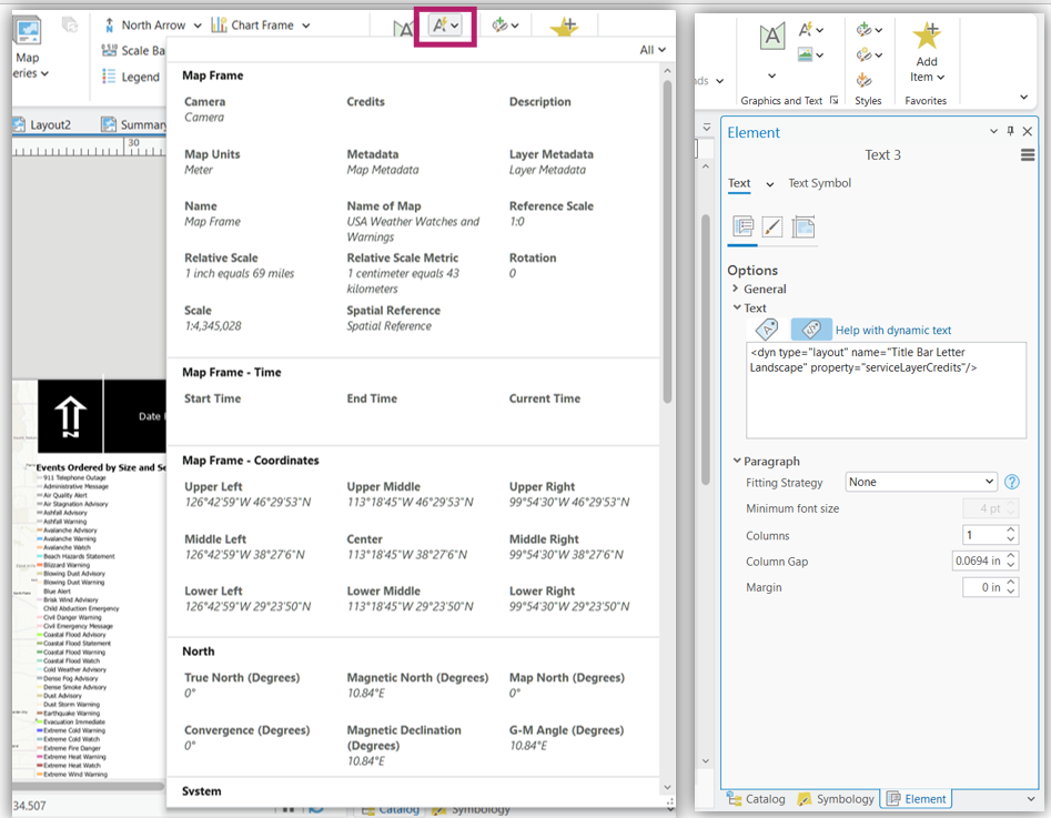

Supported Dynamic Text Elements
ArcGIS Pro layouts also include the option to add dynamic text elements. These dynamic text elements include things such as the map title, author, or date printed  that  you want to update automatically based on the current web map properties when you generate your print export.
You can manually enter the tag or select it from the Dynamic text gallery when authoring a layout in ArcGIS Pro. The full list of tags available in Pro is available here , however not all of these are applicable or supported when printing from a web environment.  Below are some of the more common dynamic text elements that work well when printing from Map Viewer.
System – Current time (Prints the current date & time. Use this instead of Date Printed or Date exported when printing from Online):
Current Time: <dyn type=”date” format=””/> <dyn type=”time” format=””/>
Layout – Title (Prints the Web Map Title):
Title: <dyn type=”layout” property=”metadata” attribute=”title”/>
Service layer credits (Prints the acknowledgements / credits from the AGOL layer item)
<dyn type=”layout” property=”serviceLayerCredits”/>
Various Portal tags (These print information about your AGOL account including Username, Full Name, & Organization Name. They can be used to auto populate Map author for example):
<dyn type=”project” property=”portal” attribute=”username” portalUri=”https://www.arcgis.com/”/>
<dyn type=”project” property=”portal” attribute=”fullname” portalUri=”https://www.arcgis.com/”/>
<dyn type=”project” property=”portal” attribute=”orgname” portalUri=”https://www.arcgis.com/”/>
There are also  a number of dynamic text elements that provide information about the map itself  such as North info, map coordinates, scale, or spatial reference info. Supported tags from the Map Frame section include: Camera, Map Units, Reference Scale, Relative scale, Relative Scale Metric, Rotation, Scale, Spatial Reference All tags from the Map Frame – Coordinates section and North section will work as well.
Quickly add dynamic text elements from the Dynamic Text option in the toolbar.

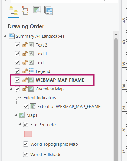

Multiple Maps
You can author a custom print layout template that includes multiple maps, provided that just one of these maps references the web map you are printing from. This can be useful if your layout contains multiple static maps authored in ArcGIS Pro but only one map that you update in ArcGIS Online.
To ensure that your  web map is printed in the correct Map Frame and you get no errors when printing, you must determine which Map Frame you want the online print service to use and name it WEBMAP_MAP_FRAME (case sensitive). The print tool will error if you try to use a layout template containing  multiple map frames without this designation.
Note – If you have scale bars or north arrows in your layout – ensure that they are referencing WEBMAP_MAP_FRAME as so that they update dynamically to match the web map you are printing from in ArcGIS Online.
Ensure one of your map frames is called WEBMAP_MAP_FRAME if your layout contains multiple map frames.
Inset Maps
Take advantage of the support for multiple maps in your layout template to create an inset map! An inset Map authored in ArcGIS Pro will update dynamically to whatever location you zoom to when printing in ArcGIS Online as long as:
  • The location from which you print in ArcGIS Online is within the extent of the static map you set up as your inset Map in Pro (The inset map should NOT be the web map)
  • The source for the Extent Indicator is your WEBMAP_MAP_FRAME.

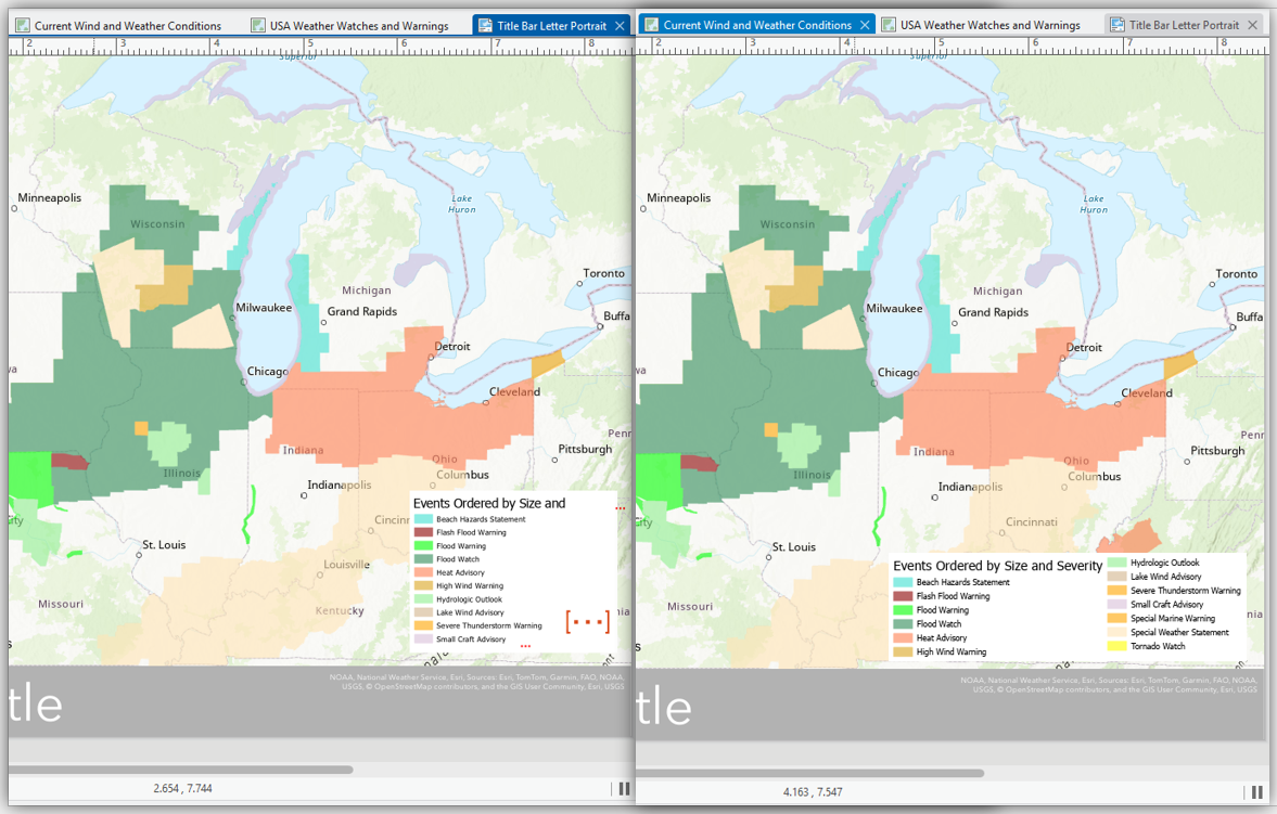

Preview a comparable web map in ArcGIS Pro
To help clarify how elements might look when you print your web map from ArcGIS Online, it can be useful to bring a similar web map into ArcGIS Pro. Think about the types of web maps that you might expect to print with this layout and select one that is comparable. This is especially useful when working with maps that might have many legend items, layers, or long service (attribution) credits. In the example below, I opened a web map containing various weather watches and warnings from the Living Atlas because I knew it had a lot of unique values. I could see that the legend title was cut off and not all the legend elements fit in the space in my initial layout (left). I adjusted the legend size and then everything displayed well.  This should help print similar content successfully.
Open a sample web map in ArcGIS Pro to better understand how the data works with your layout.

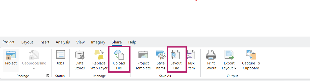

Publish your custom print layout template with a thumbnail & other metadata
While we work to streamline the publishing process of layout templates from ArcGIS Pro to ArcGIS Online, there are some things you can do now to improve the experience for your users. The first is to generate a thumbnail of your layout before publishing it as an item. This will help your users know what the layout looks like in ArcGIS Online before printing from it.  You can do this by right-clicking the layout file in the Catalog pane and choosing Create Thumbnail. Draw a box over your layout and it will take a snapshot of the layout.
To ensure the thumbnail is included when publishing to ArcGIS Online, first save the layout item to your computer using the Save As > Layout File option. Then, upload it with the Manage > Upload File button. You can add additional metadata at this stage.  Both of these are found under Share.
Share your layout file to ArcGIS Online with the Upload File tool.
