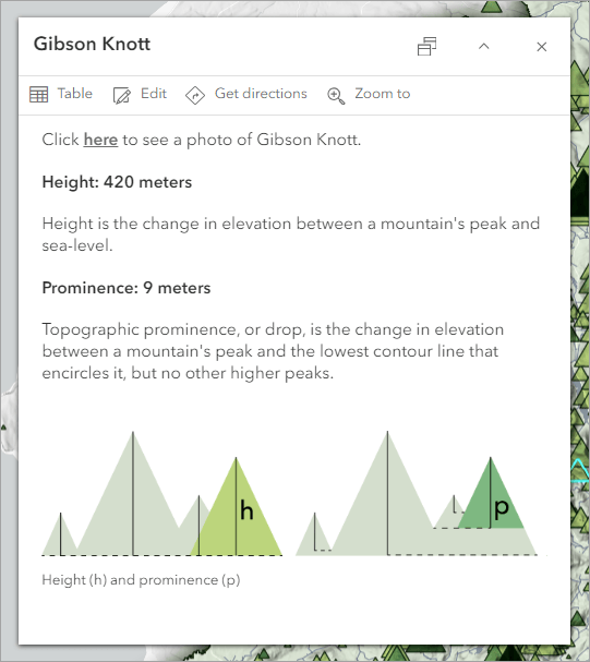

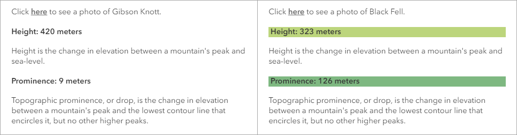

I don’t typically craft an entire pop-up with HTML. Instead, I insert small amounts of code to achieve finishing touches that aren’t possible to do otherwise. In the example below, I used HTML to add color highlighting to some text:
Pop-up before and after formatting
Pop-up before and after HTML formatting

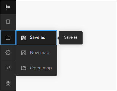

2. Optionally, sign in and save a copy of the map. (On the Contents (dark) toolbar, click the Save and open button and click Save as.)
Save as button

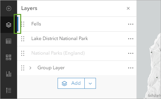

3. On the Contents toolbar, click the Layers button. In the Layers pane, select the Fells layer.
A blue bar appears next to the layer when it’s selected.
Blue selection bar in the Layers pane

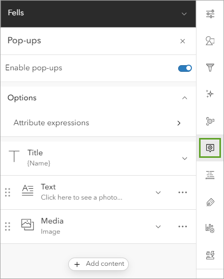

4. On the Settings (light) toolbar, click the Pop-ups button to open the Pop-ups pane.
Pop-ups button and pane
The pop-up for this layer has already been formatted with a title, text, and an image.
Pop-up

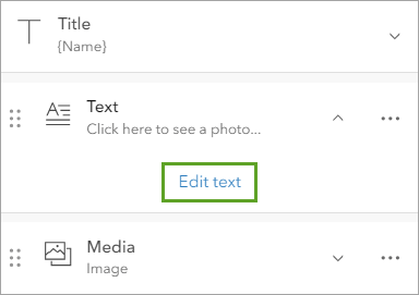

5. In the Pop-ups pane, click Text, and click Edit text.
Edit text button

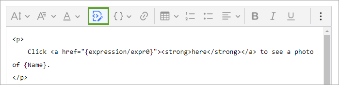

6. On the text editor toolbar, click the Source button.
The text reappears, formatted as HTML.
Source button
The first three lines of text look like this:
<p>
    Click <a href=”{expression/expr0}”><strong>here</strong></a> to see a photo of {Name}.
</p>
  • The <p> tag defines the start of a paragraph. The </p> tag defines the end of the paragraph.
  • The <a href=”…”> and </a> tags apply a hyperlink to the text between them. In this case, the hyperlink is {expression/expr0}, which is an Arcade expression defined elsewhere in the web map.
  • The <strong> and </strong> tags bold the text between them.
This code equates to a paragraph with the text Click here to see a photo of {Name}. The text here is both bolded and hyperlinked.

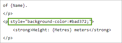

7. Find the second <p> tag, on the fourth line, just before <strong>Height: {Metres} meters</strong>.
This <p> tag indicates the start of a new paragraph. You’ll add inline CSS to change the background color of this paragraph to green.
8. Add a space after the p and type style=”background-color:#bad372;”.
Inline CSS
The text you added is referred to as inline CSS. CSS stands for Cascading Style Sheets and is a language that is used to add styling to HTML. Typically, CSS is written in a separate file that the HTML file references, but it can also be added directly to the HTML code, as you are doing here. When it is added directly, it is called inline CSS.
By adding the style=”” attribute to the <p> tag, you are saying that you want to format the paragraph with some kind of style. Specifically, you want to change the background-color property to #bad372, which is the hex code for a pale yellow-green color.

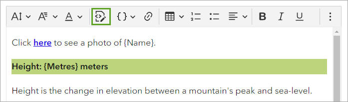

9. On the text editor toolbar, click the Source button to return to the visual editor.

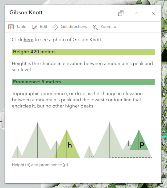

The second line of text is now highlighted in green.

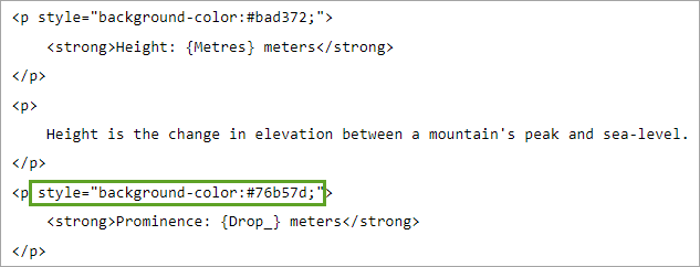

11. Scroll down to find the <p> tag just before <strong>Prominence: {Drop_} meters</strong>.
12. Add a space after the p and type style=”background-color:#76b57d;”.
Inline CSS
This is the same code that you added earlier, just with a different shade of green.

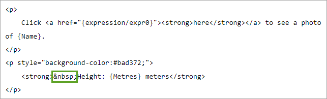

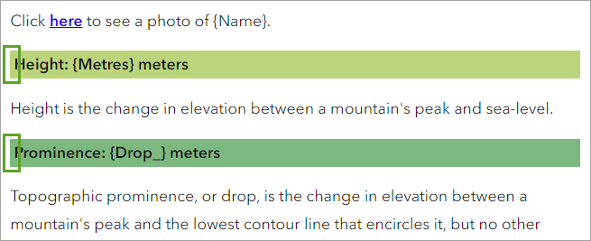

14. Add a space before the words Height and Prominence to create a bit of a buffer with their backgrounds.
Spaces added to text
15. Click the Source button again.
A new bit of code has been inserted: &nbsp;. This is the code for a nonbreaking space.
Non breaking space

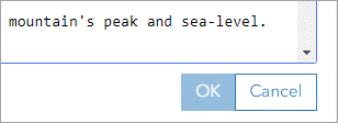

You’re ready to commit your changes. However, the OK and Cancel buttons are not available.
You need to switch out of source view before you can click them.
16. Click the Source button. Click OK.
The color background formatting is now visible on the pop-up. The two colors match those used in the diagram, making it easier for people to relate the text to the image.
Finished pop-up
