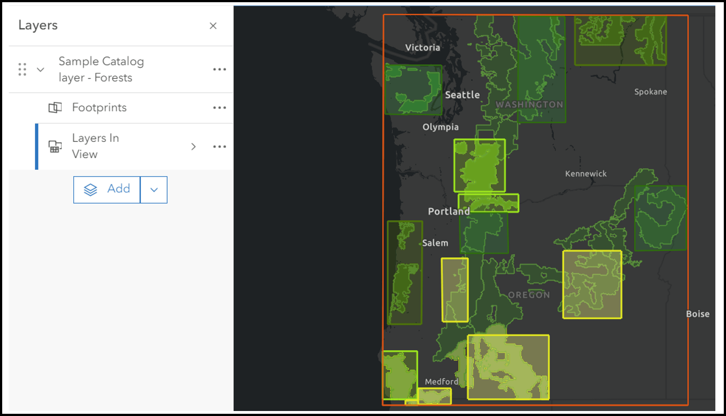

Catalogs have a unique architecture. Each one contains 2 sublayers, the Footprints layer and Layers In View:
- The Footprints layer is a handy visual tool showing where data is located on the map.
- Layers In View is a dynamic group layer that can include various feature services, image services, scene services, and more.

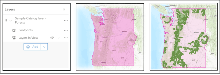

Dynamic Filtering
The catalog automatically filters the layers as you pan and zoom the map, so the list in Layers In View only shows the layers that are visible in the map extent.

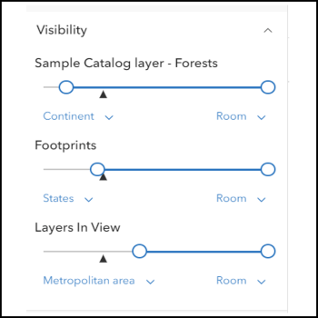

Layer Visibility
Adjust visibility ranges for the Catalog layer itself, as well as the Footprints layer, and Layers In View in one central location on the Properties pane.

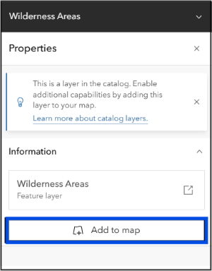

Add a Layer to the Map
When you locate a layer in the Catalog that you want to add to the map, click the Add to map button.
