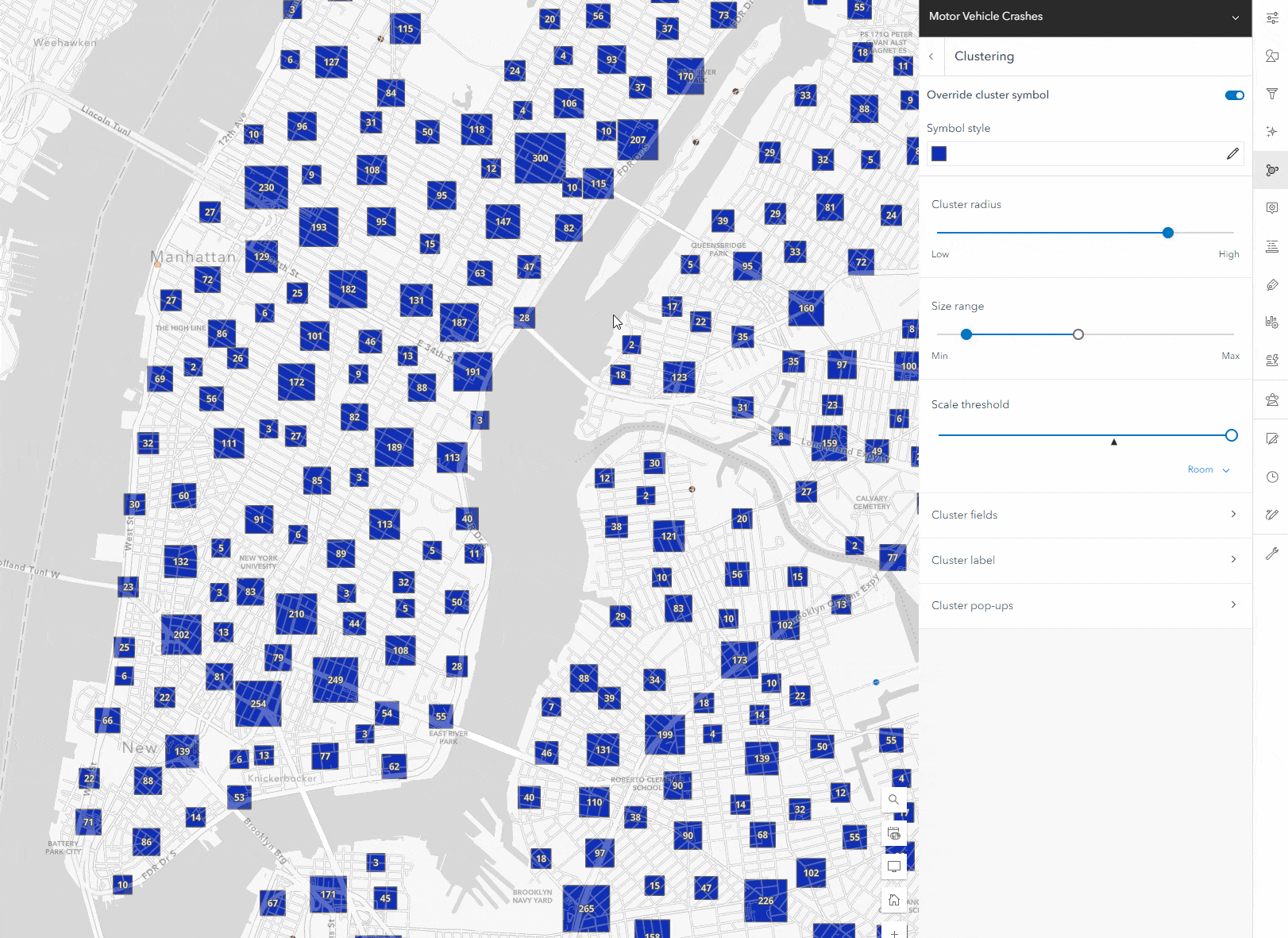

How to set the scale threshold for clustering
Opening the clustering panel, you will see the configuration controls, like setting a symbol override, cluster radius, and size. Below that is the scale threshold. In the gif below, you will see that zooming in and out will change the clusters, but they will remain. Once you set the threshold, you will see that zooming past that set level in the map view will disable clustering, and you will see individual features

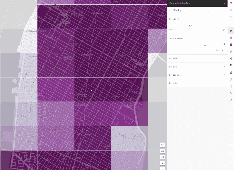

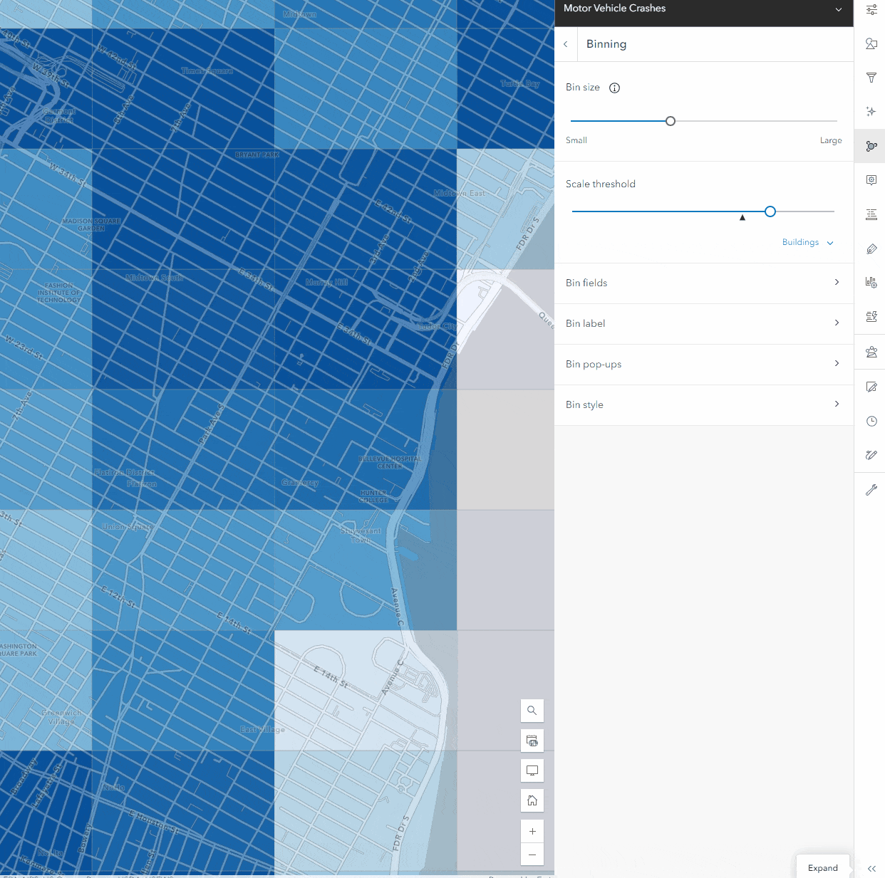

How to set the scale threshold for binning
When binning is enabled, it will generate a set bin size suitable for the map scale currently being viewed, which can be customized. The size does not change like clustering when you zoom in and out, as you will see in the gif below. This makes setting a scale threshold for binned data particularly useful when zoomed in to a level where the size of the bins does not help the viewers understand any aggregation patterns. Setting the bin threshold is in the same place as clustering, and once you see the level that will help the users, the features will be displayed without the binning applied.
Updates to configuring bin style
Before this release, when binning was enabled on the layer, there was no way to see individual features unless binning was disabled. This meant you could not configure individual feature styling, and the Styles panel was only used for styling your bins. With the scale threshold present, you can now style your bins and your layer’s non-binned view. The new bin styling is available inside the binning panel now. This matches the same workflow as adding new statistic fields, popups, and labeling.
