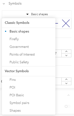

The new symbols are found in the same location as before within the Smart Mapping panel of New Map Viewer, but you will see we have broken the symbols out into two main categories – Classic and Vector.
The Classic Symbols were included in the initial release of New Map Viewer. All of the symbol sets except for the basic shapes are picture marker symbols which means they use an image to define the appearance of the marker. This means the size can be adjusted only with Simple style and cannot be used for other smart mapping styles like Types or Counts and Amounts (color). Scaling these symbols can lead to distortion as the pixels.
The Vector Symbols are the latest symbol sets we have added to New Map Viewer. The Esri provided symbols are Scalable Vector Graphics (SVG), which is a vector image format for 2D graphics. A benefit to using SVG images is that the integrity of shapes is preserved in scaling which makes for a cleaner, better looking map.  You can use these symbols for all point styles which you will see in some examples below. Another important note on these new symbols is how they were published. These symbols are coming from 2D web styles which were published from ArcGIS Pro 2.6. This means you can also publish your own web styles for use in the Map Viewer and use them alongside the Esri provided ones. I will cover the publishing of web styles in a future blog post.

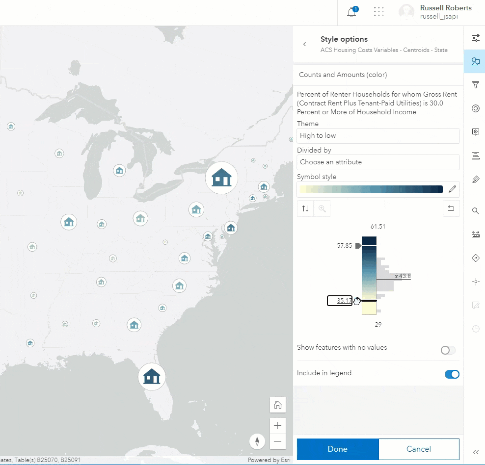

The first example uses the POI style with the house symbol with the Color and Size style to look at housing variables. You can see the symbols are size differently and even the larger symbols have a clean, sharp outline that doesn’t distort as the points get larger. As the slider on the ramp moves you can also see the fill on the house adjusts in real time. The outlines of these symbols can also be independently colored and have their width or transparency adjusted.

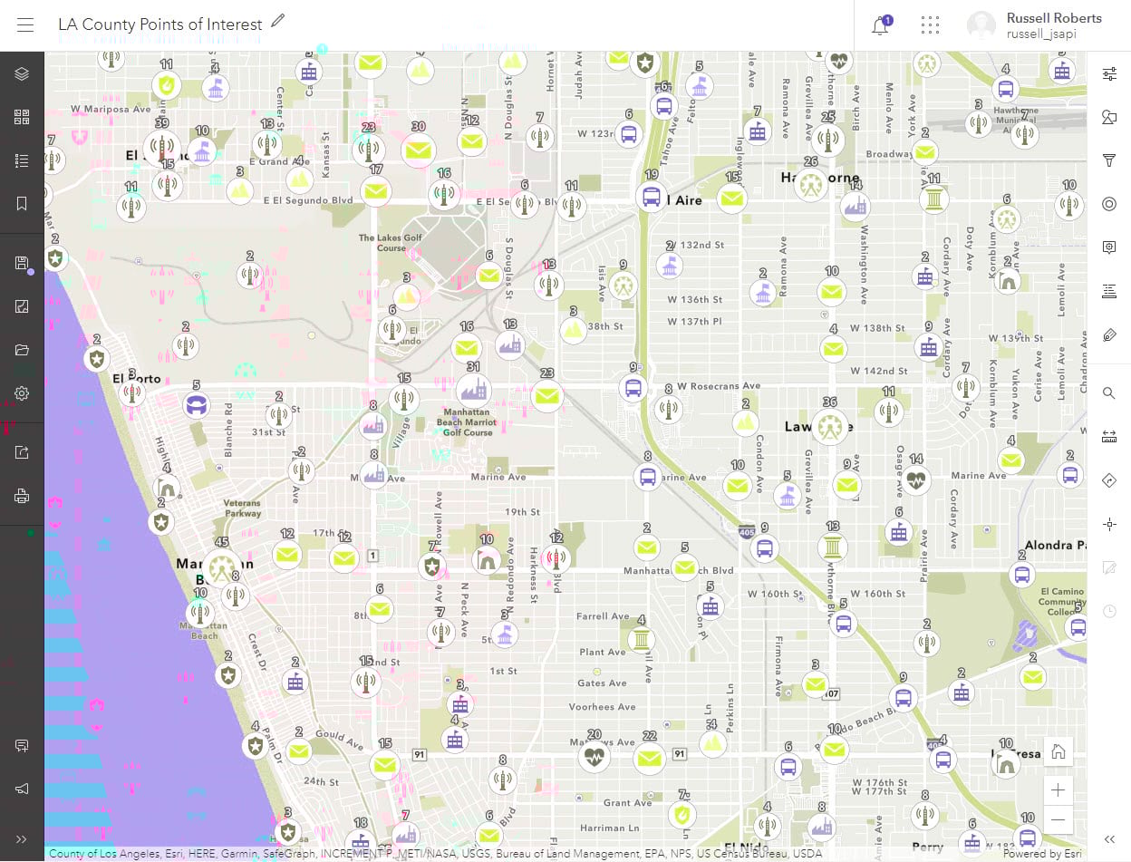

Next here is an example map where we are using the Types style to render POI locations in Los Angeles with clustering enabled and the cluster counts label is enabled. The features have been styled using the type ramps colors on the POI symbols. The cluster shows the predominant type within the cluster and the cluster count drives the size with the count label positioned just above the symbols.

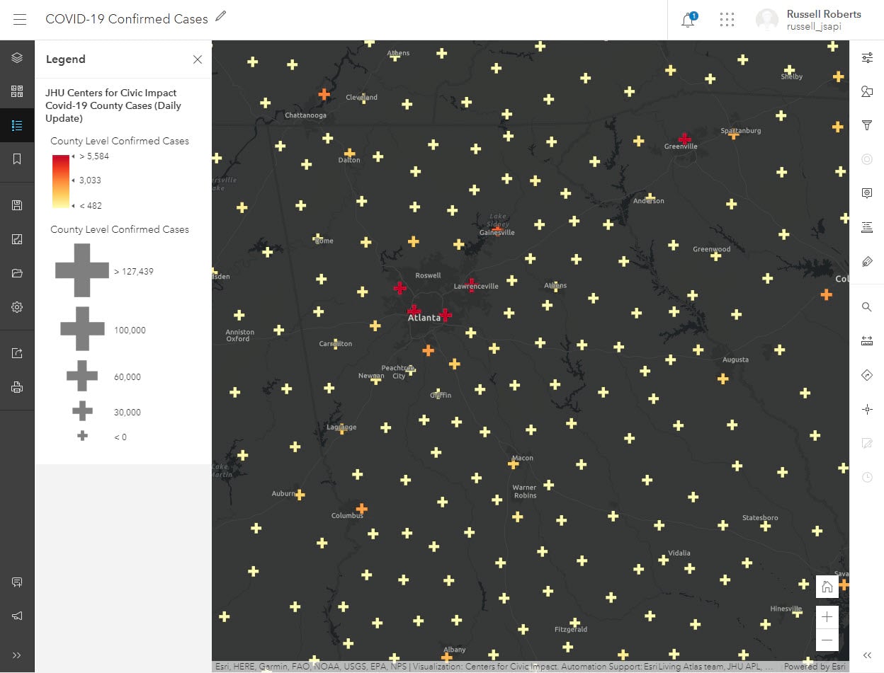

This final example shows one of the new symbols in the Shapes symbol set. This map is looking at the reported COVID-19 cases per county and using the Cross symbol Color and Size style.
