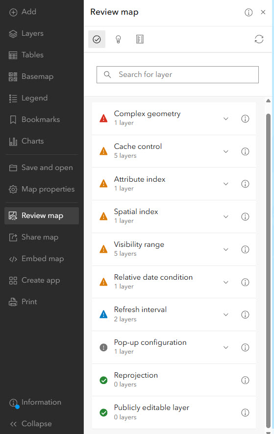

When you open Review map, you’re presented with a list of layer configurations that can influence map performance and scalability. The list may highlight layers that do not follow best practices, or it may simply confirm that your map already aligns with best practices. The color-coded symbols indicate the level of importance of each configuration recommendation as it relates to map scalability. There are five possible categories for a configuration to fall under, these include:
High priority (red)
  • Public editable layer
  • Complex geometry
Moderate priority (orange)
  • Cache control
  • Attribute index
  • Spatial index
  • Layer visibility
Low priority (blue)
  • Relative date condition
  • Refresh interval
  • Reprojection
Informational (grey)
  • Pop-up configuration
Aligned with best practices (green)
  • Green indicators confirm a configuration
    is already aligned with recommended practices

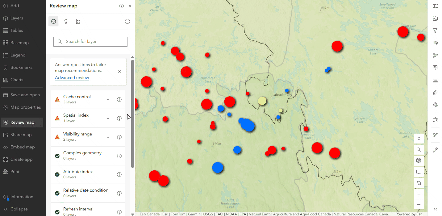

Review map panel in Map viewer showing various priority levels per each recommendation

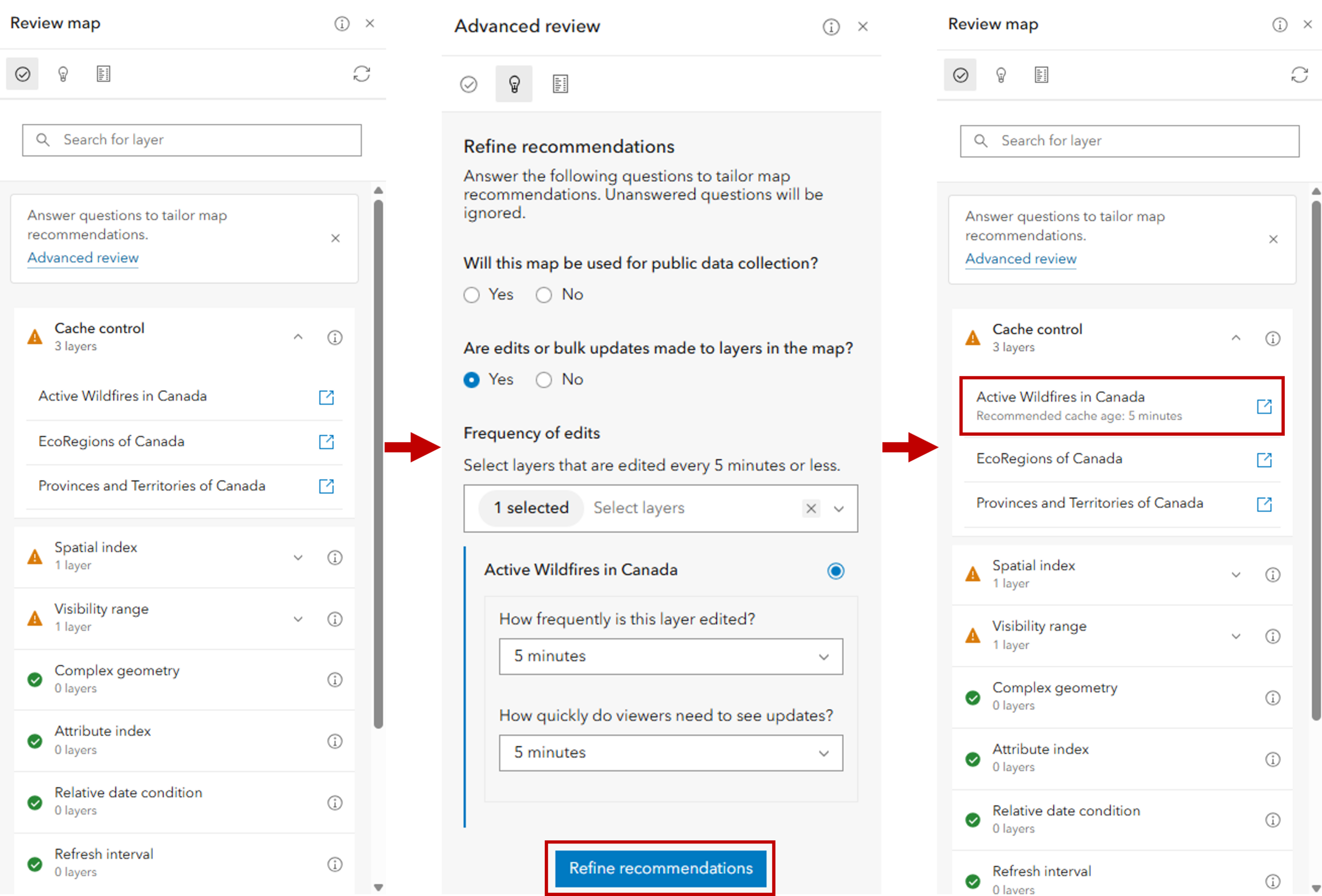

The second tab in the tool is the Advanced review. Here, you can answer questions to generate updated recommendations that take your use case and data characteristics into consideration. For example, if your map is intended for public data collection and it contains a publicly editable layer, we’ll deprioritize the public editable layer recommendation so you can focus on other areas of the map to review.
Advanced review will also ask you about the frequency of data updates to your layer. In this context, “data updates” includes both editing and syncing field data, whether performed by users or automation such as python scripts. The frequency of data updates along with the maximum amount of time your users can wait before seeing those updates will influence your recommended cache age. Answering these questions will bring you back to the Review map tab to see specific cache age recommendations for each layer you identified as frequently updated.
If you’d like to modify your answers, you can do so at any time. The answers you provided will be retained while the Review map tool is open.
When questions in Advanced Review are answered for editing frequency, the recommended cache age becomes specific to your dataset's needs, per your recorded response.
