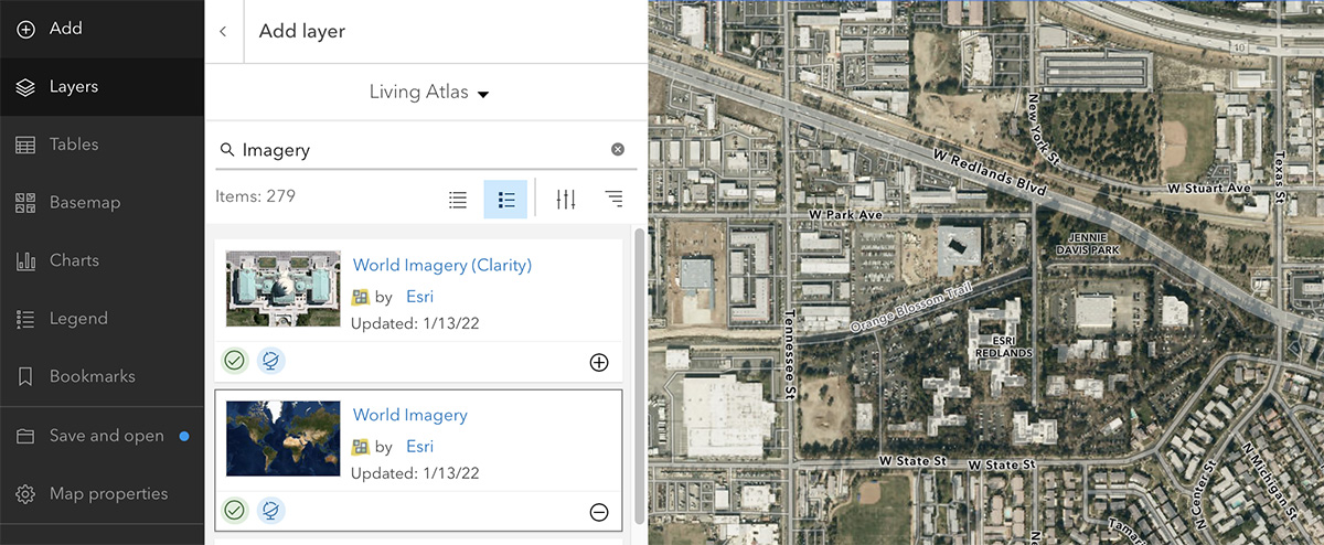

Choose ‘Layers’, go to ‘Add Layer’ and use the Living Atlas to find ‘World Imagery’ (or any other layer you want to feature). Keep this in ‘Layers’ – don’t move it to ‘Basemap’.

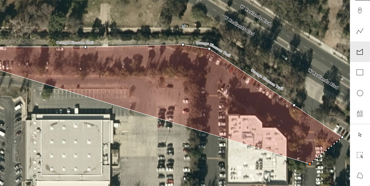

Zoom in to the area you want to focus on, then add a Sketch layer.  Use the polygon draw tool to outline it.
Using the Sketch Polygon option to draw an outline around the Esri Campus

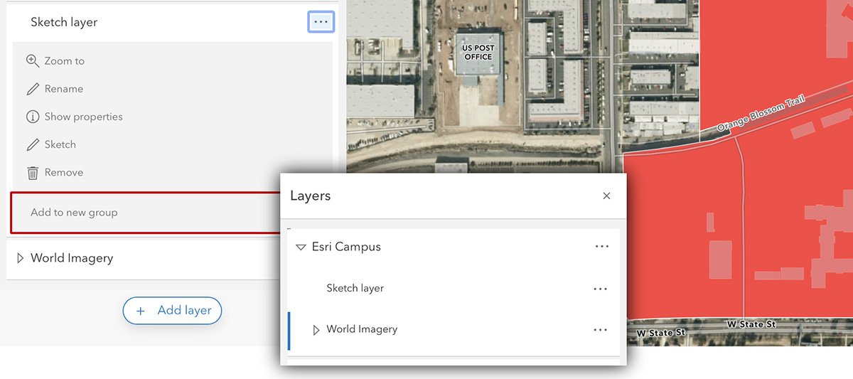

When the drawing is complete, and with the new Sketch layer selected, choose ‘Add to new group’. Change the group name to something suitable.
Move the ‘World Imagery’ layer into the same group (Click and drag, or use the ‘Move to group’ command). Make sure the ‘Sketch’ layer is on top.
Moving the imagery layer into a group layer

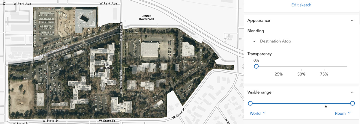

With the Sketch layer selected, go to ‘Properties’ and set ‘Blending/Destination Atop’. Your sketch polygon should now be acting as a mask for the imagery, and you should see the Human Geography base surrounding it.
Imagery restricted to the area of the Sketch polygon

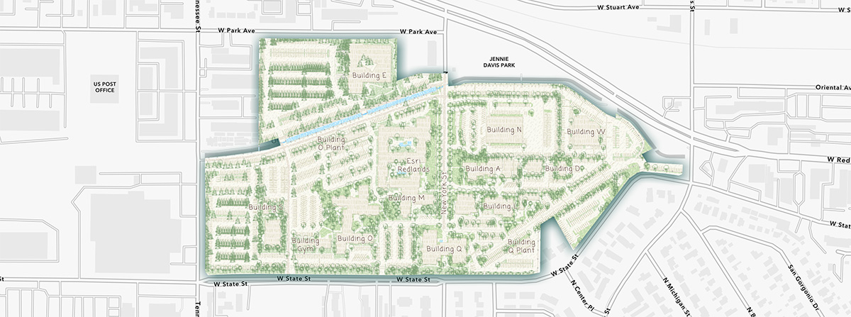

Before I commit to using Imagery, I’m going to try a few other possibilities. Here I’ve added the ‘Colored Pencil’ basemap as a layer, moved it to my ‘Esri Campus’ group, and switched Imagery off. I can try any number of items this way before I sign off on the map. For now, though, I’m staying with imagery.
The Esri Campus polygon with the 'Colored Pencil' basemap

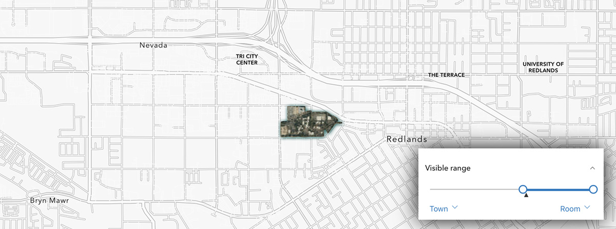

I now have my area of interest identified with a strong image. But it’s only going to be really effective at larger scales, and this is going to be a multi-scale map. So, zoom out until you feel it’s getting too small. Select the group layer, then adjust the scale range in ‘Properties’ to stop it at this point.
Setting the scale range on the group layer

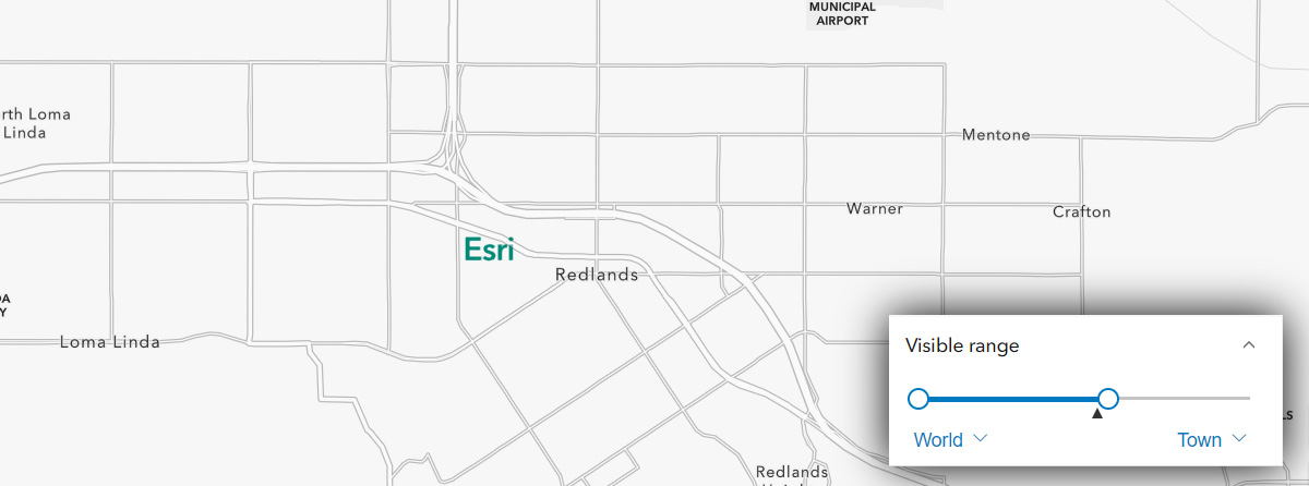

Zoom out once, so that your located area disappears. Create a new Sketch Layer, then place a label on your location. Use ‘Scale Range’ to stop it appearing at larger scales. Zoom out some more to make sure that the label is a good size and positioned well.
Setting the scale range on an added Esri label at small scale

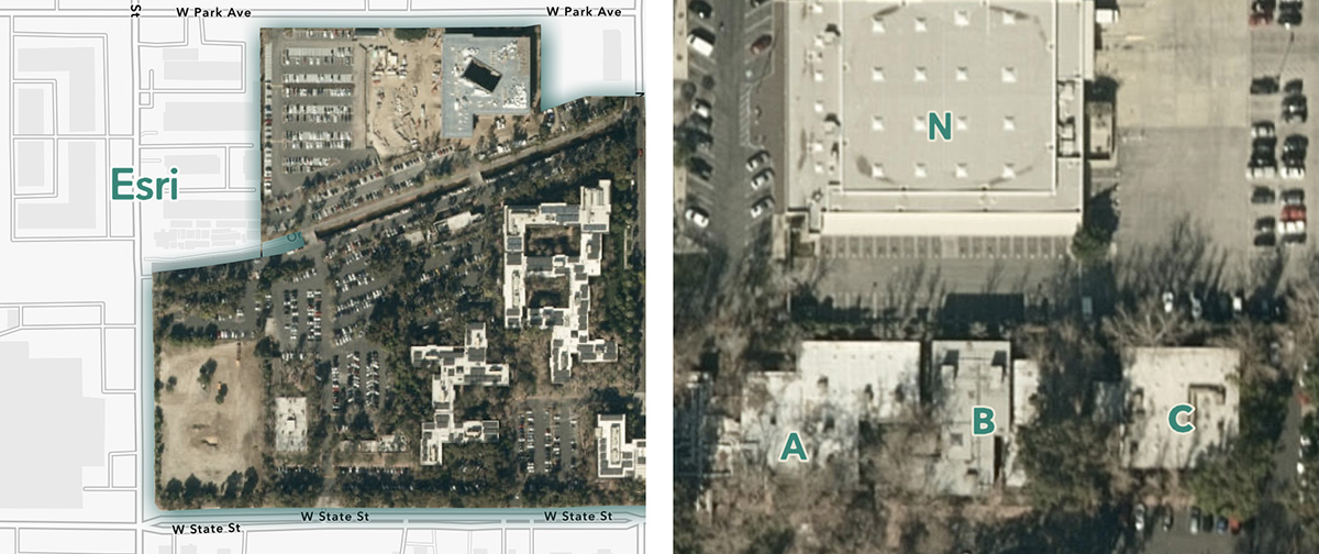

Now you can use a combination of new scale-delimited Sketch Layers to add extra labels and symbols as needed at larger scales. I used two more:
  • One adds an offset ‘Esri’ label alongside the campus
  • One adds building identifiers at larger scales
Two graphics, showing the 'Esri' sketch layer, and the 'building identifier' sketch layer

  1. I found that I had to first set the Fill Transparency on the sketch polygon to zero (0) before I drew it. Once I figured that out this worked great and was easy.
