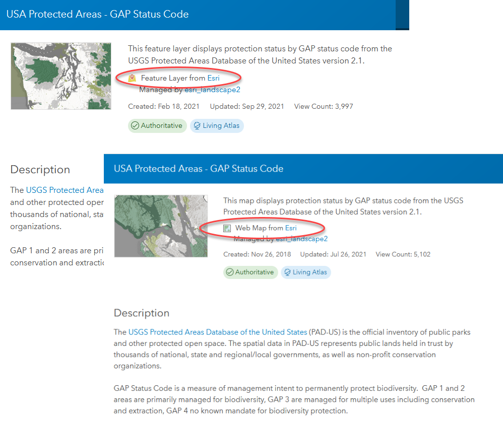

Layers are the building blocks of web GIS. Feature layers, imagery layers, tile layers, and scene layers are all examples of layers. Each layer is an item in ArcGIS Online and combines data with symbology, pop-up configuration, filters, and other properties.
Each layer and web map is an item in ArcGIS Online. We can tell that these items are a feature layer and a web map as indicated by the icon and text next to the thumbnail and below the summary on each item.
To view layers, we add them to a web map. Like layers, each web map is an item in ArcGIS Online. Web maps have a base map and may have one or more additional layers.

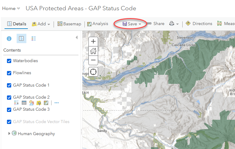

In the Classic Map Viewer there are two places where you can save: at the top of the map and under more options on layers that you own.
To save the web map in the Classic Map Viewer click Save at the top of the map.
The Important Part
Save Map at the top of the Classic Map Viewer saves any changes you have made to the web map. If you close and re-open the map you will see that your configuration has been saved.
However, if you add the layer to a new map you will see that the settings you changed and saved in the map are not reflected in the layer.

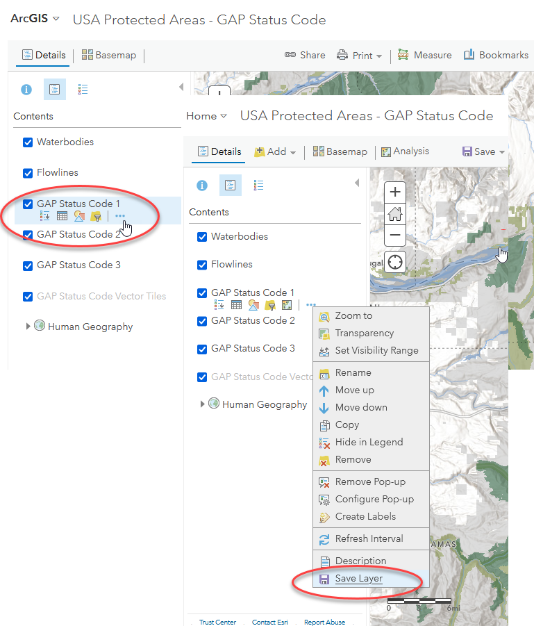

To save a layer click the three dots for More Options under the layer and then Save Layer at the bottom of the list. Note that you must be logged in as the layer's owner to see the Save Layer option.
In this case every time the layer is added to a map the layer will need to be symbolized and the pop-up configured. As a best practice we recommend saving the layer’s configuration to the layer itself by selecting More Options (the three dots under each layer in the table of contents) and then Save Layer at the bottom of the list. Note that this option will only appear if you are logged in as the layer’s owner.
Now when you add the layer to a map it is ready to use with no configuration needed for a neat, professional looking map.
