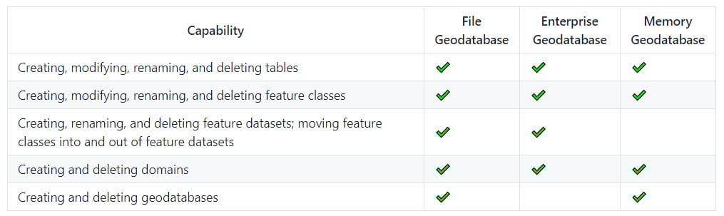

Following on its pre-release at 2.7, the new DDL (Data Definition Language) API for geodatabase schema management is now in full release and supported at 2.8. Traditionally, developers have created geodatabase schema such as feature classes and standalone tables with the SDK by calling geoprocessing tools.
Developers are now able to use the new API to directly create, modify and delete geodatabase schema such as feature classes, tables and their attributes, and feature datasets and file geodatabases.
You can learn more in the ProConcepts DDL document to help you get started on the concepts, and review code snippets of some of the common patterns.
