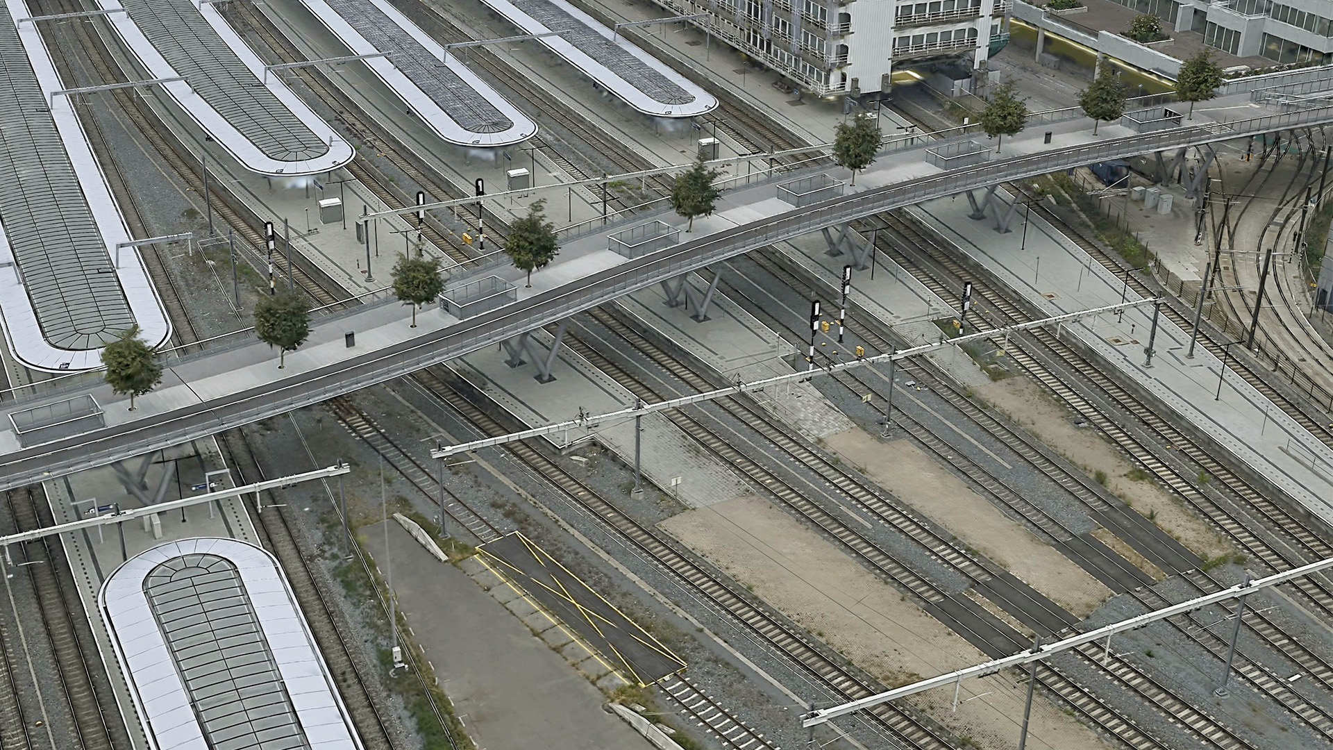

3D visualization of Utrecht central station using Gaussian splat layer.

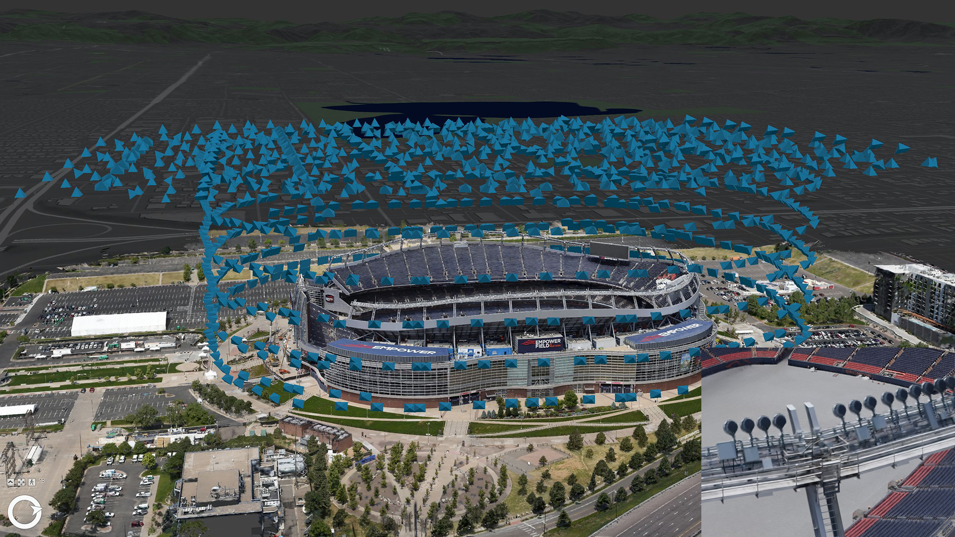

Flight pattern and 3D visualization of Broncos stadium using Gaussian splat layer.
You achieve best results with well-overlapped coverage at different heights, for example, if your structures are very tall. In addition, you will need to pay attention to a suitable ground sampling distance (GSD) to create high fidelity Gaussian splats.
You can use the following flight patterns for your data collection.

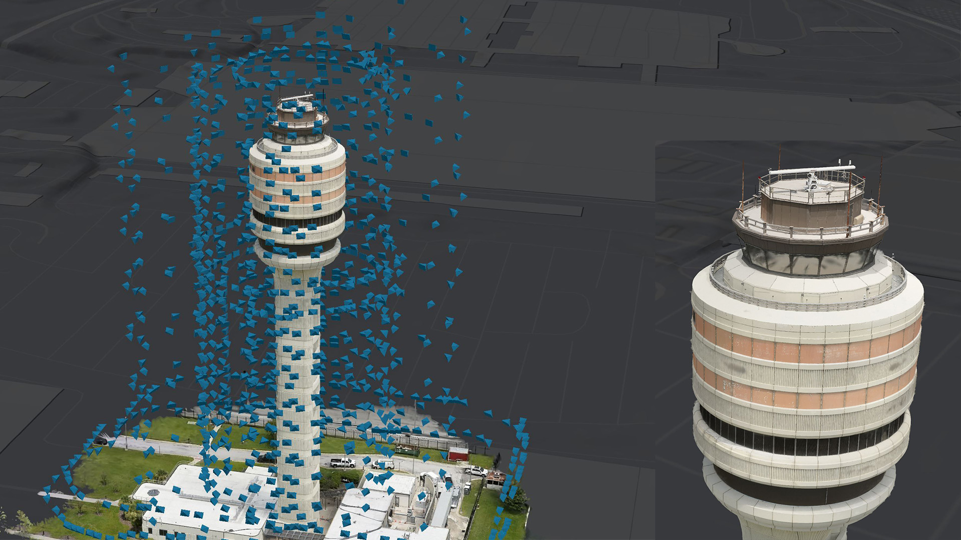

If you want to inspect objects like an air traffic control tower, you can capture your asset using a perimeter flight pattern. Ensure you cover all altitudes with strong image overlap, ideally or above 80% for consistent coverage. You need to fly your drone in circles at varying distances – both close and farther from the tower to add more redundancy. Take nadir (top-down) shots as well, so you capture every side of the structure. If possible, capture portions of the structures that are hidden when viewed from above, such as a roof overhang. Only areas for which you have captured images will be rendered in the results.
Flight pattern and 3D visualization of an air traffic control tower using Gaussian splat layer.

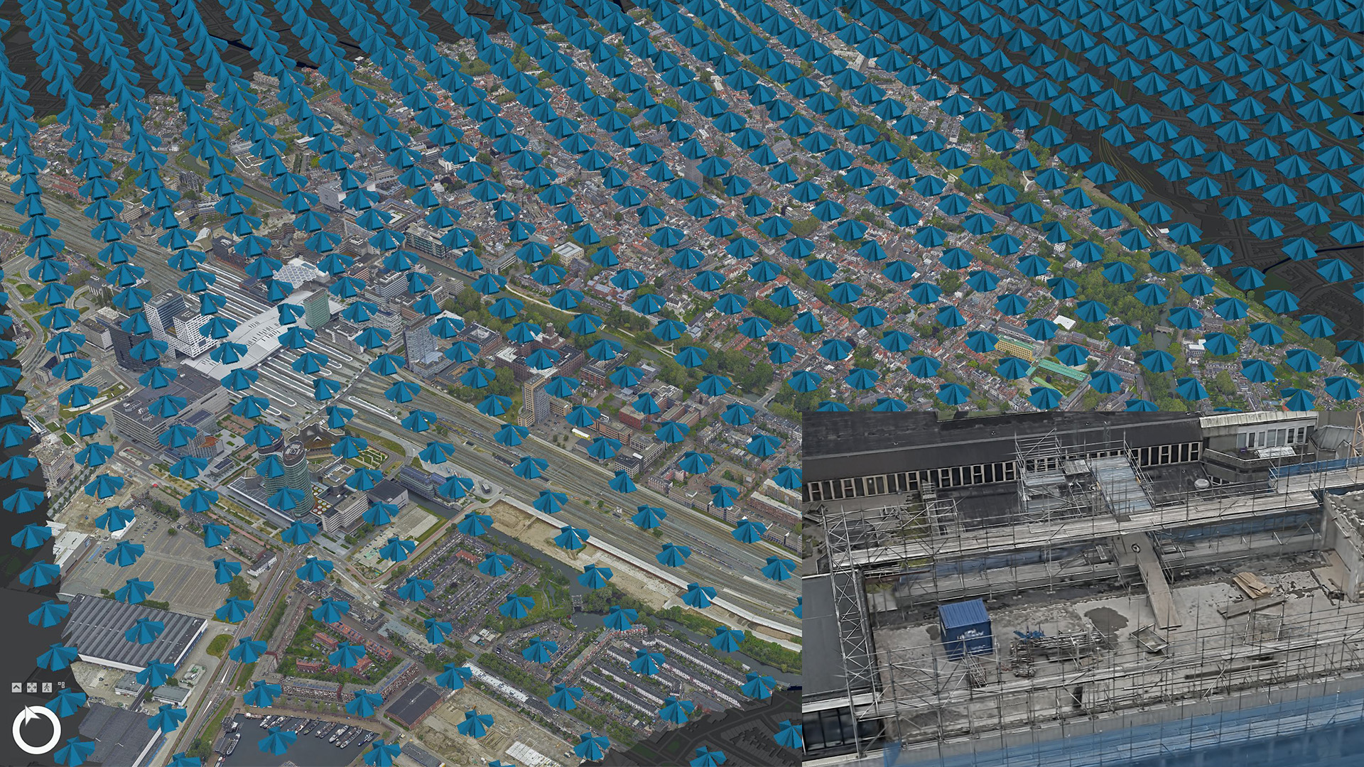

Capture your city or district with a multi-head drone or airborne sensor system. Aim for at least 80% forward and 60% side overlap, and keep your ground sampling distance (GSD) better than 5 cm. This approach ensures you capture fine details in complex buildings and vegetation.
After you have collected your data, you have multiple ArcGIS Reality products you can choose from for your data processing.
Flight pattern and 3D visualization of Utrecht using Gaussian splat layer.

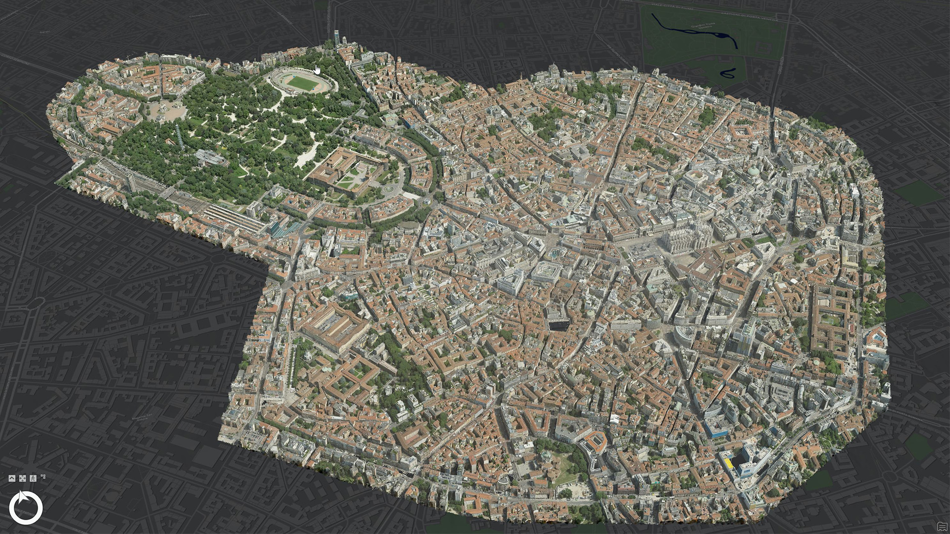

Inspect large datasets
To display large Gaussian splat layers, a level-of-detail approach is used. The data is split into several resolution levels – from a highly detailed version to a progressively simplified one to optimize performance. When visualizing a Gaussian splat dataset in ArcGIS Pro or in the future on the web, the highest details are rendered when you are very close to the layer and less detailed when you zoom out.
After you decided which ArcGIS Reality product is best to process your data, you will have to consider the hardware to use.
3D visualization of Milano using Gaussian splat layer.
