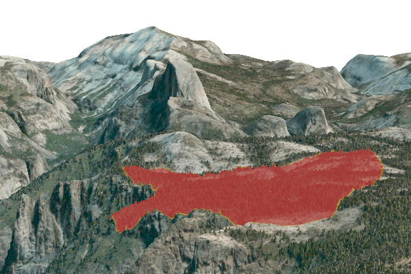

Integrated mesh draping
    At 2.6, draping layers on integrated meshes is now supported. An integrated mesh draws as a 3D layer in the 3D category of a scene. When an integrated mesh layer is added to a scene, it will supersede the ground and basemap of that scene. Any layers that have an elevation property set to on the ground draw on the ground as well as on the integrated mesh. If a layer has an offset applied or is set at a height relative to the ground, that layer will continue to draw based on the ground only.
In the example below you can see a fire perimeter in Yosemite National Park. Draping allows better situational awareness in 3D. Combine 2D and 3D layers to derive more information by better visualizing your operational layers together. Best of all this scene can be authored in ArcGIS Pro and then shared to ArcGIS Online or ArcGIS Enterprise 10.8.1 and shared out to the public.
Polygon draped on integrated mesh

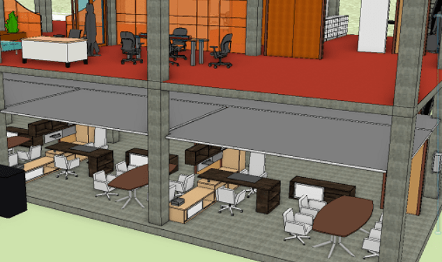

Building Scene Layer enhancements
    Building layers can now be shared with an associated feature layer to ArcGIS Enterprise 10.8.1 with ArcGIS Online support coming in the next release. An associated feature layer unlocks additional capabilities such as attribute table access, editing, dynamic symbology, input to geoprocessing tools and relationship classes.
    Filters have been possible on scene layers but with this release you can now author a filter on a building layer and share the building layer as a web scene layer or scene layer package and the filter is maintained with the scene layer.
    Color and textures are now read driectly from the BIM file workspace and maintained when creating building scene layers. Textures can be enabled on the BIM Options tab by referencing an existing material library.
Building with textures
