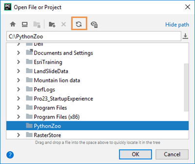

- Click Open (if you’re on a window other than the Welcome screen, click File > Open). Browse to and select your PythonZoo folder and click OK.
A PythonZoo project opens in PyCharm. Like ArcGIS Pro, PyCharm is a project-based work environment. When you open an empty folder, PyCharm automatically adds new configuration files to turn the folder into a Python project. Now, you can start adding scripts to the project.

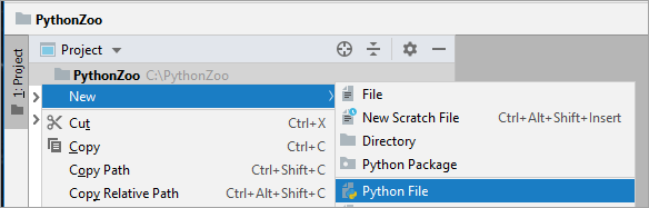

- From the Project folder tree at left, under Project, right-click PythonZoo, hover over New, and choose Python file. Name the file SpeciesID and click OK.
A new editor window opens. Now, you’re working in the SpeciesID.py file within the PythonZoo project. Python scripts have a .py extension, but they are essentially just text files with a special extension that tells the Python interpreter what they are.
