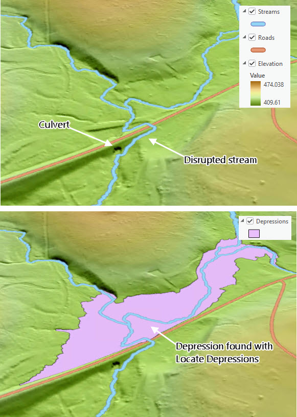

Relationship of culvert to depressions and disrupted streams
Figure 2: A disrupted stream near a culvert (top) and the depression found by running Locate Depressions (bottom).

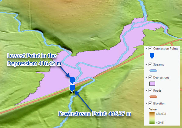

The Maximum Distance to Connection parameter limits how far a depression’s downstream connection can be from the depression itself. It’s the closest cell with an elevation lower than the depression’s lowest elevation cell. This is a possible location where water could flow after entering the depression. If a culvert is present, the lowest elevation point in the depression could be the entrance, and this downstream connection is a possible exit point. The Maximum Distance to Connection parameter tries to capture maximum culvert length.
Downstream connection point for a depression
Figure 3: A depression and its connections points: the lowest elevation point in the depression and downstream point. The downstream point is the closest point with a lower elevation than the lowest point in the depression.

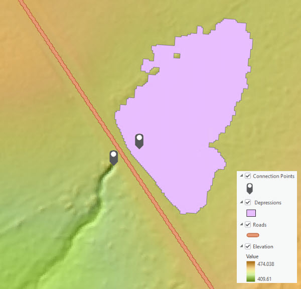

Here are a depression and its connections points created from running the tool on a Pennsylvania study area.
Example output depression and points
Figure 4: An example of the depression polygons and connection points outputs.
Notice that the downstream connection point is directly across the road from the depression. It’s likely there is a culvert at this depression going under the road.

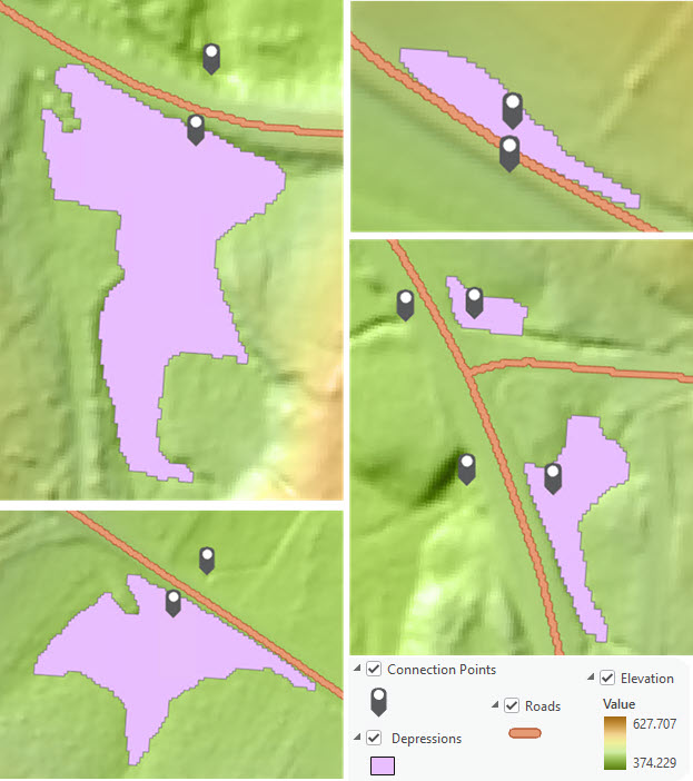

To focus on depressions that follow this patten of being close to roads with a connection point close by. Rerunning the tool with an increased Minimum Area of 40 Square Meters and a decreased Maximum Distance to Connection of 20 Meters can help identify larger depressions with closer connection points.
Examples of output depressions and points
Figure 5: Examples of depressions found with a road nearby and connections points across the road from each other.
Many depressions output from these settings show a similar pattern to the previous example. Indicating that culverts are likely present nearby.
