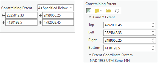

The redesign makes the different ways you can set the extent readily accessible in an icon bar at the top of the control.
Note: Hover over each icon to view information about it.
The extent control as a tool parameter in ArcGIS Pro 3.1 (left) and 3.2 (right)
Like in earlier version of ArcGIS Pro, you will find 4 different extent options in tool parameters: Map Current Display Extent, layer Extent of a Layer, folder Browse, and Reset Reset Extent. The extent control in Envrionment Settings has 2 additional options that will determine the extent at tool run-time: intersect Intersection of Inputs and icon Union of Inputs.
The layer Extent of a Layer drop-down includes all map layers, and a new, Extent of data in all layers option. You can use this option to get the combined extent from all active map layers, excluding the basemap. Use this option to remove some of the guesswork if you want to get an extent that represents multiple layers in your area of interest.
The extent control now displays the Extent Coordinate System under the extent, so you will always know what coordinate system the extent values are drawn from. Extent coordinates can look very different depending on the coordinate system being used. The extent control generally uses the same coordinate system as the active map, except when you folder Browse to an extent. If you folder Browse to the extent of an existing dataset, the control will display the X and Y Extent in that dataset’s coordinate system.

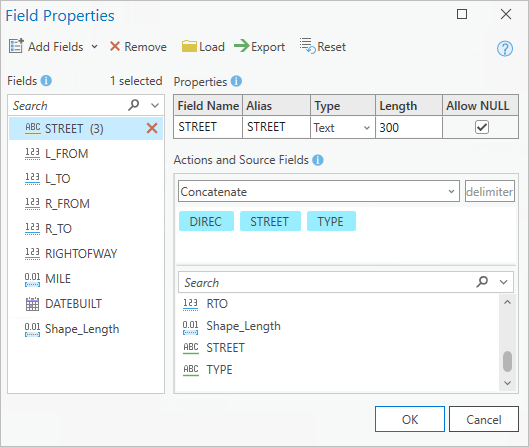

One of the most notable differences from earlier versions of the field map is that field mapping or matching tasks now occur in a separate, Field Properties window. You can access the Field Properties window by clicking the edit Edit button at the top of the control or to the right of a selected (or hovered) field.
Field Properties
Use the Field Properties window to perform field matching and mapping in Pro 3.2
In the Field Properties window, you can view or edit a field’s properties, source fields, and any associated actions (i.e., merge rules) in one place. The new interface displays each source field as a tag that you can add, remove, or reorder. The Merge Rules are now referred to as Actions, which you can use to determine how one or multiple source fields will be transferred to the output or updated field.
