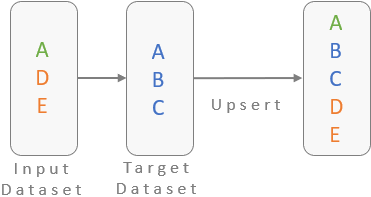

What Is An Upsert Operation?
Upsert is a combination of the words “update” and “insert,” meaning you can upsert a dataset by updating existing records and inserting new rows of data.
Previously, you could only use the Append tool to insert new records from an input dataset to a target dataset. With the new enhancements introduced in ArcGIS Pro 3.1, you can also use Append to update the existing records in your target dataset. This means the Append tool now has the ability to upsert your data.

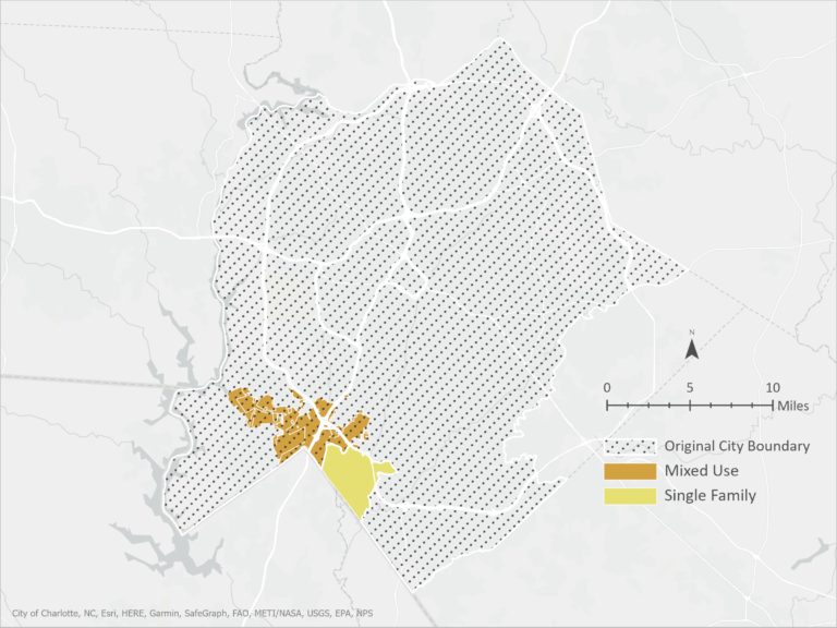

You are a GIS intern for the City of Charlotte, NC, one of the fastest-growing cities in the United States. As the city faces rapid development and growth, your task is to update the city’s zoning data for a forthcoming general plan update.
Since the last update, the city has undergone significant changes. First, an existing industrial area has been rezoned to a mixed-use area. Second, the city plans to annex a previously unincorporated land area into its boundaries for single-family homes.
Your goal is to find a way to easily update the current zoning data and insert the new areas into the city’s zoning map.

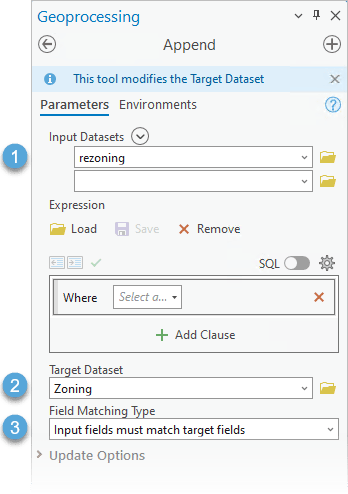

First, let’s use the Append tool to insert the newly incorporated zone into the city:
(1) Add the rezoning data into the Input Dataset
(2) Add the original zoning data to the Target Dataset
Caution: This tool does not create an output dataset; it modifies the target dataset. Take precautions if you are unsure you want to modify your target dataset.
(3) Leave Field Matching Type at the default setting, “Input fields must match target fields,” if the input and target datasets have matching schema and you do not need to reconcile any field differences.

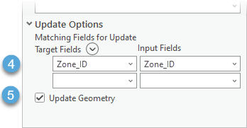

Expand the Update Options dropdown to reveal two new parameters to ensure that your attributes and geometry update when you run the tool.
(4) Use the Matching Fields for Update parameter to update existing records in the target dataset based on matching records in the input dataset. In this example, each zoning polygon has a unique Zone_ID. Therefore, any records from the target with a Zone_ID that matches records in the input dataset will update with values from the input.
Note: You can also match based on multiple matching fields.
(5) Check the Update Geometry parameter to update any changes made to the existing geometry.

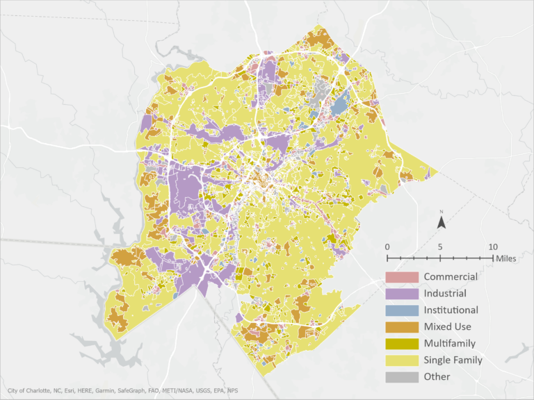

Result: The New Zoning Map
After running the Append tool, the resulting map includes the updated existing zones and the newly incorporated area into the city.
A quick swipe through the old and new zoning maps shows we have successfully used the Append tool to upsert the zoning dataset.
The features where the specified field value, Zone_ID, matched had their geometry and records updated. All other features were appended to the target dataset.
