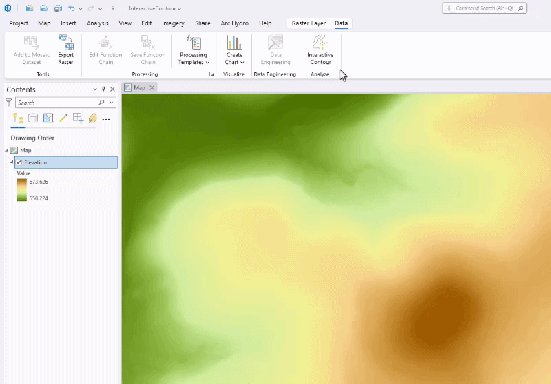

In an active map, select your raster of interest in the Contents pane. This opens the raster’s contextual tabs. Navigate to the contextual Data tab. There you’ll find the Interactive Contour tool in the Analyze group.
Once Interactive Contour is activated, each click on the map creates a contour using the coordinates of where you clicked. Contours are drawn using the screen resolution at the display extent. This allows for rapid response time even on very large input rasters. Internally, the tool leverages the Contour and Contour List geoprocessing tools.
