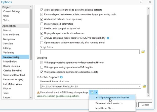

Option 1: Upgrade through ArcGIS Pro > Settings
Pro 3.0 backstage
Opening the Pro 3.0 backstage

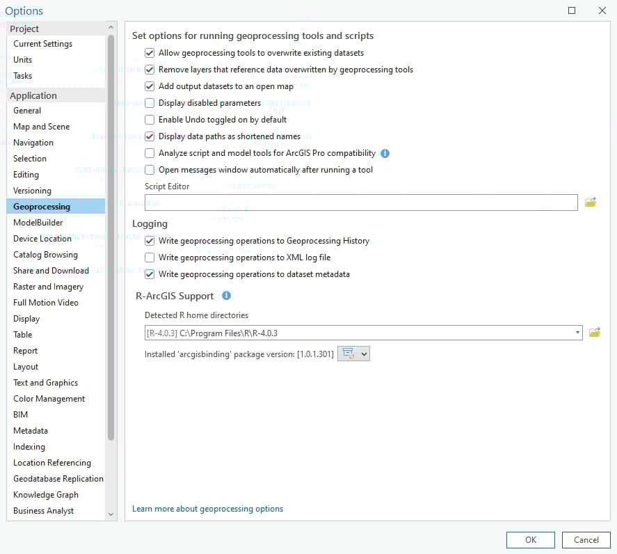

After opening the Pro 3.0 backstage, go to the ‘Settings’ tab on the left hand side. Then choose Options > Geoprocessing. Under the R-ArcGIS Support section, click on the icon and select ‘Install package from the Internet’.
Installing arcgisbinding from ArcGIS Pro > Settings > Options > Geoprocessing > R-ArcGIS Support

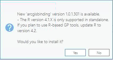

Installation message for arcgisbinding 301
Upgrading to arcgisbinding version 301 for R version 4.0.X and 4.1.X.

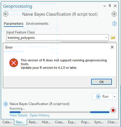

If you still try to run a R-based geoprocessing tool on an unsupported version of R, the first time there will be a pop-up error message that will advise you to upgrade to another R version in which this functionality is supported, as shown in the screenshot below.
Error message when using R script tool
Running a R-based geoprocessing tool for the first time will trigger a pop-up window with an error message if using R versions 4.0.X or 4.1.X.

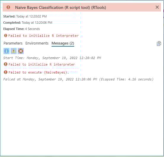

This error message will only be shown once, and subsequent attempts of running a R-based geoprocessing tool will result in a runtime error.
Runtime error
Subsequent runs will throw a runtime error.
