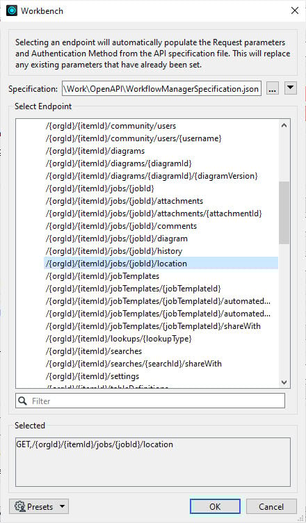

  1. Data Interoperability is no-code technology, but you can still work with web API calls using the HTTPCaller transformer.  The transformer now supports the import of OpenAPI Specification (aka ‘Swagger’) files (JSON or YAML), allowing the transformer to pre-populate request parameter and authentication method settings.
Here is an example using the swagger file for ArcGIS Online Workflow Manager; first import the specification file using the Import button (you need to obtain the file from Esri):
Then choose an endpoint, in my case to GET the location of a job:

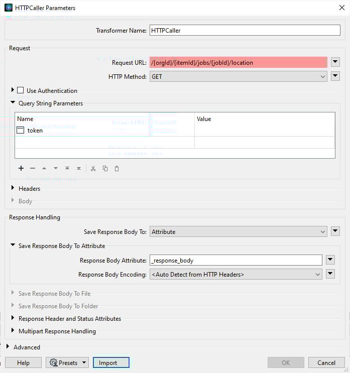

Then the transformer knows I need to supply a token plus URL path values for orgId, itemId and jobId:
I would also need to build the base domain part for my hosted Workflow Manager instance, but you get the idea.  If there was a more complex authentication and header requirement for the API the automation would stub these out for me, but in this case it’s just a token.

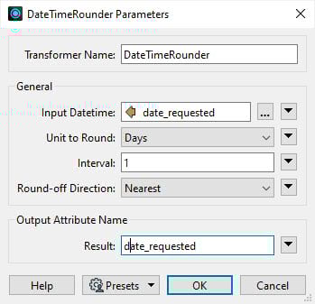

3. DateTimeRounder is new transformer now available.  Its need is explained in a few workflows.  First, binning data into time intervals, and secondly when doing change detection.  The ChangeDetector transformer is brutally strict about comparisons, so when you’re comparing streams from different systems of record, like geodatabase and feature service, and one stores datetimes in milliseconds while the other uses microseconds, then even with identical datetimes you’ll get ‘fake change’ detected, caused by precision, unless you round to a common interval.  Here is a simple example of rounding a datetime to the nearest whole day, expressed in ISO format: 2022-01-01T08:00:00 rounds to 2022-01-01T00:00:00 and overwrites the subject fields with these transformer settings:

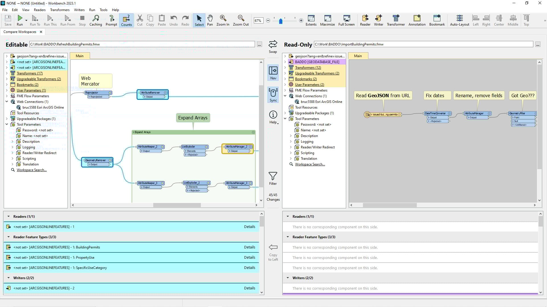

6. Compare Workspaces is a new tool.  From Workbench, in the Tools menu, select Compare Workspaces and select your editable and read-only FMW files:
Then an experience opens where you can migrate differences from the read-only to the editable workspace.

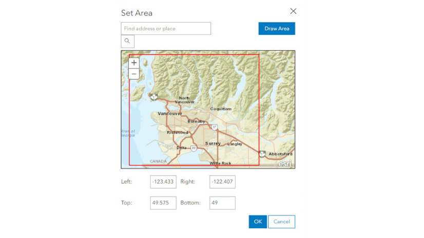

7. One of my favorite transformers is the Geocoder.  Strictly speaking as it’s a package it isn’t part of the 3.2 release, but I want to call it out.  Geocoder now supports locator views, where you can specify the geocode match type and allowed extent for Online or Enterprise geocode services, a huge quality improvement.  Here is the extent setting for one of mine, limiting World geocode service matches to Vancouver, Canada city limits:
