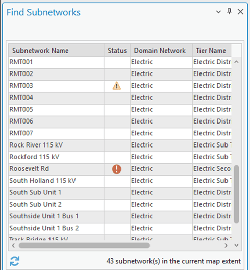

Invalid subnetwork status
Another consistent piece of feedback we’ve received from customers are requests for the ability to differentiate between subnetworks that are dirty and need to be updated as opposed to a subnetwork that failed to update and remains dirty.
To address this, in ArcGIS Pro 3.1 we have implemented a new ‘Invalid’ subnetwork status.  Now, if an update subnetwork operation fails due to the discovery of a subnetwork error or dirty area, we will mark the subnetwork as Invalid. You will be able to immediately see which subnetworks are invalid in the Find Subnetworks pane through the display of a new red icon next to them in the grid.
The Find Subnetworks pane displays invalid subnetworks with a red icon.
The Update Subnetwork tool will also exclude invalid subnetworks from the list when you choose to update all subnetworks in a tier and prevents the subnetwork from populating the drop-down list when selecting subnetworks for update in the tool. Because invalid subnetworks are now be ignored by the update subnetwork operation, the subnetwork must first be made dirty through editing and validation (hopefully correcting all the errors!) before the subnetwork can be updated again and marked as clean.

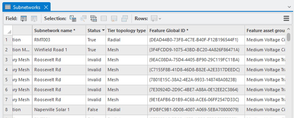

If you want to know where we store this information, you can find it in the Is Dirty field in both the Subnetworks table and Find Subnetworks pane.  This field is now aliased to Status to indicate it is no longer a binary value.
The Is Dirty field in both the Subnetworks table and Find Subnetworks pane has been aliased to 'Status to indicate the subnetwork status is no longer a binary value.

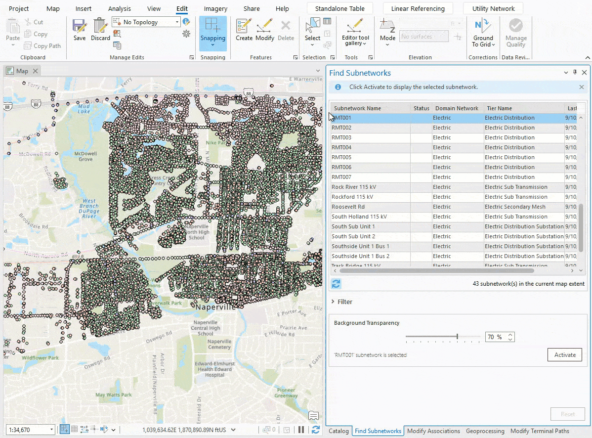

We have made several improvements to the Find Subnetworks pane.  First, we’ve implemented one of the most commonly requested items from working within the pane:  the contents of the pane are now sorted using the Subnetwork Name column which make it much easier to locate the subnetwork is question through scrolling, without the need to filter.
We have also made changes to the way that the Find Subnetworks pane runs trace and update subnetwork operations.  These operations now run directly against the utility network dataset instead of going through the geoprocessing framework. The benefit of this approach is that it allows the operations to run much quicker. The downside to this change is that subnetwork trace and update operations that are run from the pane will no longer create geoprocessing history.
Running a trace operation using the Find Subnetworks pane to bypass the geoprocessing framework.
