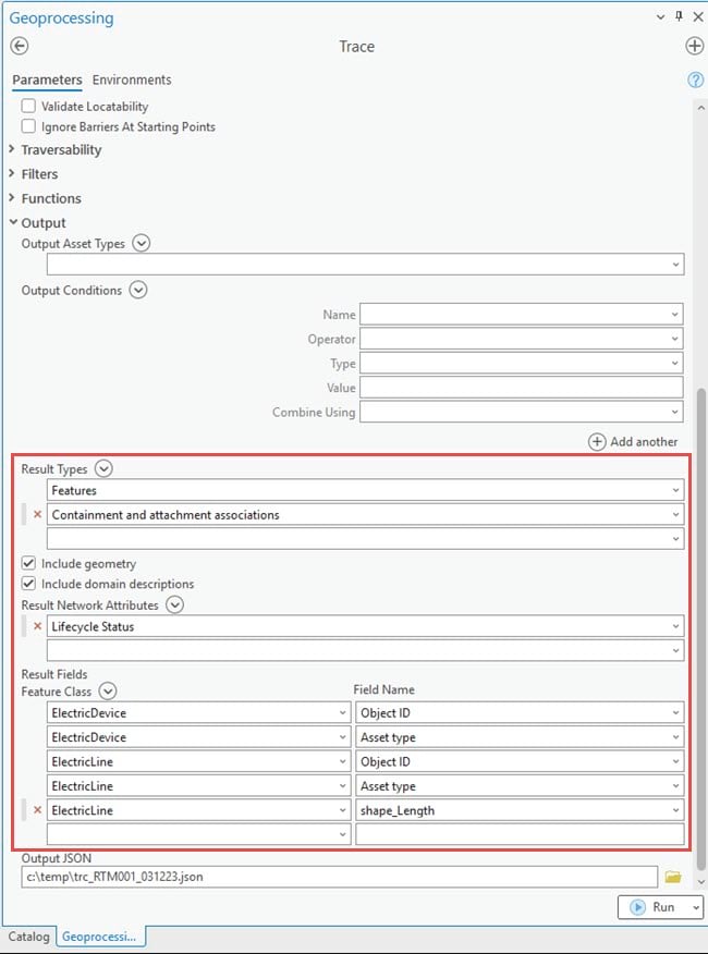

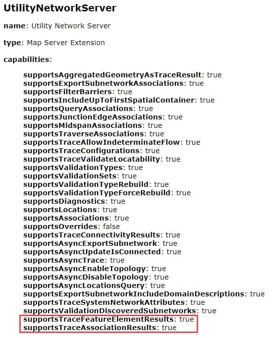

When working with Enterprise, the introduction of two new capabilities, supportsTraceFeatureElementResults and supportsTraceAssociationResults enables two new Result Types options to export feature and containment and attachment association information for trace results to an output .json file.
Two new capabilities, supportsTraceFeatureElementResults and supportsTraceAssociationResults enables new Result Types options to export feature and containment and attachment association information for trace results to an output .json file.
In case you aren’t already familiar with what these result types do, the Features result type allows you to include additional information such as the feature geometry, network attribute information, and attribute values in the trace output for use with other applications. The Containment and attachment associations result type enables you to return the containment and attachment associations for the network features traversed by the trace.
An example of the Trace geoprocessing tool displaying the new Result Types options for Features and Containment and attachment associations and their enabled parameters.

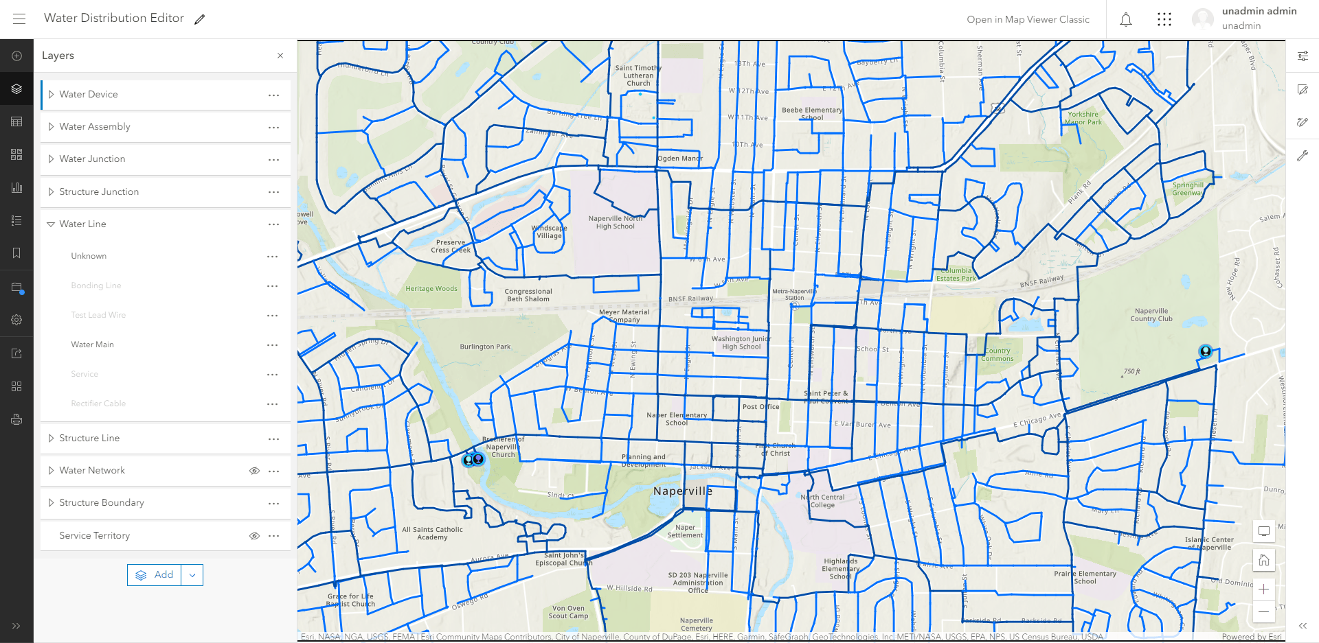

Subtype group layers
Subtype group layers have always played an important role in the configuration and deployment of the utility network. While these were originally restricted to ArcGIS Pro and available only to desktop users; as of ArcGIS Enterprise 11.1 and the 2023 Network Management release, the use of subtype group layers it is now supported across the entire platform. Below you will find the list of when these capabilities were added:
  • ArcGIS Enterprise Web Maps 10.9.1
  • ArcGIS Runtime 100.9 (August 2020)
  • ArcGIS Field Maps (June 2022)
  • Maps SDK for JavaScript 4.25 (November 2022)
  • ArcGIS Enterprise Map Viewer 11.1
Picture of a web map from arcgis enterprise with subtype group layers visible in the table of contents

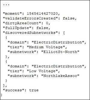

Starting with ArcGIS Enterprise 11.1, the response from the validateNetworkTopology operation returns a new property (discoveredSubnetworks) which includes the name of any subnetwork that is marked as dirty during the validate operation along with its associated domain network and tier.   This functionality is enabled through the introduction of the supportsValidationDiscoveredSubnetworks capability.
This can be helpful to report a targeted list of subnetworks for update or another quality assurance workflow.  An exception to be aware of when working with this functionality is encountered when working with hierarchical networks in cases where all subnetworks in a tier are dirty.  In this scenario, the tier is not traced during the validate operation and any dirty subnetworks in the tier are not returned in the collection of discovered subnetworks.
validateNetworkTopology returns a list of subnetworks made dirty by the validate operation.
