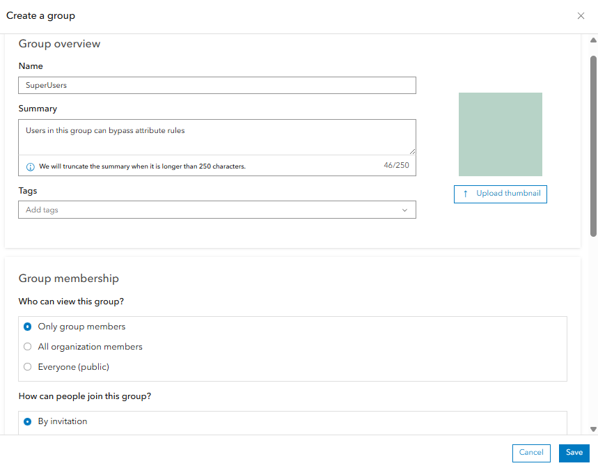

This approach is similar to the previous one but is more flexible. The administrator creates a special group in ArcGIS Enterprise, and users assigned to this group can bypass attribute rules. Then, we add an Arcade condition to check for that group in all attribute rules that need to be bypassed. Let us create the group.
Log in to the Enterprise portal as an admin, navigate to Groups, create a new group, give it a name, and make sure it is invitation-only. You don’t want any users joining this group on their own.

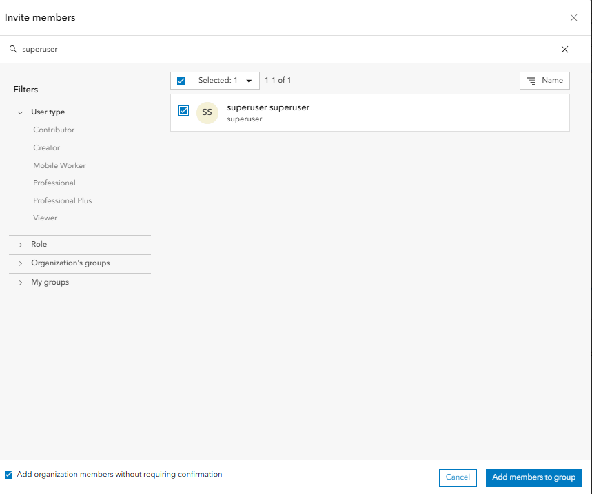

Then, as the admin, assign the users who need to bypass Attribute Rules to this group. You can assign the group when the rule needs to be disabled and revoke it when the task is completed.
