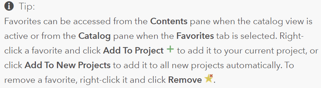

The short answer to these questions is that you will want to work with project favorites in ArcGIS Pro.  Connections to folders, databases, servers, toolboxes, and other items can be added to your favorites collection, making them readily available for use without having to browse to them.  Optionally, you can designate a favorite item to be added to all new projects automatically.

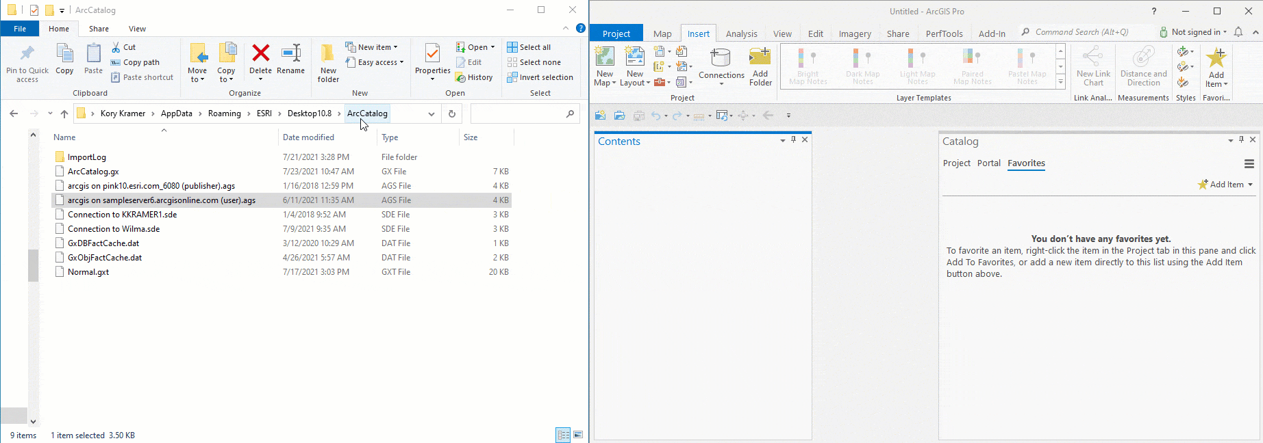

The database and server connection files (.sde and .ags files) created in ArcGIS Desktop are generally stored in the following location:
C:\Users\<user_name>\AppData\Roaming\ESRI\Desktop10.x\ArcCatalog
To make these available in ArcGIS Pro, browse to that folder in Windows File Explorer, select the files you want to add to ArcGIS Pro, and drag/drop them into your Favorites in either the Catalog pane or Catalog view.
Drag .ags and .sde connections from Windows File Explorer into Favorites in either the Catalog pane or Catalog view

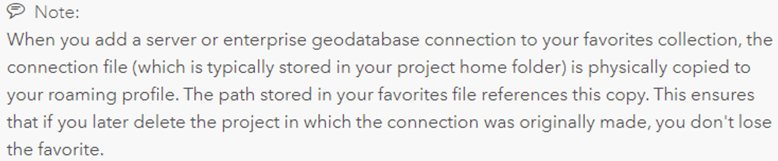

Note that connection files are physically copied to your roaming profile.

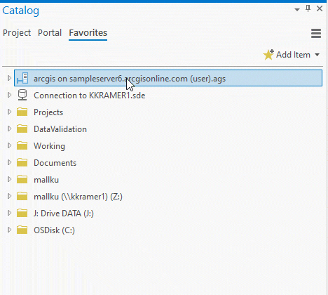

For ArcGIS Desktop folder connections, the easiest way to make these available in ArcGIS Pro is to go to ArcCatalog, highlight the desired folder connections, and drag/drop them into your Favorites in either the Catalog pane or Catalog view.
Drag and drop folder connections directly from ArcCatalog into your Favorites in either the Catalog pane or Catalog view.

To add any favorite item to new projects by default, right-click the favorite and select Add To New Projects. In the following example, I choose to add a server connection, a database connection, and two folder connections to new projects.

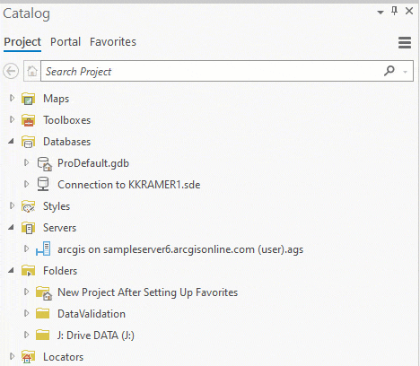

Now when I open an untitled project or create a new project, not only are my database, server, and folder connections automatically added to that project, but the rest of my favorites are also readily available without having to browse.
Favorites are now available in new projects.
