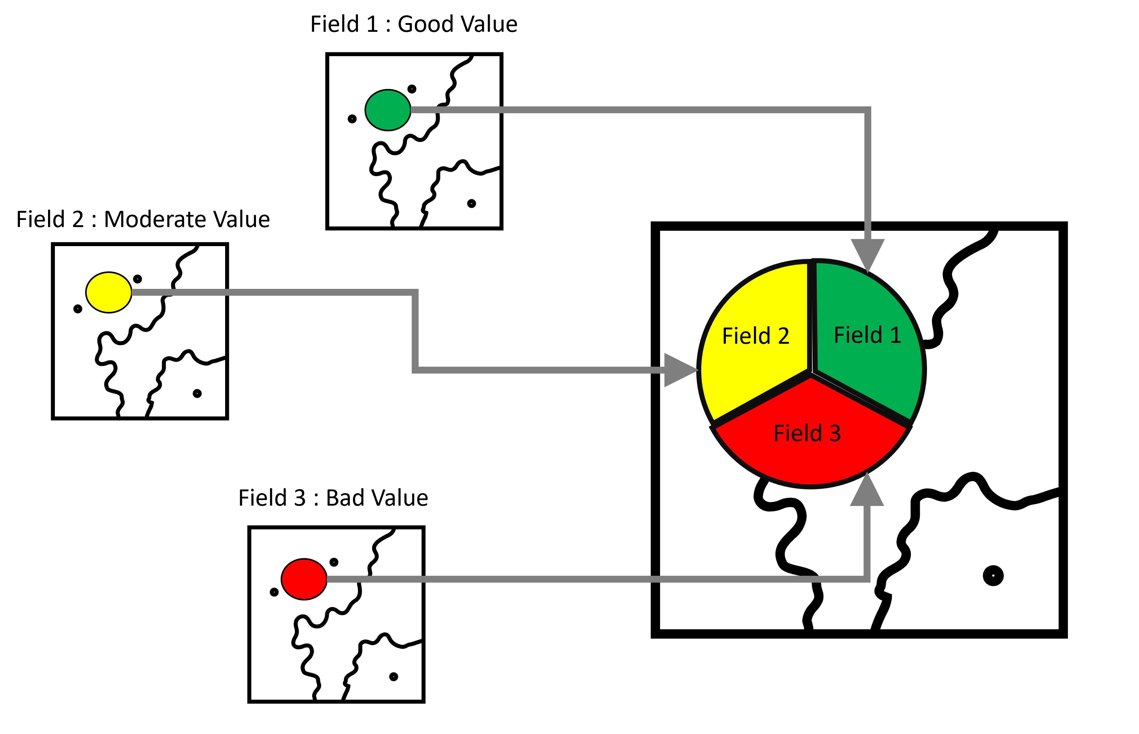

Organizations need to understand the overall status of an event, office, base, or sensor location. Each one of these locations may have multiple attributes that describe it. This is where dictionary styles come into play. A dictionary renderer uses a dictionary style along with attributes from your data to dynamically generate information rich symbols.
The Status Indicator Symbology dictionary styles can be used to configure layers with a dictionary renderer in ArcGIS Pro. When a user configures the fields in their layer that should be used by the style, the dictionary renderer will automatically generate multi-faceted status symbols in the map.

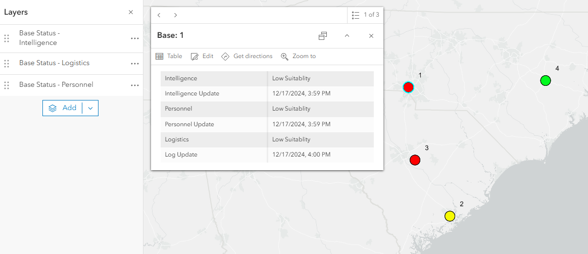

The map below displays base locations and their status for intelligence using a unique value renderer. In the pop-up, there are three fields (intelligence, personnel, logistics) that contain a status value (low, moderate, high suitability). To get the information on the other status fields, a user would need to interact with the map, whether by clicking and seeing a pop-up, or, creating multiple copies of the layer with the other fields driving the symbology.

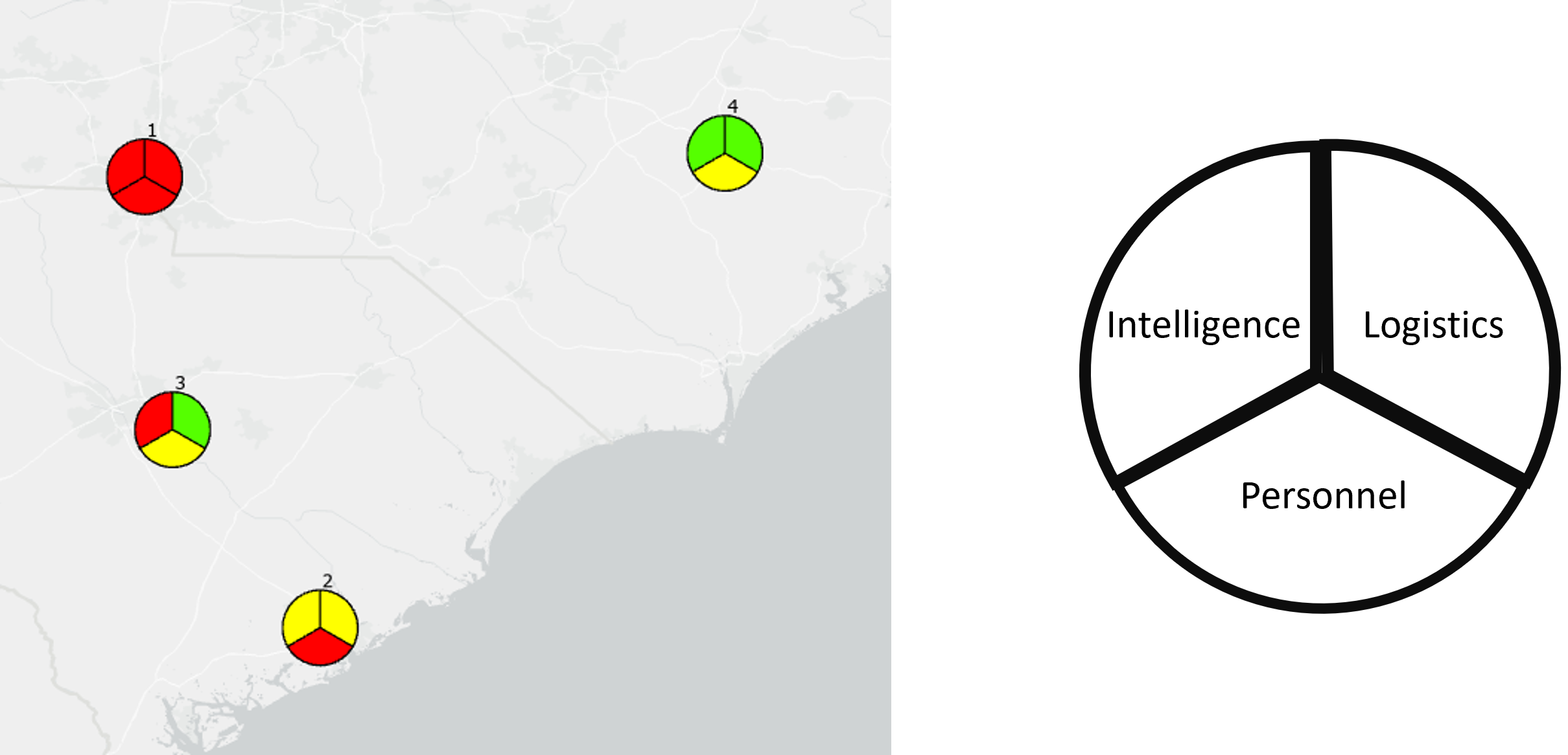

The Status Indicator Symbology allows the user to map those fields to different portions of a symbol, streamlining the visual so that map interaction wouldn’t be needed.

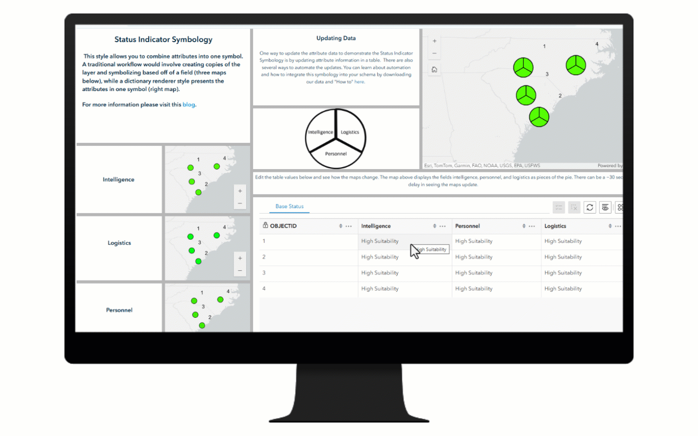

We have created a sample web application to demonstrate the Status Indicator Symbology and how it compares to mapping single variables. In the application, edit the table values and see how the pie chart and map icons change.

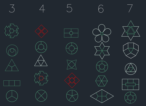

The example above displays a three field symbol, but we have created the Status Indicator Symbology style files to support up to seven fields, with five customizations of each symbol.
