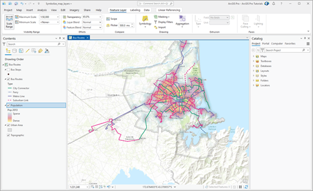

The first time you open any new software, you may feel both excited and overwhelmed. Many users feel excited to explore the capabilities of this newly available tool—but they may also experience uncertainty when faced with its unfamiliar interface. ArcGIS Pro is no different. Its interface is made up of three main components: Ribbon, Panes and Views.  To learn more about the components in depth, please visit the following: Ribbon, Pane and View Management Improvements in ArcGIS Pro Blog.

It might be tempting to explore on your own, but the ArcGIS Pro quick-start tutorials can save you time. These beginner-friendly lessons help introduce you to key aspects of ArcGIS Pro. They are designed to cover fundamental workflows such as authoring a map, editing data, and sharing maps and layers to ArcGIS Online.
I recommend starting with the “Introducing ArcGIS Pro” tutorial; this provides insight into the layout of the application. You’ll explore the main components of the ArcGIS Pro user interface—the Ribbon, Views, and Panes — and learn about the contextual nature of ribbon tabs. For example, if you are going to start editing data, new tabs and menu options will appear on the ribbon.

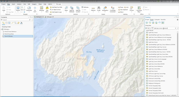

3. Got Data?
Once you have installed the software, and have a basic understanding of the interface, I recommend learning more about adding data. Data can be added to an ArcGIS Pro project from various sources, including your local computer, local network, and from your ArcGIS Online or ArcGIS Enterprise portal. When creating your first map, start with a manageable and familiar data source such as a spreadsheet of local addresses or a basic map. If you do not have your own data, you can access ready-to-use datasets from ArcGIS Living Atlas of the World. For more information about the Living Atlas data, please visit the following; Living Atlas Data at Your Fingertips in ArcGIS Pro.  The important thing is that you get familiar with the subject of the data so that you can use it to start navigating through ArcGIS Pro.
Learn more about Data in ArcGIS Pro.

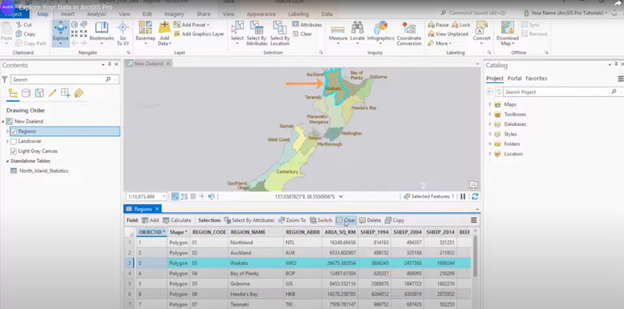

4. Explore Your Data
Keep your learning going by understanding the relationship between spatial and attribute data, as this is essential for effectively using ArcGIS Pro. Spatial data is represented as map layers, while attribute data provides the descriptive information behind those layers, in tabular form. These two components work together, allowing attributes to enable querying, symbology, and analysis of spatial features to uncover geographic patterns and relationships.
Before you can tell a compelling story with a map, you must first understand the language of your data. The initial and most critical phase of any mapping project involves a deep dive into the raw information to uncover patterns, assess data quality, and extract meaningful insights. The following tutorial is focused squarely on this foundational stage. You will learn how to interact with your data by querying attributes and summarizing table values—essential skills that allow you to understand your data’s potential before you begin the cartographic design process.
Learn more about: Explore data
