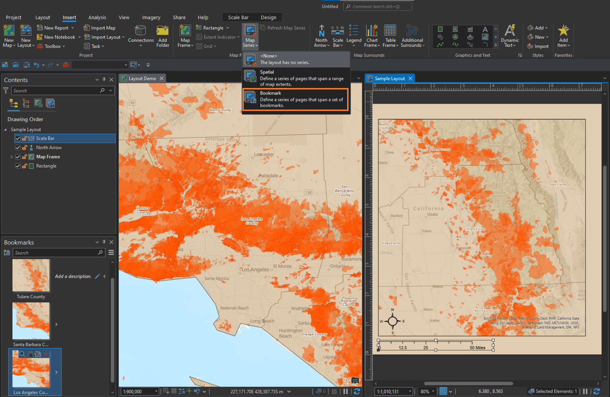

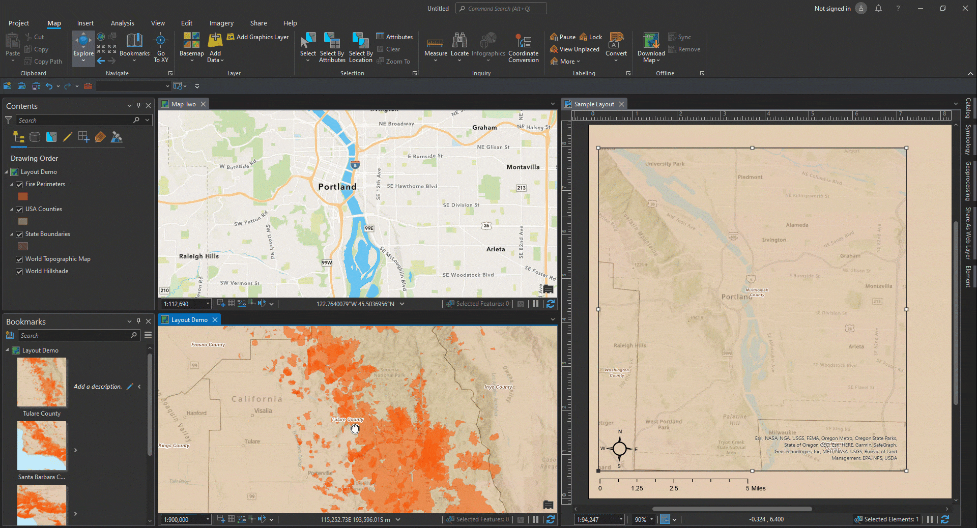

Bookmark map series
Did you know that you can create a map series from bookmarks in your project? It’s really easy. When you have bookmarks in your project, make sure that your layout view has focus, and in the Insert tab choose Bookmark from the Map Series dropdown. This is a great way to start exploring how to work with map series.
Create a bookmark map series in ArcGIS Pro

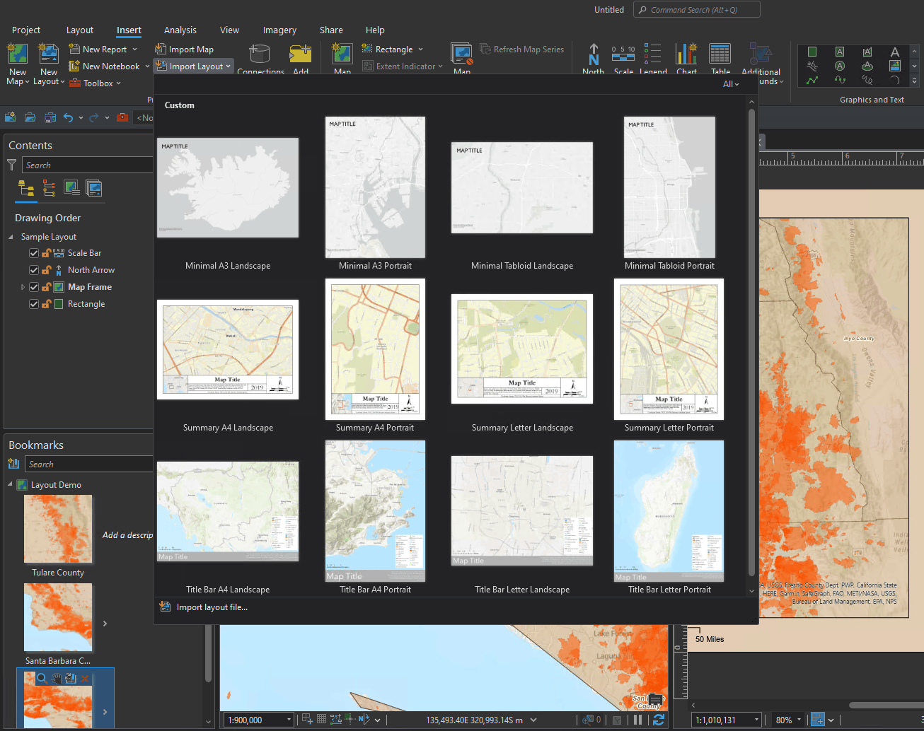

Deploy custom layouts to your organization
It is possible to create a layout from a template by going to Import Layout and choosing from the pre-installed templates. By default, this gallery contains preconstructed layout files from a folder installed with the application. You can customize the gallery by adding your own layout files to this folder.
Use a template to start your layout
You can also customize the Import gallery path, and even define it by managing application settings. This allows administrators to deploy a standard set of custom layout templates to all ArcGIS Pro users in their organization.

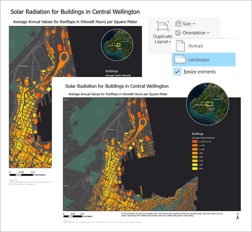

Duplicate Layout and resize elements
Introduced in ArcGIS Pro 3.1 (February 2023), when you change the page size or orientation of a layout, you can automatically resize and reposition layout elements. Additionally, the new Duplicate Layout command creates a new layout at a different page size from an existing layout. All layout elements are preserved and can be automatically resized and repositioned.
A layout orientation is changed from portrait to landscape with automatic resizing and repositioning of elements

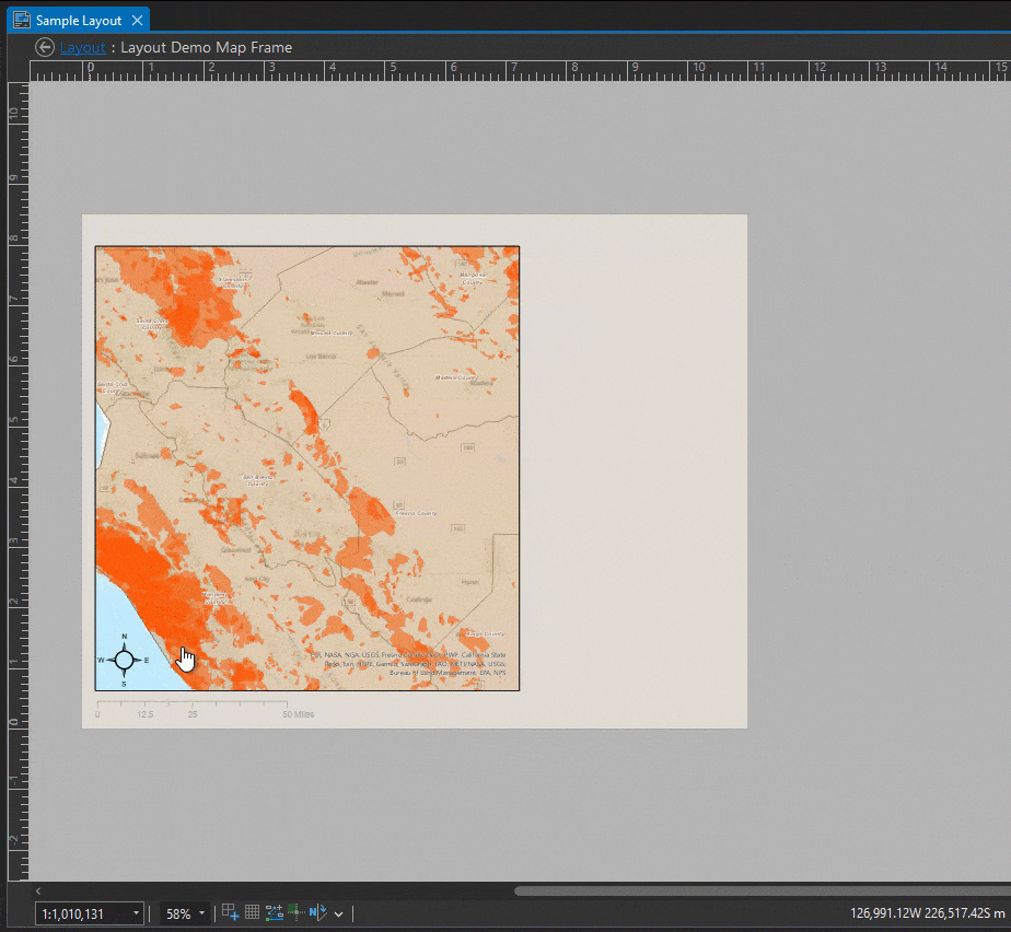

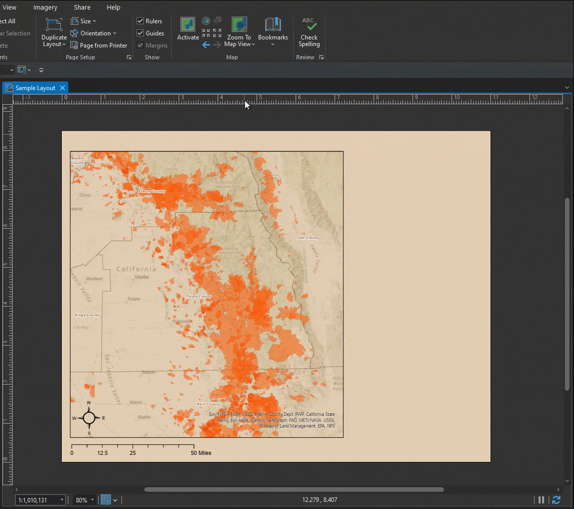

Keyboard shortcuts
Shortcuts are always handy, especially for repetitive tasks that would otherwise require a lot of mouse movement. There are a number of pre-defined keyboard shortcuts for working on the layout but one of the most powerful is holding the 1 key to zoom and pan the layout page while a map frame is activated (what’s an activated map frame?). Let’s see this in action.
When a map frame is activated, hold the 1 key to pan and zoom the layout page

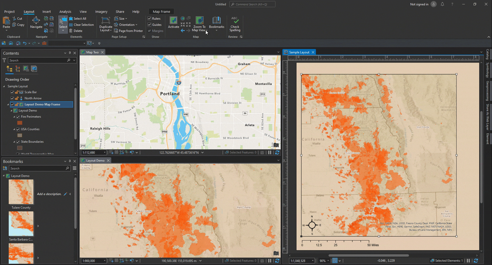

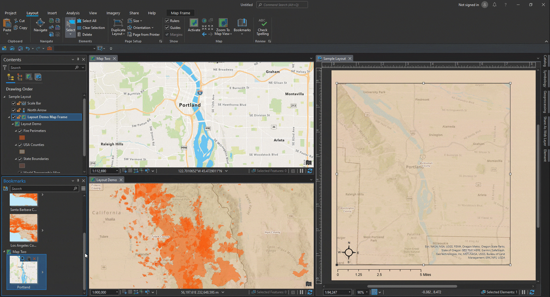

Syncing a map frame’s extent with a map view’s extent
If you’re used to navigating in a map and having your layout’s extent “follow along,” these tips for you! ArcGIS Pro projects can contain multiple maps and layouts; any layout can contain multiple map frames pointing to the same or different maps. This allows you to have a LOT of control over what your layout is showing in relation to map views but it can get complicated. Here are three ways to control syncing a map frame’s extent with the extent of any map or bookmark in the project:
1. Right-click the map frame and use the Zoom to Last Active Map button to update the map frame’s extent to match that of the last map view you interacted with.
2. Use the Zoom to Map View gallery to adjust the map frame extent to match any open map view in the project. In the example below, I have two open map views and can sync my map frame extent with either of those.
3. With your layout view in focus, use the Bookmarks gallery to navigate to any bookmark in the project.

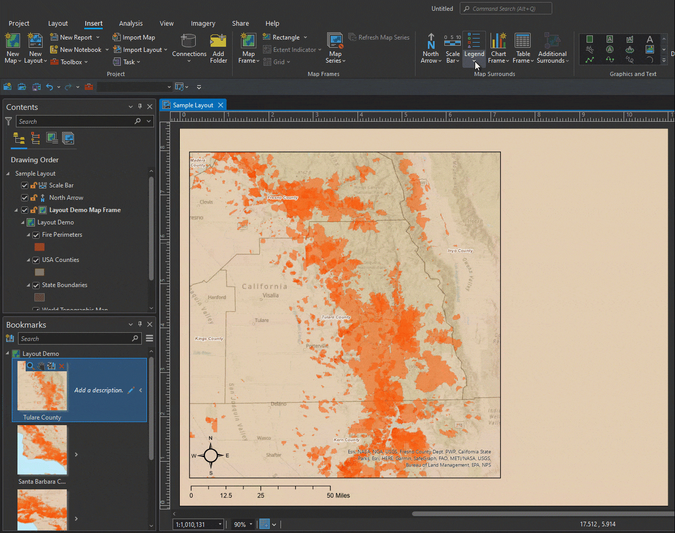

Selectively include layers when adding a legend
I think this one is a hidden gem. When you add a legend to your layout, if no layers are selected in the Contents pane, the legend is added containing all applicable layers from the map contained in the default map frame. If you only want certain layers included in the legend, select those in the Contents pane and then add the legend.
Only layers selected in the Contents pane will be included when adding a legend
