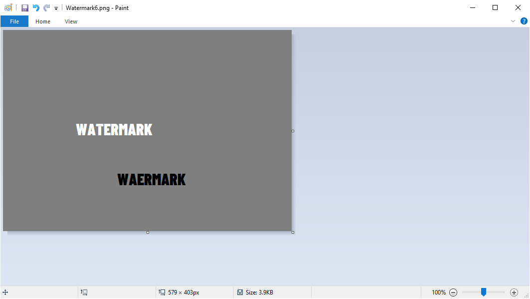

I’ll show you how to make a simple watermark graphic in Paint!
Or, if you are feeling ambitious, PowerPoint!

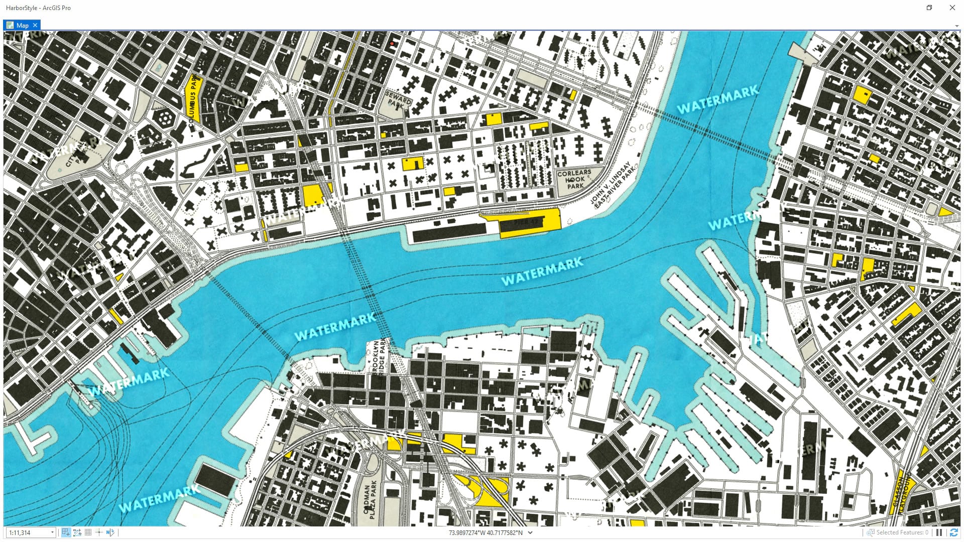

No need to call up a graphic designer or feel intimidated by making a graphic with transparency and stuff (though that is a noble pursuit). No problem! Blend modes in ArcGIS Pro can handle all that. Here’s how to make a simple graphic and add it as a repeating watermark graphic to Pro, my somewhat-protective map-making friends!
0:00 A setup for watermarks
0:44 How to make a watermark graphic in Paint.
2:20 Adding in the trusty Global Background layer from Living Atlas to Pro
3:00 Applying a repeating picture fill to the global background
3:36 Using the “overlay” blend mode to blend the watermark into our map
4:18 Giving the watermark pattern an angle, like the pros do!
4:41 Tweaking the watermark density with less background area
5:03 How to get light AND dark watermarks
6:12 What about making a graphic in PowerPoint? Awwww yeahhhhh.
