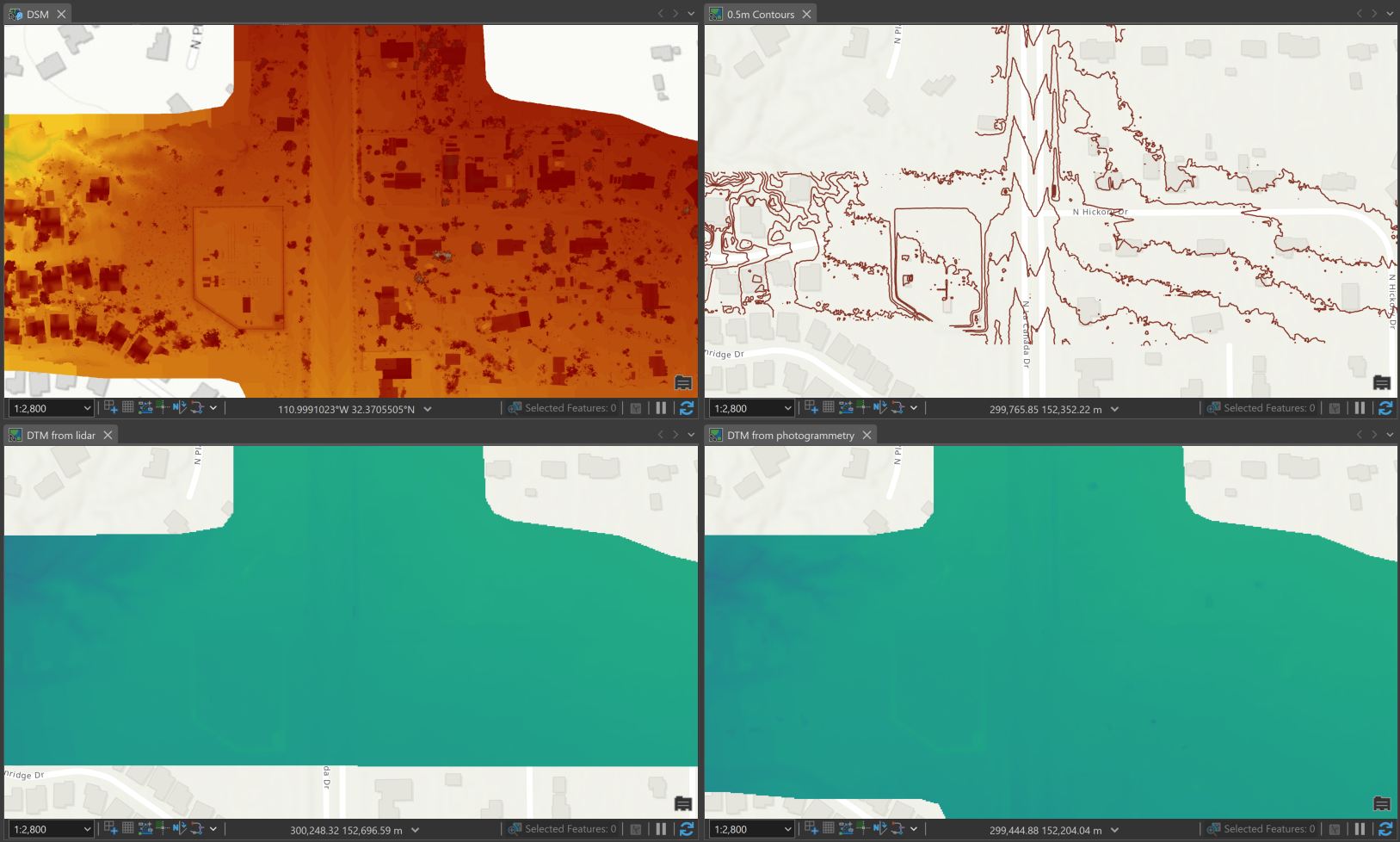

DSM (top left), 0.5m Contours (top right), DTM from lidar (bottom left), DTM from photogrammetry (bottom right)
