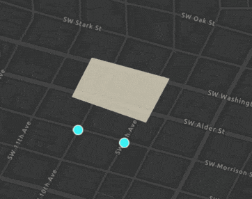

Geofence - notifications as vehicles enter a restricted area
I have used a stream service that simulates two vehicles moving along streets in Portland, Oregon. The sample code, data, and ArcGIS Pro project can be accessed from https://arcg.is/0jH09i.
