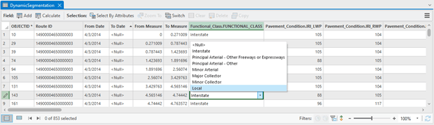

Editable Dynamic Segmentation
The Dynamic Segmentation tool allows you to dynamically segment multiple LRS events and visualize them in the map and in a table. The table is editable, allowing you to edit the attributes in the fields within the table. The resulting changes from those edits will be stored in the LRS event record(s) that contributed to the dynamic segmentation and are reflected in the updated dynamic segmentation table.

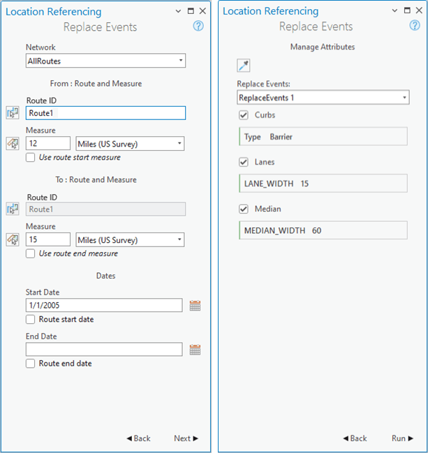

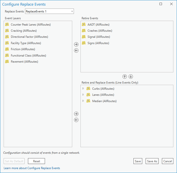

Event Replacement
The event replacement tool allows you to configure multiple LRS event layers that can be either retired or retired then replaced when a road is updated without a change in measure or geometry, such as during a repaving or widening project. Events configured to retire will retire if they’re located within the section of road being replaced. Events configured to retire and replace will be retired on the date of the replacement and a new record (with updated attributes) will be created.

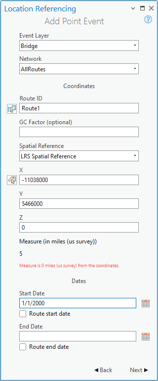

Coordinate and Intersection Offset input methods
GIS professionals are responsible for getting event data (which can be in a variety of formats) into ArcGIS Roads and Highways. While route and measure may be the most common format, this data can also come in as coordinates or as offset from other features like intersections. The Add Point and Line Event tools in ArcGIS Pro have been enhanced to support these additional input methods for new event data coming into the LRS.

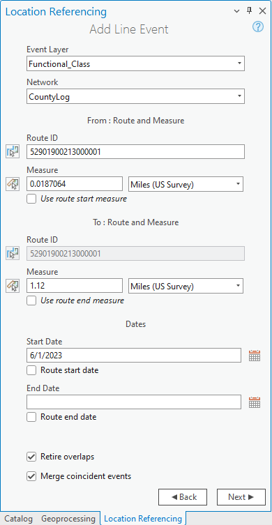

Retire Overlaps and Merge Coincident options
The Add Line Event tools have been enhanced to support options to retire overlaps and merge coincident events. Retire Overlaps will automatically retire existing events that would overlap in time and location with any newly added event created by the tool. Merge Coincident will consider any adjacent events that share the same attributes as the event being added and will automatically merge them into a single event to prevent unnecessary segmentation of event data.

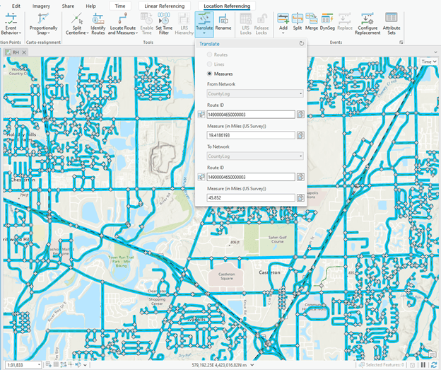

Translate tool
The new translate tool allows you to quickly translate measures between routes that are coincident or intersections within any LRS Network.  Additionally, if utilizing a line network, the tool will support translating between RouteID and Route Name or LineID and Line Name fields.

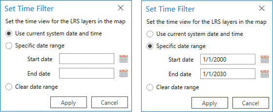

Set Time Filter
If you don’t need to take advantage of all the ArcGIS Pro time capabilities on the Time ribbon, the Set Time Filter tool on the Location Referencing ribbon allows for easy configuration of the time view of LRS layers in the map. You can set the time on the map to a specific date (including the current date) as well as any range of time.
