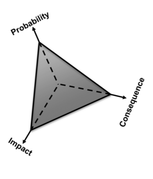

Fire agencies that seek accreditation must complete an all-hazard risk assessment to identify, assess, categorize, and classify risks within their jurisdiction. Two approaches commonly used to complete this analysis are the two-axis method and the three-axis method. The two-axis method evaluates the probability of an incident occurring and the consequence that incident would have on a community. The three-axis method adds a valuable third parameter—impact—that evaluates the relative risk of each incident. Together, these three parameters form a triangular pyramid, or tetrahedron.
The three-axis method evaluates probability, consequence, and impact of an incident.

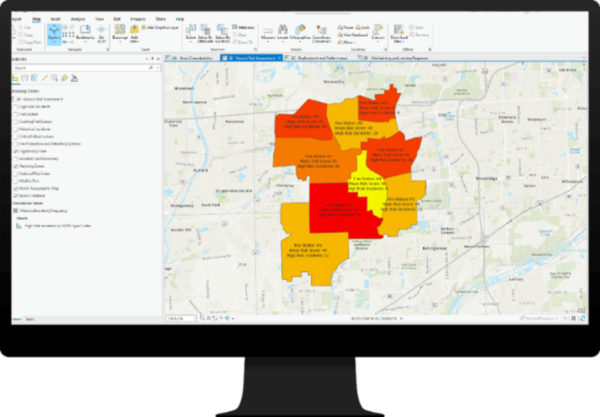

After you have each incident’s total risk score, subsequent task steps walk you through using this data in a high-risk incident layer. This layer is also used to visualize the number of high-risk incidents and the mean risk score for each planning zone. After completing this analysis, you can visualize and export the results as maps and charts.
The final risk score is aggregated to planning zone to show the number of high-risk incidents and the mean risk score.
