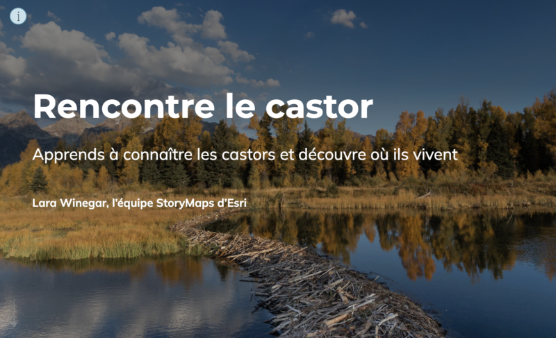

Recently, ArcGIS StoryMaps team members met with colleagues from Esri Canada’s Education team to discuss using ArcGIS StoryMaps in K-12 classrooms. During our chat, our colleagues told us they enjoyed our accessible story about beavers – a popular topic in Canada. But teachers in Québec weren’t using it because it wasn’t available in French.
Our teams value accessibility and providing comparable access to information for everyone, which includes languages. We started brainstorming solutions, including using a professional translation service, but we had concerns about costs and localizing the story for a French-Canadian audience. Then we learned their team member, Arabelle Sauvé, is fluent in both French and English. So, we asked, “Can we work together to make the story accessible in French?” Now we’re sharing what we learned about doing an intricate translation involving both accessibility and localization considerations for existing stories. Hint – a collaboration partner is key for success.

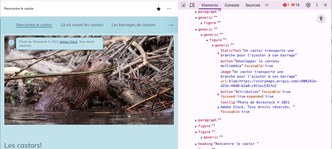

Image captions also support understanding content; however, authors need to add alternative text, also called alt text, which provides written descriptions of media, to make media fully accessible. Alt text is used for assistive devices like screen readers and appears if the media fails to load. Authors can easily add alt text for media and maps within the ArcGIS StoryMaps builder. They can also upload closed captions, VTT files for videos, transcripts, or captions in the native video player to support multiple languages.
Authors need to translate alt text and transcripts just as they do their story text. It’s worth noting that we used a hybrid translation solution on this project and outsourced alt text to a professional translation service. It’s a good option when you need to balance time and translation resources.

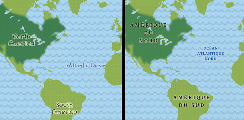

Map data
For our map visuals, we used data from a United States government agency for the original story because it didn’t require permission to use. However, the data wasn’t ideal, since it didn’t include Alaska and stopped abruptly at the United States border. We looked for other data sources and ensured we could obtain permission to use it to before translating and localizing the story. Localization can include swapping media, maps, and other elements of your story so it’s relevant to a specific audience. In this case, we needed to expand the data set to include Canada at minimum. In general, expanding the data to a wider area expands your potential audience because people are more likely to be interested in information they relate to or that affects them.
We found and received permission to use international datasets from IUCN. We added the North American beaver and also included data on the Eurasian beaver since French is also spoken in other parts of the world. While we recognize there might be slight regional language variations, it was still a worthwhile addition and expanded our audience outside of Canada.

Finally, a special perk from our collaboration was Arabelle’s schoolteacher family member who provided insight into the local educational standards related to the story content. See the item description pages for the educational standards for both stories.
Challenges
As mentioned, retrofitting translations for existing content can be challenging. Our team has adjusted our workflow, and we now assess translation potential and include accessibility considerations during the planning stages of a new story.
We also recommend choosing a basemap that supports changing language labels. Among the choices we made that, in retrospect, were not ideal, was using a custom basemap. We chose it because it’s accessible for kids, and honestly, it looks cool. However, changing the labels on that map to French is best described as an inelegant, “hacktastic” undertaking that I wouldn’t try to reproduce, even if I could.
Thank you
Finally, thank you again Esri Canada for collaborating with us on a challenging project; the French version of the story would not have been the same without your help and support. Also, the English version is now richer with the added international data set.
