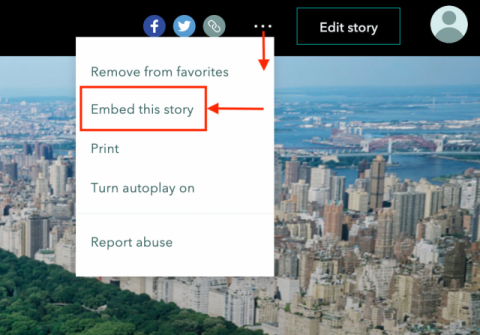

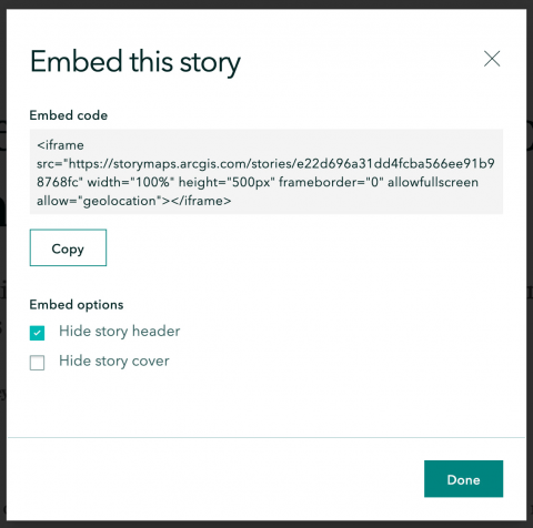

By far the easiest way to embed a story or collection into a different website is by utilizing the aforementioned iframe code. You can find it in the header menu (the three dots) at the top of any story or collection. If the story or collection is published publicly and its social sharing functions are not hidden (which is true of the vast majority of public stories/collections), you will see Embed this story as the second item from the top. Click that to reveal the iframe code, along with a big button to immediately copy the code to your clipboard.
Screenshot of the unfurled header menu in ArcGIS StoryMaps, with the option to "embed this story" highlighted.

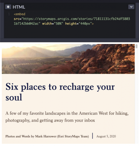

Bear in mind that some platforms disallow iframe code (though it’s not super common); in these cases, embedding may still be possible using embed HTML tags instead, where permitted. The screenshot below shows how an embed can be manually enacted using rudimentary HTML.
Screenshot of an HTML editor using embed code to embed a story from ArcGIS StoryMaps

The iframe code generated by ArcGIS StoryMaps already has height and width parameters set by default: width at 100% (of the allotted space for an iframe element on the destination page) and height at 500 pixels. One advantage to embedding via iframe or embed HTML is that you can manually change these parameters within the code to make the resulting embed look its best.

You may have noticed in the modal where you get the iframe code that there are two checkboxes: one to hide the story header (already automatically checked off), and one to hide the story cover. The header is the bar at the very top of the page that follows you as you scroll down and contains the story title, logo (if added), sharing options, and menu. The cover is the very first part of every story, featuring the title, subtitle, author byline and date published, and usually a photo or video.
Whether the header and/or cover are visible in an embedded story can also be manipulated with manual HTML or URL-only embeds by tacking on parameters to the URL. Adding ?header=true&cover=false to the URL, for example, will show the header (since the default for any embedded story is to hide it) but hide the cover.

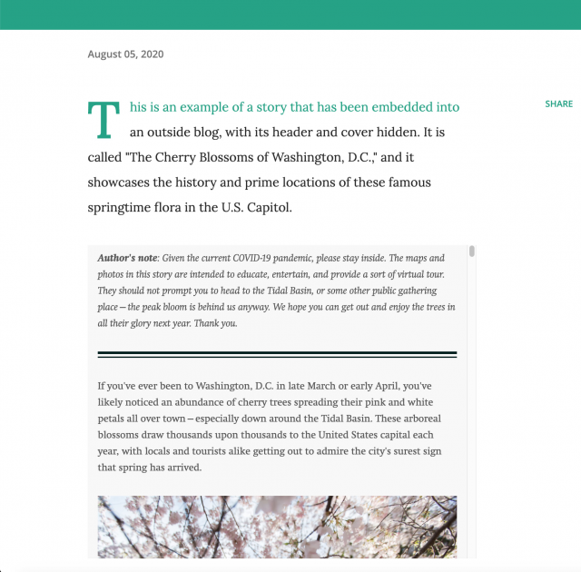

For instance, say I wanted to embed this story about D.C. cherry blossoms onto a Blogger page and write a brief introduction of my own for the ensuing content. That would make displaying the header and cover redundant and repetitive, so it would be prudent in that case to hide them both. The screenshot below shows the result.
Screenshot of the story "The Cherry Blossoms of Washington, D.C." embedded into Blogger with its header and cover hidden because I've written an introduction within the blog that would make the header and cover repetitive

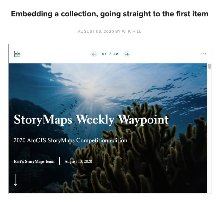

When embedding a whole collection, you might want to skip over the collection’s contents and go straight to the first item within. To effect that, simply add the parameter ?item=1 to the end of the URL that’s being embedded.
Screenshot of a collection embedded in Squarespace that has its contents page skipped and is starting on the first item in the collection instead
You’ll see in the screenshot above how a collection can be embedded without its contents showing. Notice that the collection header is still visible, with the navigation to take readers through the items within it and the button to jump out to the contents at any time.
I’ve also changed the frameborder parameter in the iframe code to “1” instead of “0” so that there is now a gray border around the embed to help distinguish it from the white background of the destination page.
