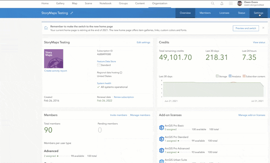

If your organization is not part of Esri User Experience Improvement program (EUEI) you will receive a notice saying “Analytics is not available…” You must enroll in the program to be able to use analytics in your account. Your ArcGIS administrator will be able to enable this for you by opting into the Esri User Experience Improvement program. This is a protection for organization accounts to have more control over how data is collected using Esri tools.
If you are an ArcGIS organization administrator, this is how you join the EUEI program. Log in to your ArcGIS organization account and click Settings. In the general table, there’s an option called Esri User Experience Improvement program. You need to enable this option to be able to use analytics in your story. Once you allow this, your ArcGIS StoryMaps authors can enable analytics to their stories. For more information about this requirement, see Add Analytics to a Story in the ArcGIS StoryMaps documentation.
