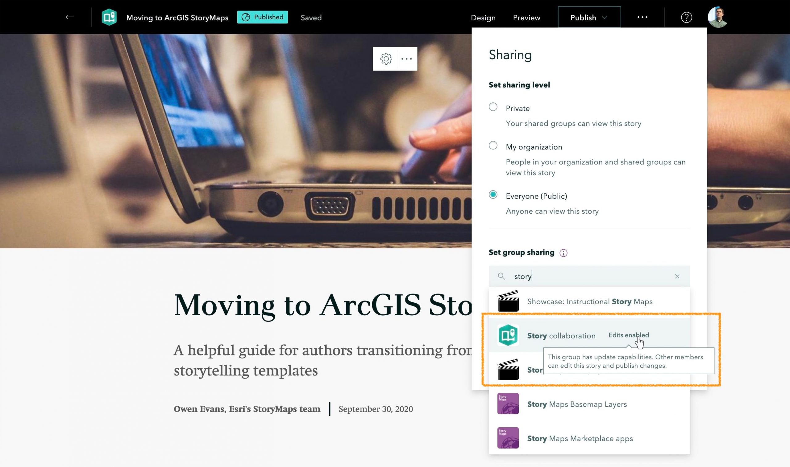

Publish to shared update groups
In ArcGIS, shared update groups (which are also known as groups with update capabilities) are the way to grant others permission to edit your content.
You can now share published stories and collections to shared update groups from within the ArcGIS StoryMaps builders. Shared update groups, which were previously disabled in the publishing panel, are now enabled and marked with an Edits enabled label.
Publishing a story to a shared update group
After you share a story to a shared update group, the other members of that group become co-authors since you have granted them permission to edit your story. Co-authors can edit the stories, collections, and other items that have been shared to a group.

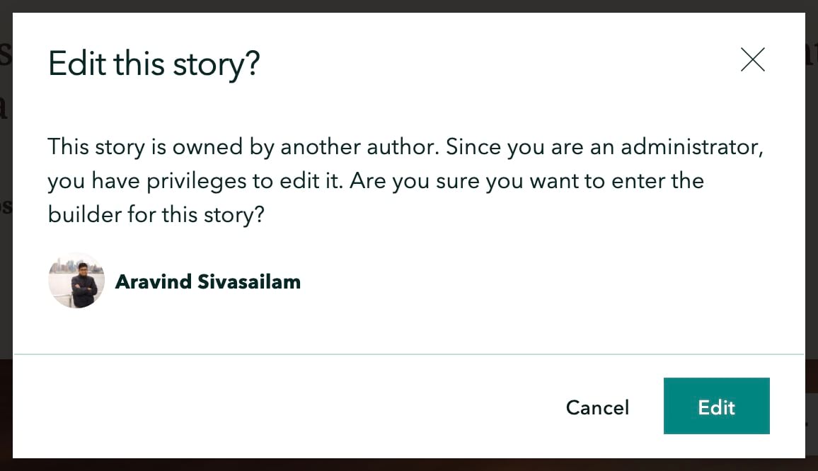

Warnings for admins
Administrators in an organization have additional permissions that let them edit and update other people’s content. This often comes in handy, but it can sometimes create confusion or lead to unexpected results if these elevated permissions are used incorrectly or without someone else’s knowledge.
When admins edit or publish a story owned by someone else, a warning message will now appear to remind them they are working with someone else’s content.
Warnings for admin editing someone else's item

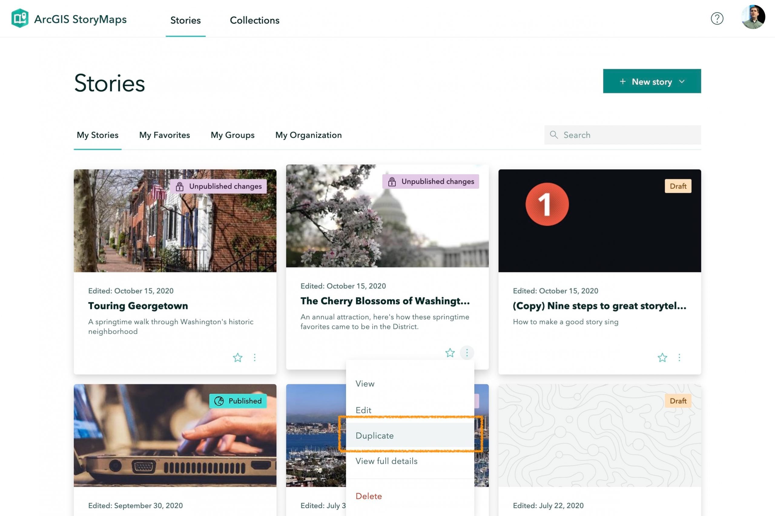

Another way to duplicate
Stories and collections can now be duplicated from their cards. This provides a shortcut for creating a copies of your content items since you no longer have to open up the builder to access the duplicate option.
New duplicate option on item cards
