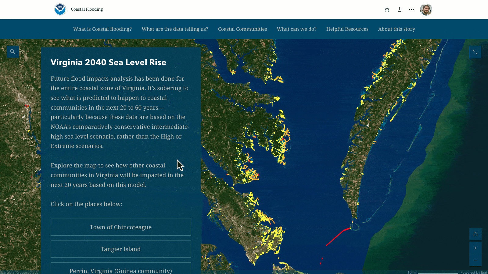

The story Coastal Flooding uses media actions to help guide readers through a map sea level rise projections in coastal Virginia. By presenting a list of communities in a series of media action buttons that zoom to each community when activated, the story gives readers some idea of where to start when exploring this data.
A looping screen recording demonstrating the use of map actions in the Coastal Flooding story, with each action zooming the map to a particular town or area.
Media actions in this slide from the Coastal Flooding story allow the reader to zoom to different areas of interest on the sea level rise projection map.

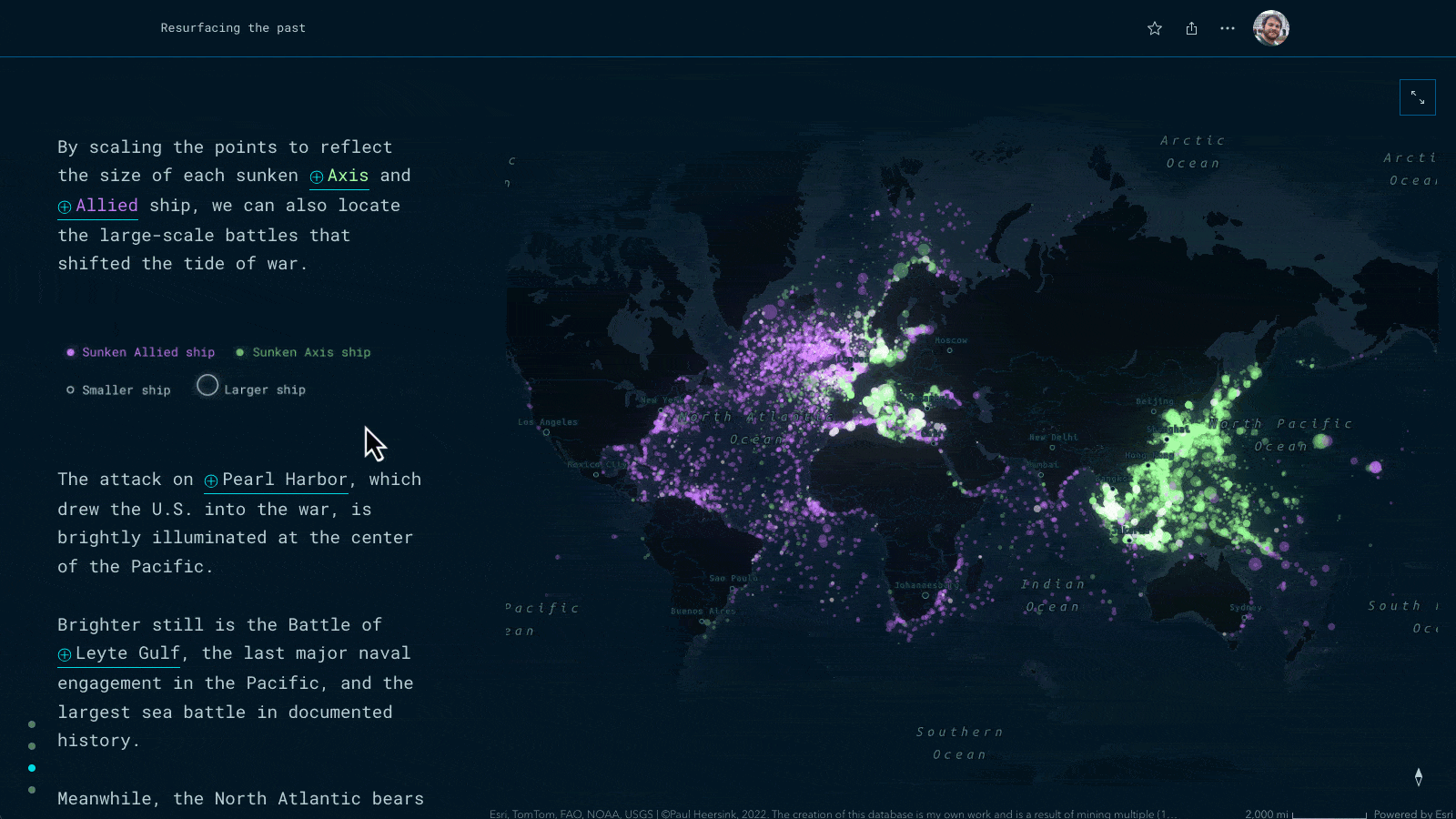

In the story Resurfacing the past, readers are introduced to a database of every ship that was sunk around the world during World War II. Containing roughly 15,000 vessels, the map of that data can be daunting to dive into. To help make the data easier to parse, media actions offer a few different cross-sections of the data, such where Axis and Allied forces each suffered the most losses, or the distinction between armed warships and non-combat ships.
A looping screen recording demonstrating how media actions are used in the story Resurfacing the past, to offer cross-sectional views of a large dataset.
These link-style actions in Resurfacing the past offer cross-sectional views of the large set of sunken ship data.

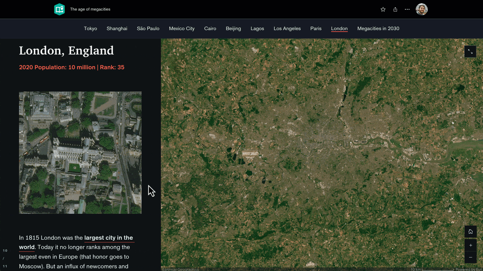

The age of megacities uses this technique to demonstrate how the urban footprint of various metropoles has expanded over the course of a century. For each city, a group of media action buttons reveals the city’s extent at several different points in time.
A looping screen recording demonstrating how media actions are used in the story Age of megacities to depict the urban growth of various metro areas over time
Media actions are used in The age of megacities to offer a reader-driven "time-lapse" effect.

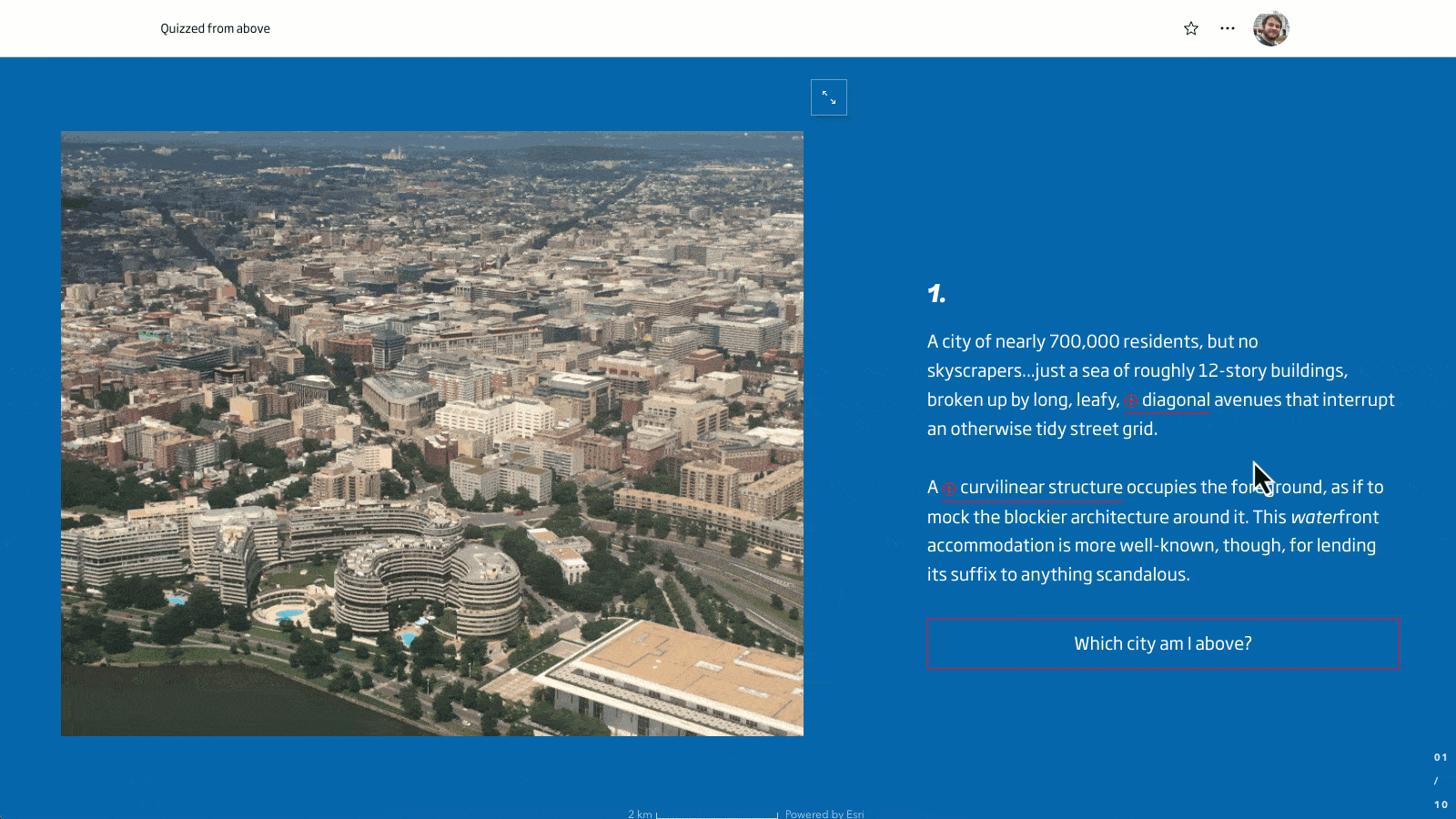

In the story Quizzed from above, readers are guided through a sequence of aerial imagery (as media layers in a web map) and given hints (through text link-style media actions) about where that imagery is. A final media action button swaps in a static image of an annotated map that reveals the answer.
A looping screen recording demonstrating how the story Quizzed from above uses media actions to reveal clues about an image and a final answer image.
Quizzed from above uses link-style media actions to focus on hints about an aerial image and then a final button-style media action to reveal the answer.

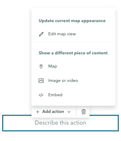

For a button-style action, open the block palette within the narrative panel and select Media action (symbolized by a little lightning bolt). An empty button will appear and prompt you to “Describe this action”; enter a brief summary of what readers can expect to happen when they activate that action. Then, hover over the action and you’ll see +Add action appear. When clicked, it will reveal a drop-down menu.
A screenshot of the add action menu for a button-style media action in ArcGIS StoryMaps.
This is what you'll see when configuring a button-style media action.
If the media panel contains a web map, express map, or web scene, the first item in the menu will be to Edit map view. Selecting that opens the map designer, which is where you would alter the map by changing the zoom and extent, layer visibility, and/or selecting a particular feature to reveal its pop-up. When it’s the way you want readers to see it when they activate that action, hit Save in the lower right-hand corner.
Below Edit map view in the Add action menu are the three options for swapping the initial media out: It can be replaced with a map, image, video, or embed. Selecting Map will open up your map library (the same as when you add a map to a story); Image or video will bring up the media upload modal; and Embed will prompt you for a web URL or iframe code.
Once you’ve configured your media action, hovering over it again in the builder will reveal a View/Reset button that allows you to test out how the media action will work in the live story, an Unlink button removes the configured action without deleting the button, and a trash can icon to deletes the button entirely.
