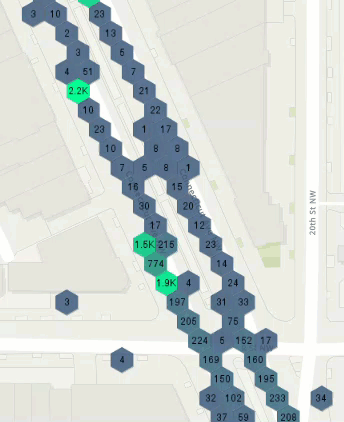

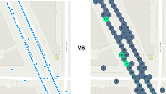

The Velocity feature layer on the left visualizes each individual record as a point on the map. The Velocity map image layer on the right illustrates dynamic aggregation, symbolizing and labeling feature counts within each bin, allowing viewers to quickly understand spatial distribution trends.
On the left is the Velocity feature layer added to ArcGIS Pro. You can zoom and pan around to render features and click an individual record to view its attribute values. On the right, you can see the Velocity map image layer that utilizes dynamic aggregation. We are symbolizing and labeling the count of features within each bin. This allows viewers to quickly understand the trends surrounding the spatial distribution of features. As the data changes in real-time, the dynamic aggregation will automatically update with these changes.
Not only can you view the aggregated features, but when you zoom in past your defined feature threshold, the map client intelligently switches to rendering discrete features. This enables viewers to see the entire picture of their data with dynamic aggregation, while also being able to drill down to individual features for a more detailed understanding.
This GIF illustrates a map displaying aggregated data. As the user zooms in, the map automatically updates to reflect new bins. Once the user zooms in beyond a certain threshold, the individual point locations become visible.
As the user zooms in, the map automatically updates to reflect new bins. Once the user zooms in beyond a user-defined threshold, the individual point locations become visible.

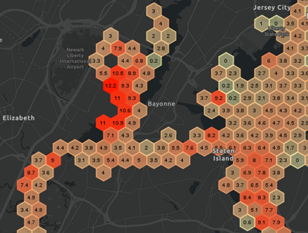

Map showing pointed hexagon aggregation of marine Automatic Identification System (AIS) data represents the average draught statistic for vessels.
A pointed hexagon aggregation of marine Automatic Identification System (AIS) data represents the average draught statistic for vessels.

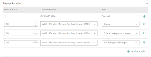

When configuring a new feature layer output in your Velocity analytic, you will see settings for aggregation styles. You can accept the defaults or use custom configurations for additional styles. In the example below, we added the flat hexagon or triangle aggregation styles to complement the default configurations. For instance, flat hexagons are useful for representing density and patterns in data, while triangles can provide a different perspective on relationships and distributions.
Image of the Aggregation window in Velocity, where users can specifcy custom aggregation configuration.
The Aggregation styles window in Velocity enables easy configuration of custom aggregation configuration styles.

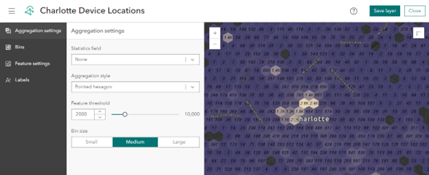

By clicking the edit button for the map image layer, this will open the Velocity interface to control aggregation settings. From this wizard, you can see four tabs on the left that enable editing of aggregation settings, bins, feature settings, and labels.
Image of Velocity showing the aggregation settings, giving users the ability to tailor the visualization to best fit their data with options to adjust the statistics field, aggregation style, feature threshold, and bin size.
In Velocity, use the aggregation settings to tailor the visualization to best fit your data by adjusting the statistics field, aggregation style, feature threshold, and bin size.
  • Aggregation settings
    • Decide whether to render just feature count within each bin, or to select a statistics field and type to represent
    • Choose the aggregation style (bin shape) to render
    • Adjust your feature threshold. The default is 2000 which means if there are fewer than 2000 features within the map extend, individual features will be rendered in place of binning. This is so that users can zoom in and understand individual feature details.
    • Choose your bin size
