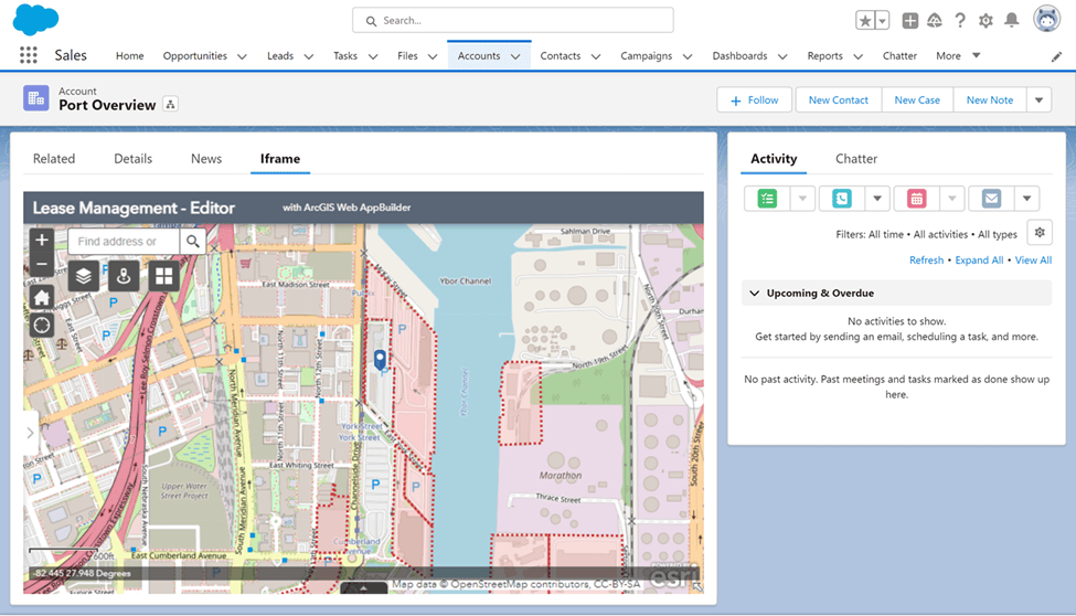

Embed your ArcGIS applications in Salesforce
The easiest way to integrate your existing ArcGIS content to Salesforce is to directly embed it on a Salesforce page. Directly embedding applications into Salesforce eliminates an “extra step” for Salesforce users. Embedding an existing application also delivers immediate value with minimal effort from your Salesforce and ArcGIS teams.
A common requirement when embedding ArcGIS applications in Salesforce is for the embedded application to be “responsive”. Many ArcGIS applications like Dashboards, Experience Builder, and Instant Apps support URL parameters that make this possible by controlling the behavior of your application when it loads. URL parameters can set filters, change the center or zoom level of the map, add markers, and modify layer visibility.
And with a some effort, you can append information from a Salesforce record to an ArcGIS app’s URL when a page loads. This data can be categorical data, location information, and other record details from Salesforce. By adding this data as URL parameters, your application will open up zoomed to the right location with the right data displayed. In the example below, a lease manager can view available space on a map, run reports, and make changes to features using a configurable ArcGIS application embedded into Salesforce. When a record is opened, the map zooms to the record’s address, adding a marker at the geocoded location.
an ArcGIS configurable app is embedded directly in to a salesforce page

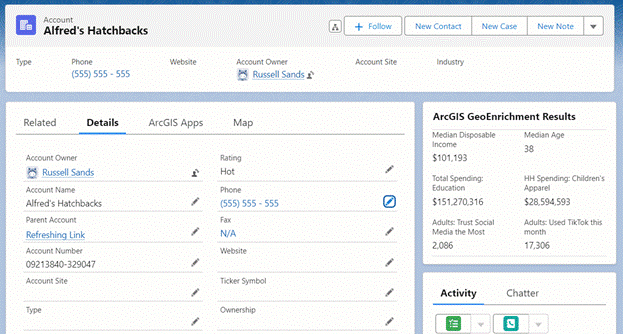

Develop Lightning Web Components in Salesforce
When you need to deliver ArcGIS content and services to Salesforce users and embedded ArcGIS applications or Salesforce Maps do not meet your needs, consider developing a Lightning Web Component (LWC). LWCs allow developers to build reusable Salesforce components using a lightweight framework and a component library for building components that look and feel “like Salesforce”.
With LWCs, developers canto spatially enable Salesforce pages by directly interacting with ArcGIS content and services through ArcGIS REST APIs. For developers who are new to ArcGIS, ArcGIS REST JS can reduce the effort required to build these interactions.
In the screenshot below, an LWC adds hyper-local demographic and market data to a Salesforce account page by calling the ArcGIS GeoEnrichment Service from ArcGIS Location Platform. When the page loads, the LWC sends the account’s location to the ArcGIS GeoEnrichment Service and receives enriched data in return. The LWC displays this data in a table that looks “just like Salesforce” the end-user.
a salesforce lightning web component displays data from the geo enrichment service on a salesforce account page

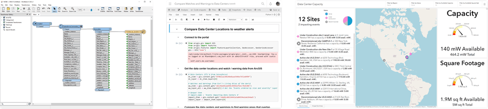

Extract, transform, and load (ETL) data
Many integrations between Salesforce and ArcGIS are all about data. Whether you need to integrate data on a scheduled basis or in real time there are several software and developer options which make defining your ETL workflow easy.
Software solutions like the ArcGIS Data Interoperability extension allow for defining and scheduling ETL workflows. In Microsoft’s Power Automate the ArcGIS and Salesforce connectors allow you to define flows that can keep changing data in sync.
For developers there are even more options. The ArcGIS API for Python allows you to work with Salesforce REST APIs to author notebooks that ETL data. These notebooks can then be run ad hoc, on a schedule, or shared to users as web tools. For event driven ETL of data, developers can use Webhooks in ArcGIS, and Apex triggers in Salesforce.
Be on the lookout for opportunities to create virtuous cycles where data can flow in both directions. For example, an insurance company may initially ETL customer data from Salesforce to ArcGIS to perform real-time analytics. This may involve identifying the cars, homes, and businesses are in the path of weather events. The impacts can then be summarized in an ArcGIS Dashboards or ArcGIS Experience builder application. The insurance company can also ETL potentially impacted customers IDs back to Salesforce. This information can then be used to generate targeted outreach campaigns with information on risk mitigation and how to file a claim if a loss occurs.
a diagram shows how the data interoperability extension and a python notebook power a dashboard
