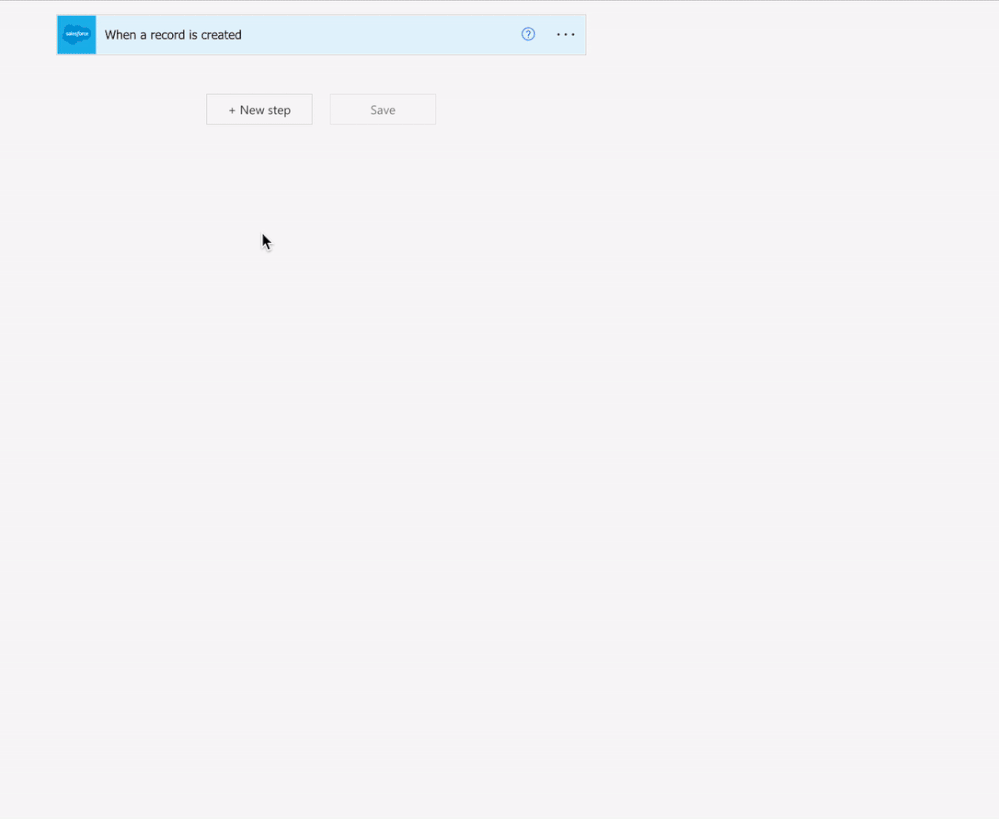

In Power Automate, the first step is to create a new ‘Automated cloud flow‘ using the Salesforce connector. The Salesforce connector enables you to trigger a Flow in Power Automate when new records are added, or when existing ones are updated in Salesforce. By selecting the ‘When a record is created’ trigger, the Power Automate Flow listens for new records created in Salesforce. When a new record is added, the Flow starts automatically and performs the other actions in the Flow.
A looping screen capture of a user creating a new Flow in Power Automate using the Salesforce ConnectorCreating a new automated cloud Flow in Power Automate

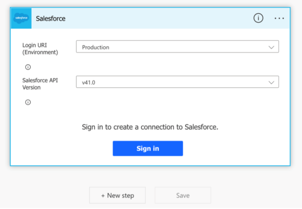

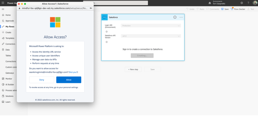

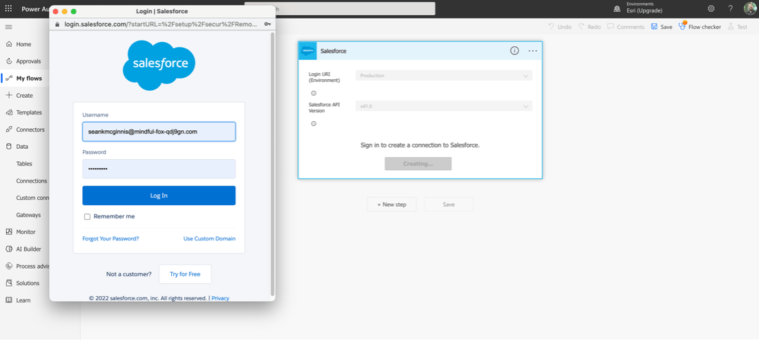

If this is your first time creating a connection to Salesforce, you will be prompted to log in and allow Power Automate access to your Salesforce organization.
A screenshot showing the Salesforce connector set to log in to the Production environment using v41.0 of the Salesforce API
A screenshot of Power Automate showing the log in window for Salesforce
A screenshot showing Salesforce asking the user to allow or deny Power Automate to Access Salesforce
Note: Depending on your organization’s Salesforce security policies, you may need to work with your Salesforce Administrator to get the appropriate privileges to connect with an external application.

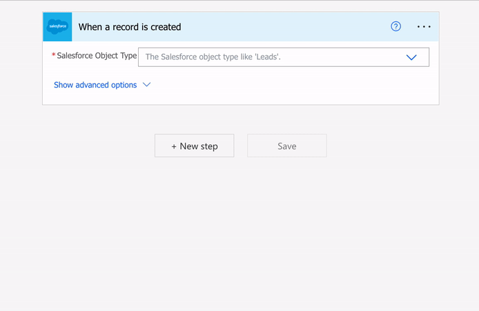

Now that you have established the connection between Power Automate and Salesforce, select the Salesforce object you want to geocode from the dropdown list. In this example we will be selecting the Accounts object.
A looping screen recording
Selecting the Account object in the Salesforce ‘When a record is created’ trigger

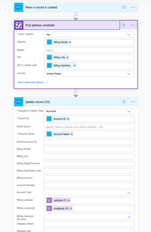

To use the ArcGIS World Geocoder, add a new step to your Flow and search for the ArcGIS Connector for Power Automate’s ‘Find address candidate’ action. For ‘Address’ and other location information, select the corresponding dynamic content representing your Salesforce object. Each time the Flow is triggered, the ‘Find address candidate’ action sends the address information from the newly created record to the ArcGIS World Geocoding service and obtains the latitude and longitude coordinates.
Using the Salesforce record’s fields to populate the ‘Find address candidate’ action with location information
In the same way that the fields associated with the Account became dynamic content, you can now use the results from the ArcGIS World Geocoding service as dynamic content in downstream actions. With this dynamic content, the Flow can update the new Account record’s Billing Latitude and Billing Longitude fields with the latitude and longitude values returned by the  ‘Find address candidate’ action.
To complete this Flow, add a new step and search for ‘Salesforce’, then select the Salesforce ‘Update record (v3)’ action. Select the Object Type you want to update, and populate your fields with your dynamic content. The example below shows how to use ‘Update Record (v3)’ to update the Billing Longitude and Billing Latitude for the new Account record.
Updating the Salesforce record with the latitude and longitude information returned from the geocoder
And that’s it! In three steps, you have created a Power Automate Flow which provides a single source of truth for geocoding in your CRM and GIS, without writing a single line of code!
