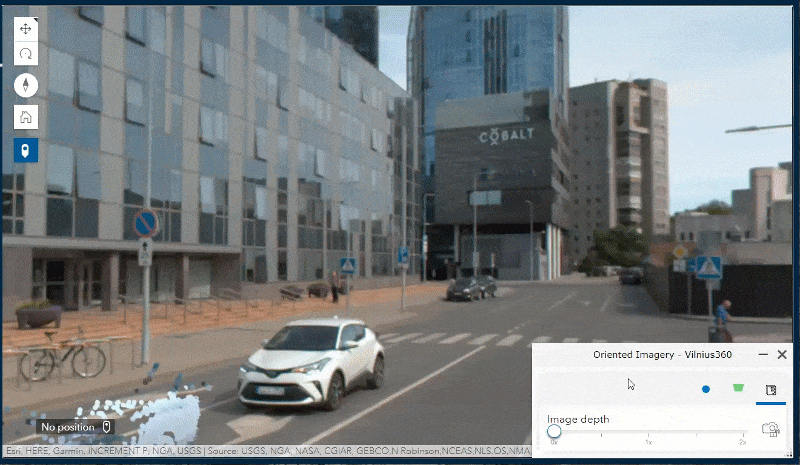

Screenshot of oriented imagery 2.6 example app

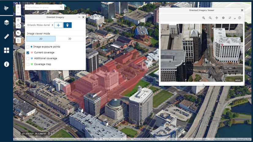

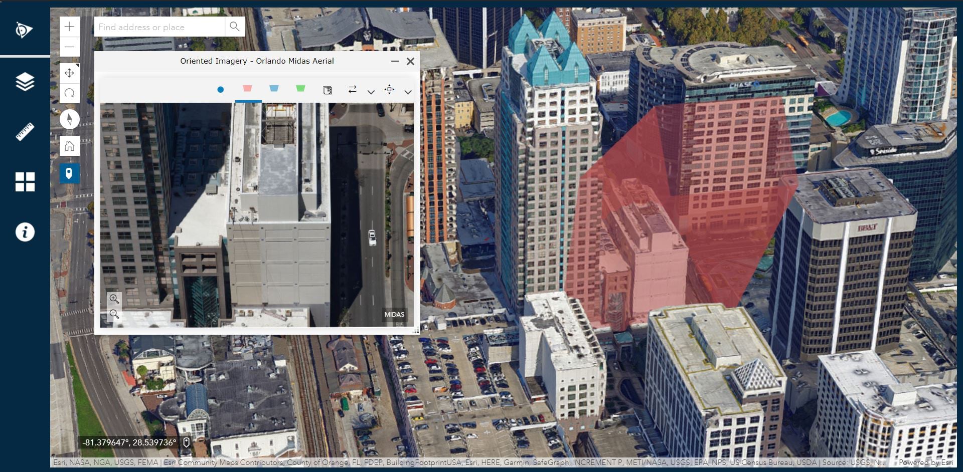

Use superimpose view to visualize imagery in 3D web scenes
With the new 3D viewing experience on the web, you can superimpose imagery into web scenes on top of both vector layers and 3D data layers (including point cloud, mesh, and building layers). You can adjust the position of the image superimposed in the scene using the image depth slider in the viewer (see it in action below). You can also measure and digitize in web scenes using imagery as the reference. Just FYI, superimpose view is available only on the web platform, and videos are currently not supported.
Example app demonstrating Superimpose view capability

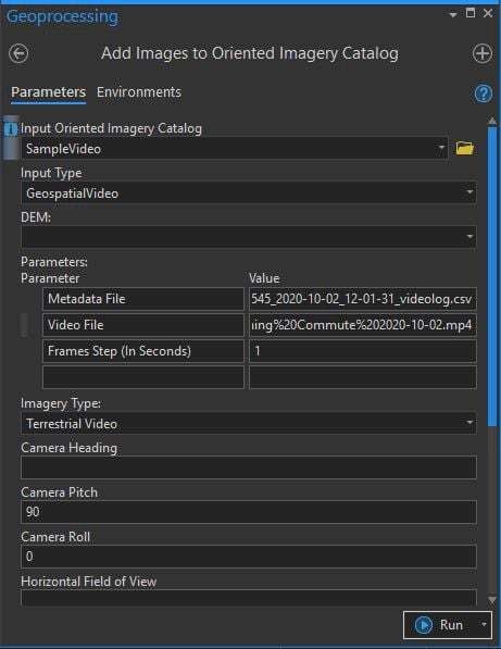

Easily create OICs with video (plus support for 360 videos)
With the new Geospatial Video image type, you can now easily create oriented imagery catalogs (OIC) from video files that are accompanied by geospatial log files. Once the catalog has been created, you can visualize the video in the Oriented Imagery viewer on the web. (Video is currently not supported in ArcGIS Pro add-in.)
Screenshot of Geospatial video image type

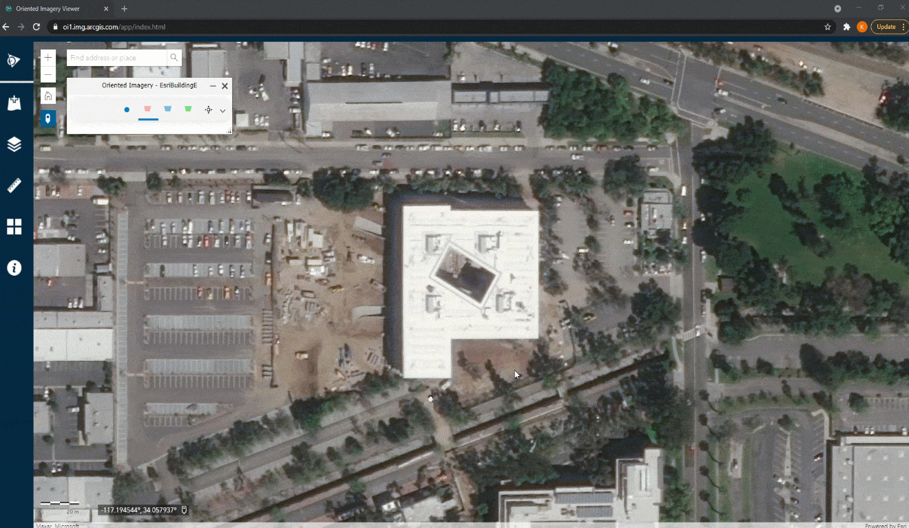

Time Selector tool
Use the Time Selector tool to compare images containing the selected point of interest taken at different times. You can switch between images taken days, weeks, months, or years apart from each other. This tool comes in handy when you want to compare before and after images for a property damaged after a natural disaster, like a fire or hurricane, or you want to monitor the progress being made at a construction site.
GIF of Time Selector tool

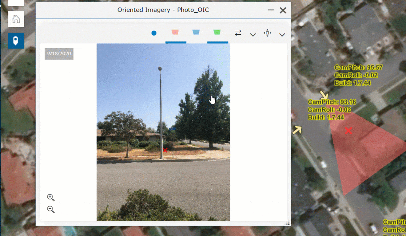

Image Attributes tool
You can view the attributes for the current image using image attributes tool in the Oriented Imagery viewer . Note – Default oriented imagery attributes are not shown.

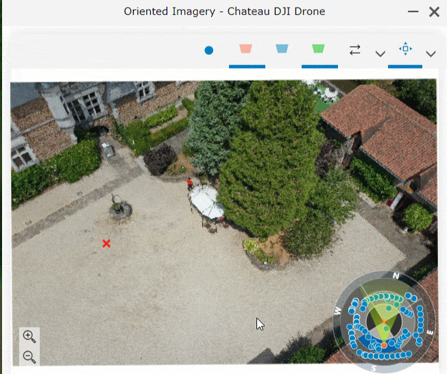

Adjust the size of the Navigation tool
You can now increase the size of navigation tool in the Oriented Imagery viewer by clicking on the outermost ring segment.
