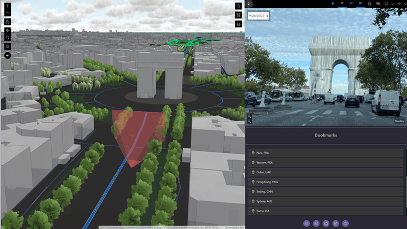

Bonus sneak peek—Mapillary imagery coming soon!
Mapillary has an open database of more than 1.5 billion images from around the world, and pretty soon you’ll be able to use the Oriented Imagery widget for Experience Builder to add them to your web apps!
Screenshot of the Mapillary OIC in the Oriented Imagery Experience Builder widget
Watch for a new Mapillary OIC that anyone can use—create an Experience Builder app, add the Oriented Imagery widget, and load it up with the Mapillary OIC. You’ll be able to click on a point in your app’s map to explore street-level images of that location taken by cell phones, action cameras, and 360 cameras.
